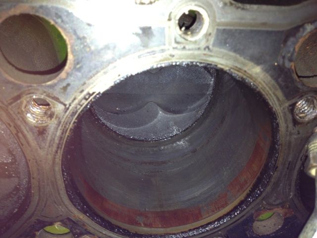

I took photos. for you to get an idea of what you see. let me know what you think. I ran my finger up and down the walls. its as smooth as a violin. my finger nail didnt catch on any thing either. but the slight rust. i mean u can tell when u feel it. I wish i new how it was to form on most of the cylinder walls in the same spot. would i be able to take a very light send paper and run over that. or do you got any other ideas before i go ahed and tear this block down.

JUNK ! all 8 holes are rusted and the top rings for sure are rusted as well.
that need needs to come apart & be cleaned (honed & possibly bored if the rust is deep enough)
A ball hone on a hand drill is not going to remove all that rust and the cylinder bore will be distorted, plus you will never get a good cross hatching.
That is the cheap way, the motor won't last, it needs to go on a boring / honing machine and done correctly.
Your machinist may want to over-bore .010 to .030 depends how deep the rust is.
The top rings for sure are rusted and perhaps the 2nd as well.
This is what happens when you store an engine for long time without fogging the combustion chambers with oil.
condensation forms in the combustion chamber, and without an oil film it begins to rust the cast iron cylinders.
Notice how the rust stops at the ring pack locations, because their was a film of oil acting as a barrier to the condensation, but eventually all the oil drained back down to the pan.
the high points in the engine would be subjected to condensation. damage. (valvetrain, lifters, cam)
I would not take the chance, plus you have quite a bit of carbon build up on the pistons.

Best case you clean the block & bores pistons etc. and re-use your pistons with oversized rings fresh bearings for the cam, mains, & rods. Maybe polish the crank journals.
Worse case.. you find more rust inside and other signs of distress, and this will have to dealt with accordingly.
This is why I recommend tearing it down for inspection and do what your machinist / builder recommends.

Minimally, you will need to bore, meaning new pistons and rings. (and that's half-assing it) To do this right, I would put a figure of around $1500, since from what I can gather, you are not a machinist nor an adept mechanic.(these skills are not cheap) If you own a large boat that 305 will make an awesome anchor.
Shep, unless you are trying to keep a numbers matching car because its special, I suggest you cease and desist any attempts to fix this engine and get a crate 350. Even the HO 305 was weak from the factory and you will have nearly as much invested in rebuilding it, if not more. The fact that has not been mentioned here is that all the rust is just where the rings stop at the top of the stroke on every cylinder. This means it ran with rust further down the cylinder walls, but got scraped off by the rings.You can see in this image the pitting from the rust just above the piston.
BAD.....VERY BAD.Minimally, you will need to bore, meaning new pistons and rings. (and that's half-assing it) To do this right, I would put a figure of around $1500, since from what I can gather, you are not a machinist nor an adept mechanic.(these skills are not cheap) If you own a large boat that 305 will make an awesome anchor.

Sorry if I came across like I think you are incompetent. Before I even commented in this thread I went and looked at all threads started by you to get some background on what you have been through with this vehicle and what you needed help with. I have to say it seems it has been just that, a challenge the whole way.
It just seems strange to me that all of the cylinders are rusted. At any one position in the crank rotation there are only a few that should have open valves. Some will be on a compression stroke, and others on the power stroke. The block may be able to be saved, if the pitting is not too deep to bore out. Max overbore is .060'' which gives you .030'' that you can take off of the walls. I can't say for certain from pics but that pitting looks pretty deep. This is just one of the worries that are bropught up from looking at a pic. Who knows what else is going on inside until it gets tore down?
As far as my mentioning failure, it's just a possibility. There is a huge difference between bolting on parts and delving into building an engine. I suggested a rebuilt block as sort of a "learn to crawl before you run". There are tolerances that must be strictly adhered to if you want this build to last. Not saying you can't do it, but you will need help from a machinist. As I said earlier, this is not cheap. You will have a lot of money in what will inevitably be a much weaker engine than a 350 for about the same cost.
I really do wish the best for you in this build and hope it becomes all you expect from it.

well fellas. i took the engine out today. and stripped it down. suprised to say that there was ZERO rust on the rings. they looked normal. the journals of the crank and cam looked good. the bearings had slight wear to them. and like you guys seen there is just rust that is on the top of the cylinders. Am going to bring it to the machine shop tommorow. and see what they say.
