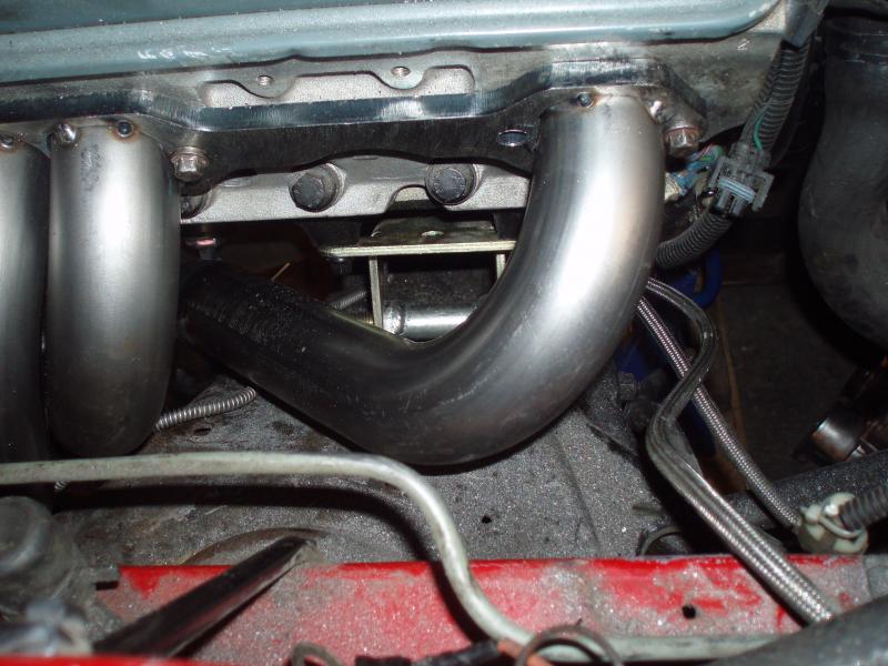

I have solid mounts.
I had to use them for my 1 7/8 headers b/c they provide more room compared to the stockers.
It's hard to tell if there is less vibration b/c I have long tubes and a single 4" exhaust

Old Jan 7, 2014 | 10:16 AM
LB9GTA's Avatar
Joined: Mar 2004
Posts: 1,643
Likes: 50
From: Manitoba
Car: '91 GTA
Engine: 421sbc
Transmission: Powerglide
Axle/Gears: Ford 9" with 3.89
Re: Solid motor mounts
