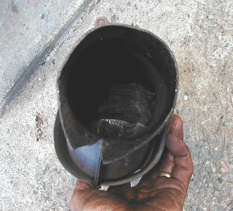

the car starts to lose power dramatically and won't allow me to go father then 2000 to 2500. but if i try to push it at all it will just not respond and its if the engine is having a fit, won't rev up, no power, car jerks,
That sure sounds like a clogged cat-converter to me. With many ( NOT ALL ) clogged cats you can bang on them with the heel of your hand and hear broken pieces of element bounce around inside.
