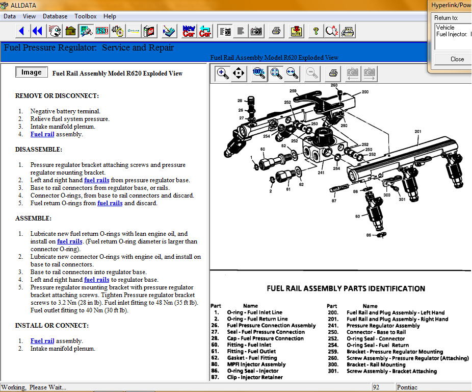

Usually you don't have to remove the fuel pressure regulator since it doesn't seem broken. You should be able to leave alone and just remove the intake and relieve fuel pressure for the most part. Also you may need lots of rags.. There's an attached picture at the bottom of this post to take a look at also!
This will be fun. This may take awhile depending on the motor.
I'm not sure of your experience with engines, but I will keep checking this thread, this will help others with the same issue.
Before you start I would recommend watching some videos. I know you probably don't want to, but Here's a few videos I believe bring out some good knowledge/tips.
The engines may be different, but the same principles still apply (wiggling, relieving fuel pressure, testing, being fragile etc.)
You can skip to 7:33 if you want to skip to the fuel rail.
Attached Thumbnails Acceleraton/power issues-fuel-injector.png

*Remove the negative battery cable.
*Then fuel pressure from the fuel test port on the fuel rail, that's how I do it, just do it slowly as not to wear the needle inside and don't forget to put a rag near the port while carefully pushing down on the needle, don't have open flames or sparks around either...
If you can't see the attachment that well, just save it to the computer and view it.
GoodLuck!
