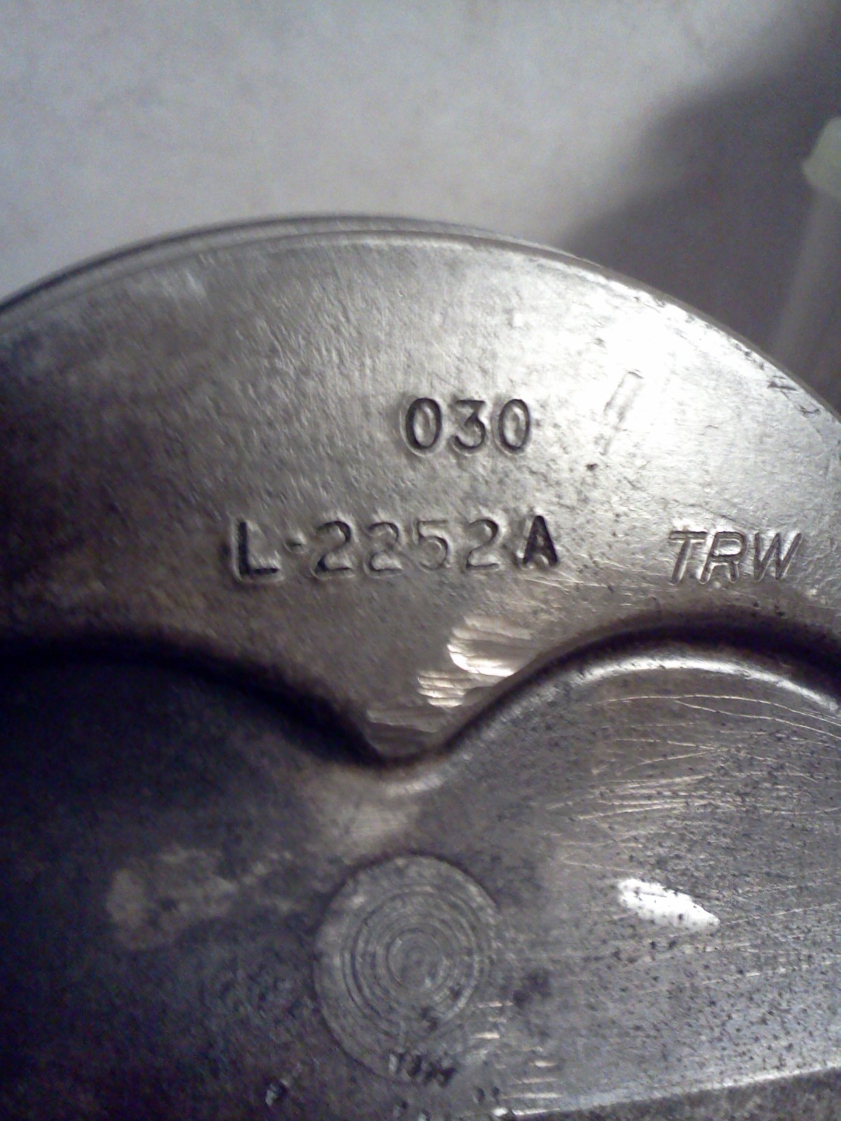

I was told with 64cc heads it'll give it a 12 to 1 compression ratio. The number on the piston is L-2252A.
Anybody know
Google works
"Also, these are not 12.5:1 pistons, CR ranges from ~10.2:1 to 11.9:1 depending on the head chamber size used and the amount of overbore."
Your true CR will be determined by the deck height as well; without knowing exactly what that is anything is a guess

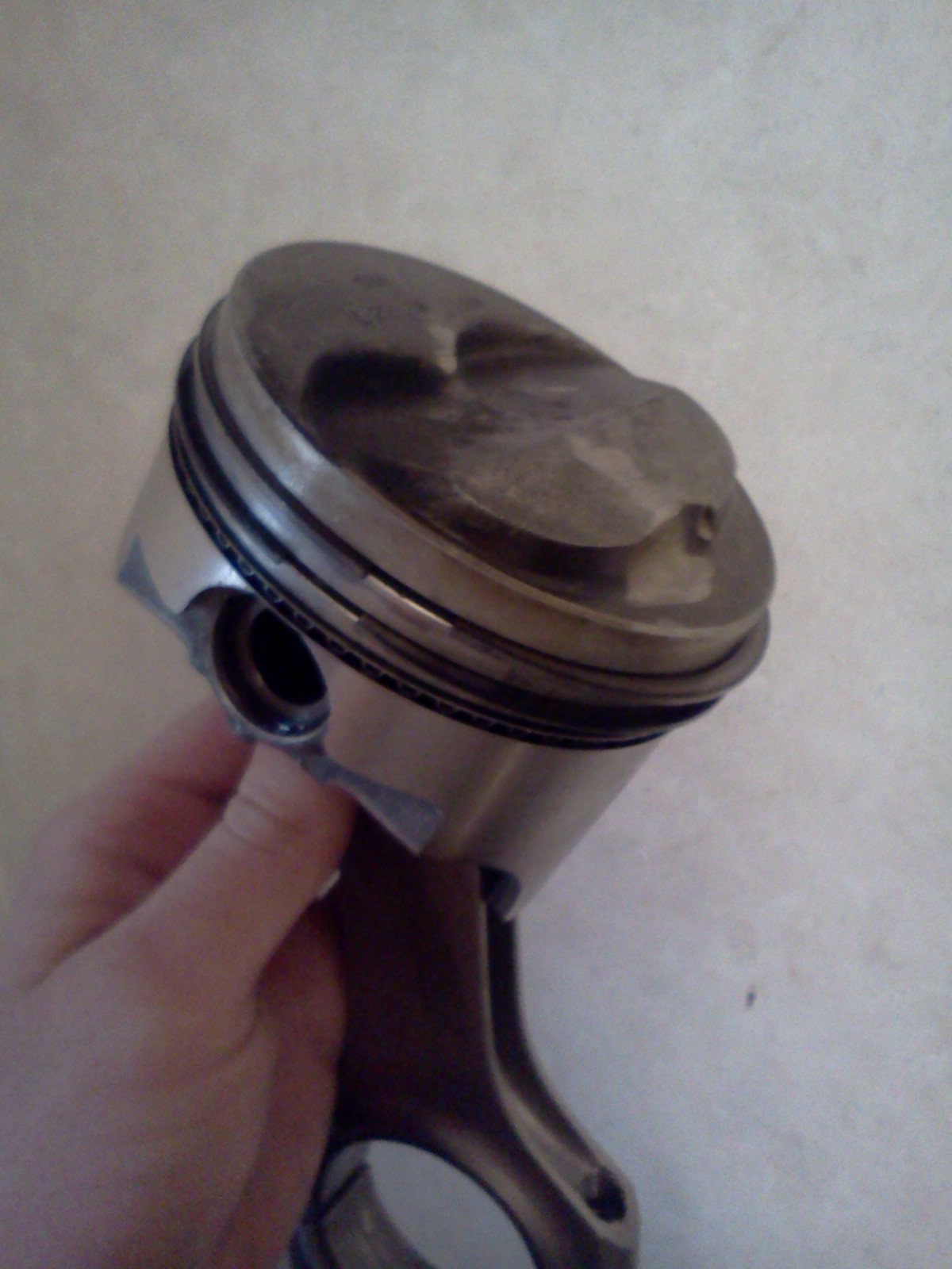

OK thanks. Tried Google but no luck with pistons. Ill try again but here is some pics if it helps any. Ill see if I can find out deck height also.

As per my comment above , they are pop up ( dome ) piston , the size of the dome varies

Put the engine at TDC and see if the flat part of the piston is level or below the block deck

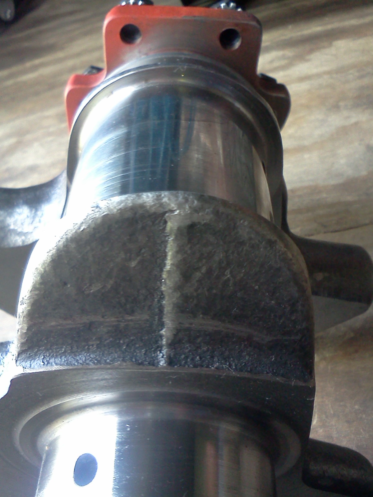

Engine is back from machine shop and decided not to build it. Has 350 pistons. 5.565 length rods, and a 400 crank. Really confused me on pistons cause I figured it was a typical 383 with 5.7 rods. Piston part#s were making no sense cause there for 350.
So instead of spending a ton of money just to detune the damn thing so I can run pump gas. I'll probably sell it. Only thing now Im not 100% sure of is the crank. It measured 3.75 at machine shop but not sure on brand and if its forged or not. Was told it was Scat forged but not looking like it from my research. Any way to find out EXACTLY what crank this is

There should be some kind of PN starmped on it somewhere probably on the front counterweight
He built the cheapest version of a 383 he could...650hp. So many bsers out there. It takes a small miracle to get that kind of power out of a 383

It's a factory cast crank if it's set up like that. SCAT doesn't make stroker cranks for the original methods of making a 383 because things have changed and technology has gotten better making that an obsolete way of building a stroker. You should see some type of obvious marking or name casting like this if they used one of SCAT's 400 cranks (which I heavily doubt based on what you've been told):
For future reference (without sounding too harsh here): this is exactly why you don't buy used motors/parts unless you know what you're looking at... and even then, exercise with caution. Whoever you bought it from lied to you and knew they were screwing you over.

its one of those oldschool slapped together builds, scat and any other aftermarket manufacturer will stamp there info on their products, u have one of those builds that you can make like a reliable 450 horsepower max with the right build, granted u get hyper pistons,arp bolts and a decent balance going on. slap some dart iron eagles with a 2000-6000 cam and run the **** out of it. all these new 383s you can spin the hell out of because the way the way those rotating assemblies are designed not gonna get the same sorta performance outta a old heavy 400 crank setup.

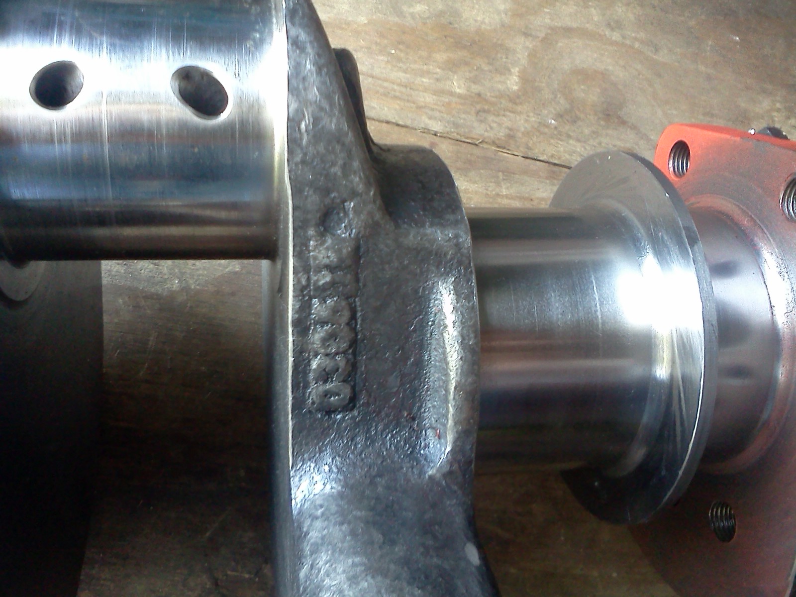

found a few #s. This one is on rear counterweight

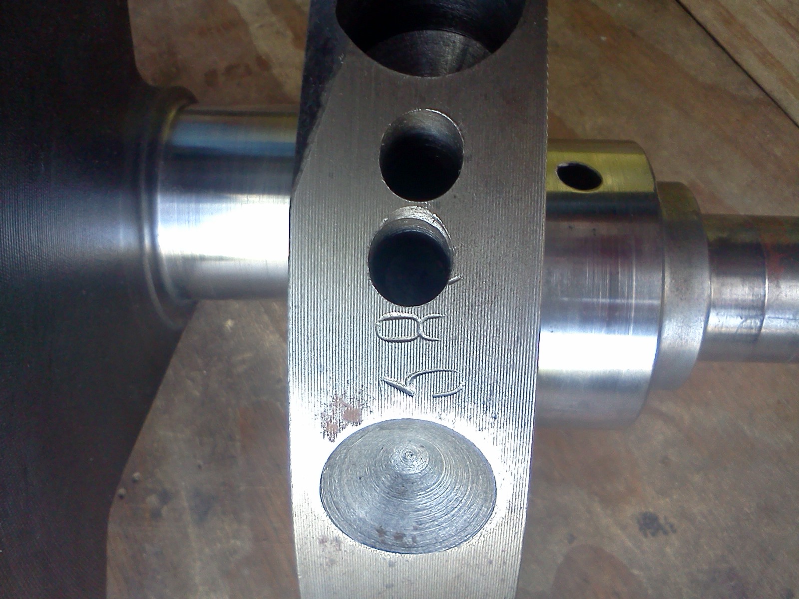

These are on front counterweight
One looks like 38?
other is M2

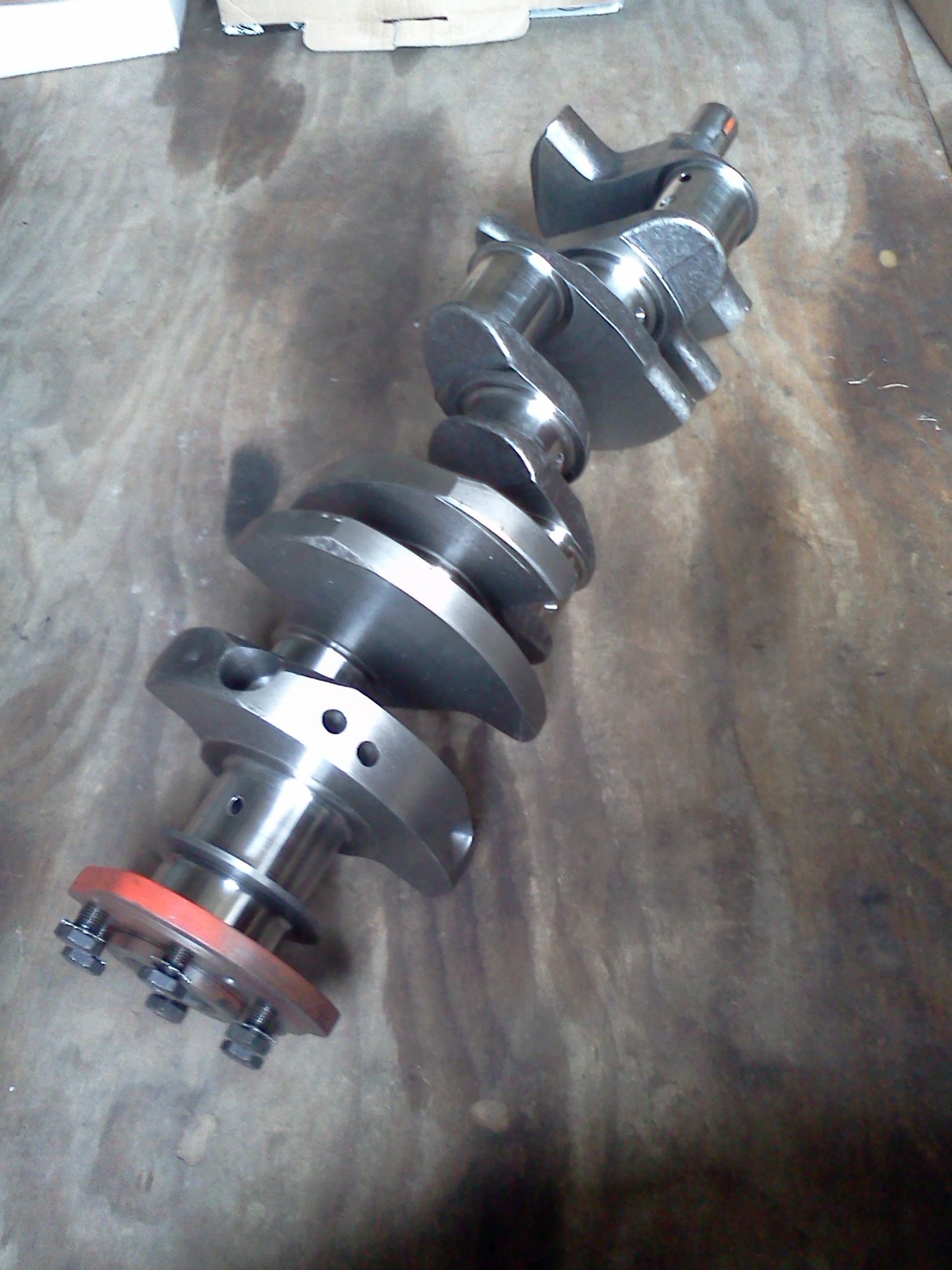

Don't know if it helps but here's a pic that hasn't been machined.

you guys think its a GM or aftermarket crank. Cast or forged.

Nearly all aftermarket manufacturers will engrave their own serial numbers and their logo onto it, so probably GM if your not finding much. GM puts serial numbers on cranks too.
