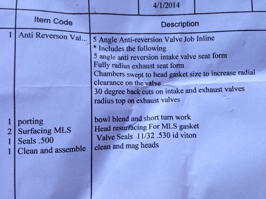

Vortec Heads Flowed with 2.02/1.60 Valves
Here are the results.
What you guys think?

Great numbers and on a 170cc intake. I am not sure what you have into them price wise but posts like this should make anyone even considering junk like procomp run for the hills. The best increase is on the exhaust side. usually the vortecs are weak on exhaust flow but it looks like that has been fixed.

@ Vincent - What did the porting cost? Who did it? And is it available to anyone?

I did the porting to the intake and exhaust, Dr. J did the valves and bowl work.
