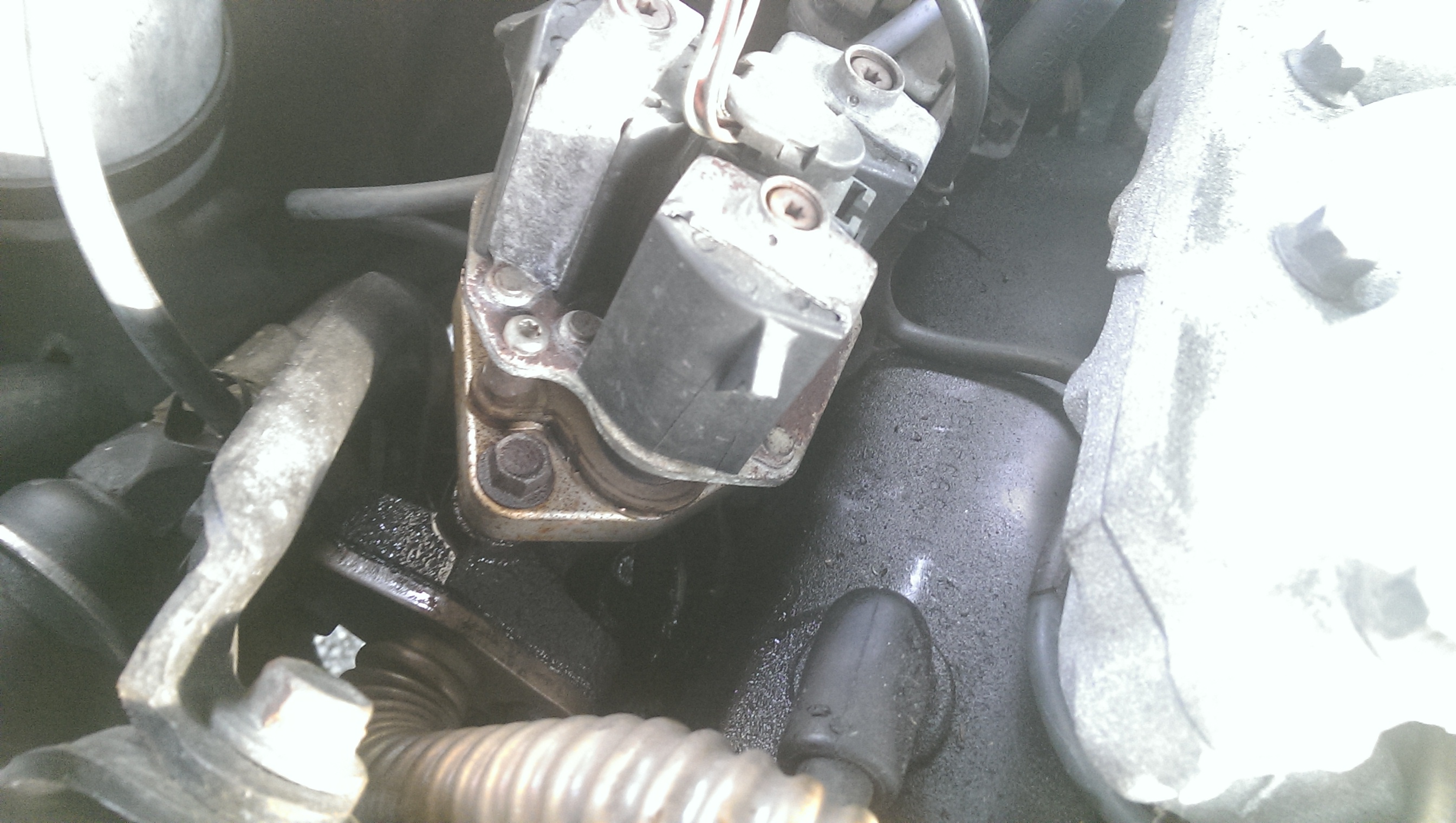

What part is this? its leaking fuel all over my engine
Just like the title says

If you have a fuel leak, that is not the culprit. That is your EGR solenoid.

If you have fuel coming from there, it's probably actually the fuel pressure regulator. (which is NOT in the pic)

Replaced the gasket. Car still won't Start. Have leaks coming from 2 different spots in exhaust(told it's common with flooding) and fuel coming out of here....which I know is not ok. Heellppp.

That part is the EGR valve. Not sure how you are getting fuel into it, however. Even if you are flooding and it doesn't start, the EGR valve is not commanded open until certain conditions are met, which include a minimum temp and RPM. My best guess is that the valve might be stuck open, not sure what else could cause this.

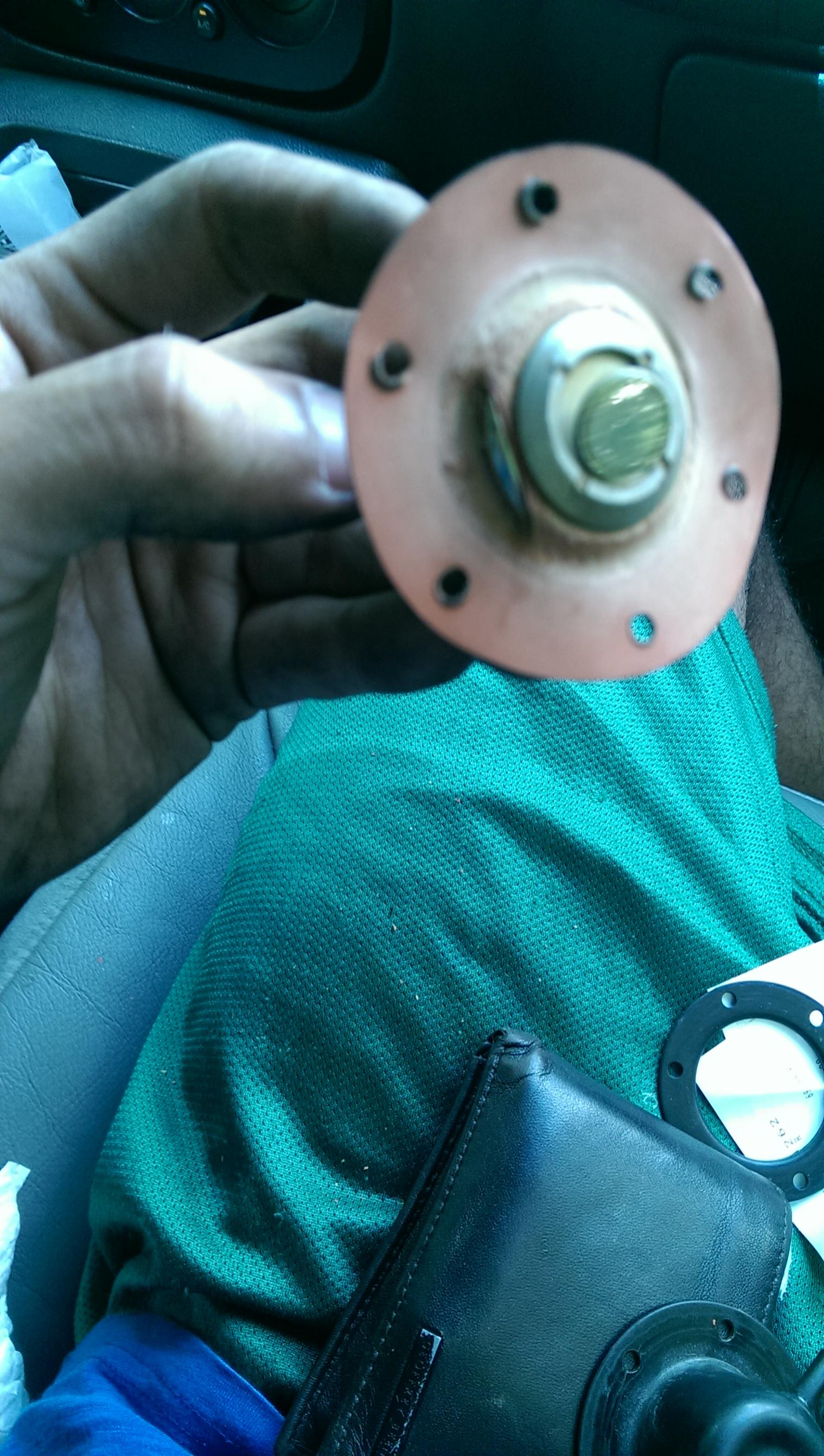

And just as the video stated. Fuel Pressure Regulator is at fault. The diaphragm of it is leaking. So as you crank the motor, the motor produces vacuum, and the gas is going into the manifold via the hose attached to it. It is the only way gas will get into the intake.
If you had an open injector problem, the cylinder would get flooded and the motor would not crank.

Hard to see but there's a crack in it. Also was covered in fuel

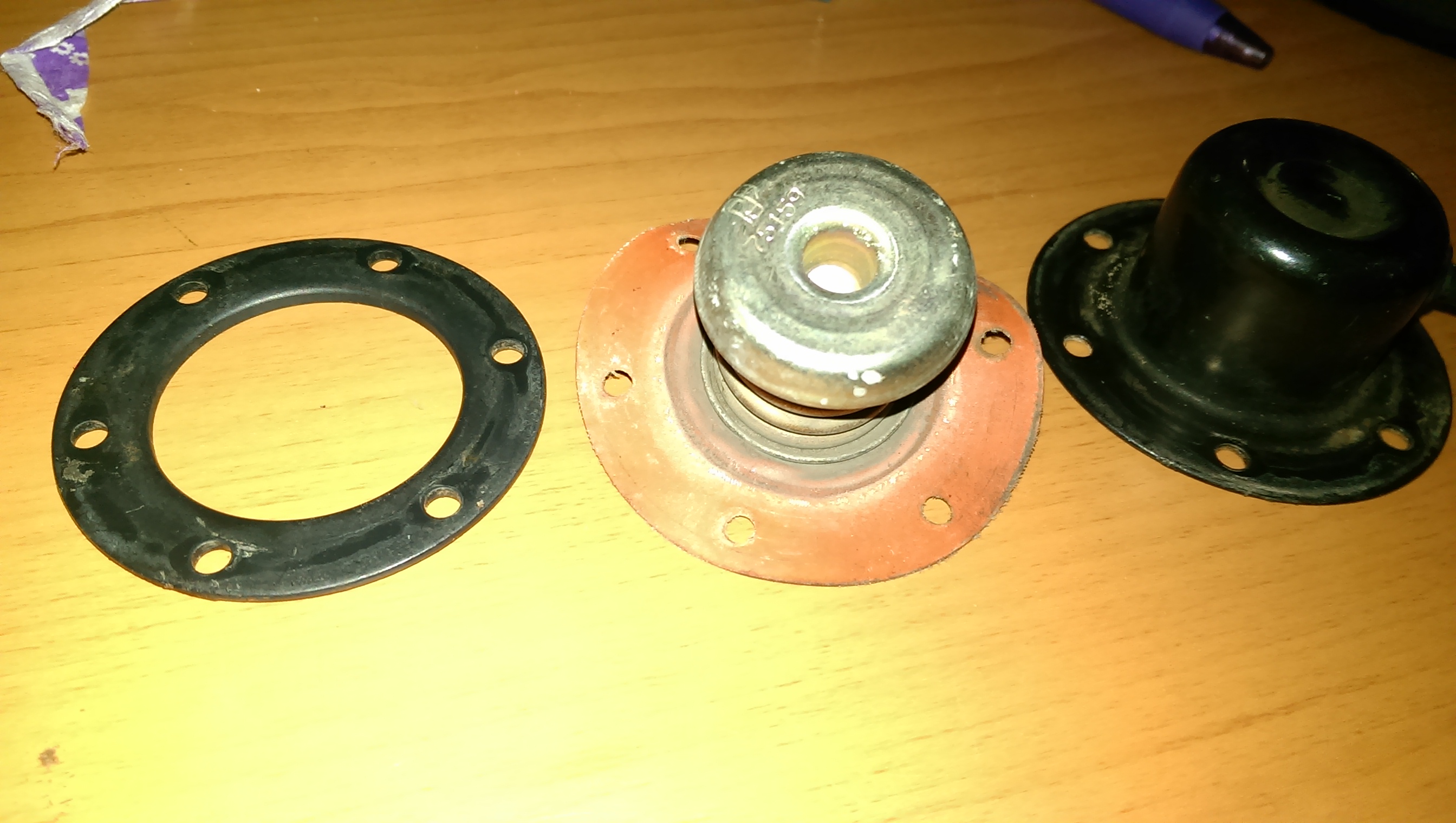

There is also a pool of fuel underneath the regulator housing that keeps refilling itself while the car is off

WOW! I have never seen gas just run out of the throttle body like a river! Damn! I would still think the cylinders were filling up with fuel. Defiantly take plugs out and spin over a few times to make sure the cylinders don't have puddles of fuel in them. Fix problem and install new plugs. Change oil.

Re: What part is this? its leaking fuel all over my engine
t10 torx screw is stripped and can't remove the faulty one. Autozone has a remover that i'll be picking on my way to work that supposedly will work(unless someone else has a way that should work to remove it? i tried the rubberband already to no avail).
I'll remove it tonight, bring the part in tomorrow morning, and finally have my own working car again.
Autozone guy hasn't seen that part but says to just bring it in and they'll swap it out. I'll man up when i have money(or student loans come in)
Attached Thumbnails What part is this? its leaking fuel all over my engine-imag0049.jpg

Got the new part, got the old screw out. Put the new part in, and like magic....there is a leak somewhere on the fpr. I'm thinking its not sealed all the way, either by screws not being in tight enough(which i'm sure they're as tight as possible and will otherwise strip), or the washer that's underneath the diaphragm was put on wrong(its been so long i unfortunately can't remember which way it came off originally). Below are pictures of the 2 ways to put it. if you notice, there is a lip on the black ring.
Currently its facing down on the car and i think thats why its leaking(the outer rim of the gasket is not actually touching the fuel rail not allowing the seal to be complete), but when its face up, it could cut into the diaphragm i think. Would anyone know the correct way? This part is pretty much ignored in every sort of video anywhere, and most cars don't actually use this FPR
Attached Thumbnails What part is this? its leaking fuel all over my engine-imag0053.jpg   What part is this? its leaking fuel all over my engine-imag0052.jpg   What part is this? its leaking fuel all over my engine-imag0051.jpg
As you can see from this pic, in this order.
Diaphragm
cap
ring
screws
The ring is on top to avoid warping the cap.
