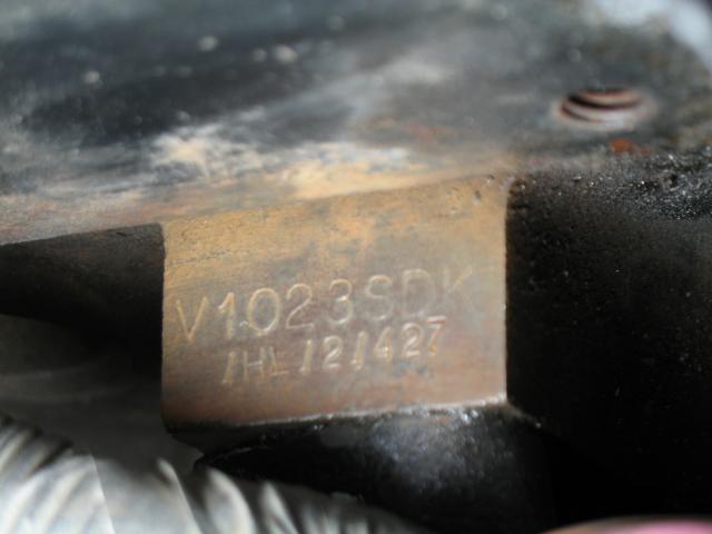

Hey guys, picked up a cheap 90 Camaro recently and I'm 99% sure it's a 305 but I'm also 99% sure it's not original. I looked at the numbers on the passenger side front and the partial Vin doesn't match. I'm having trouble deciphering the code though, as the next to last digit is poorly stamped. Anyway, heres what I THINK it says: V1112D3L or V1112DBL. The number below that says 1NL121311. So can you guys help me? Where did they get this engine from?

That looks like DBL to me.
Flint engine plant, Nov, 11th
1992, 305, F-body, Auto

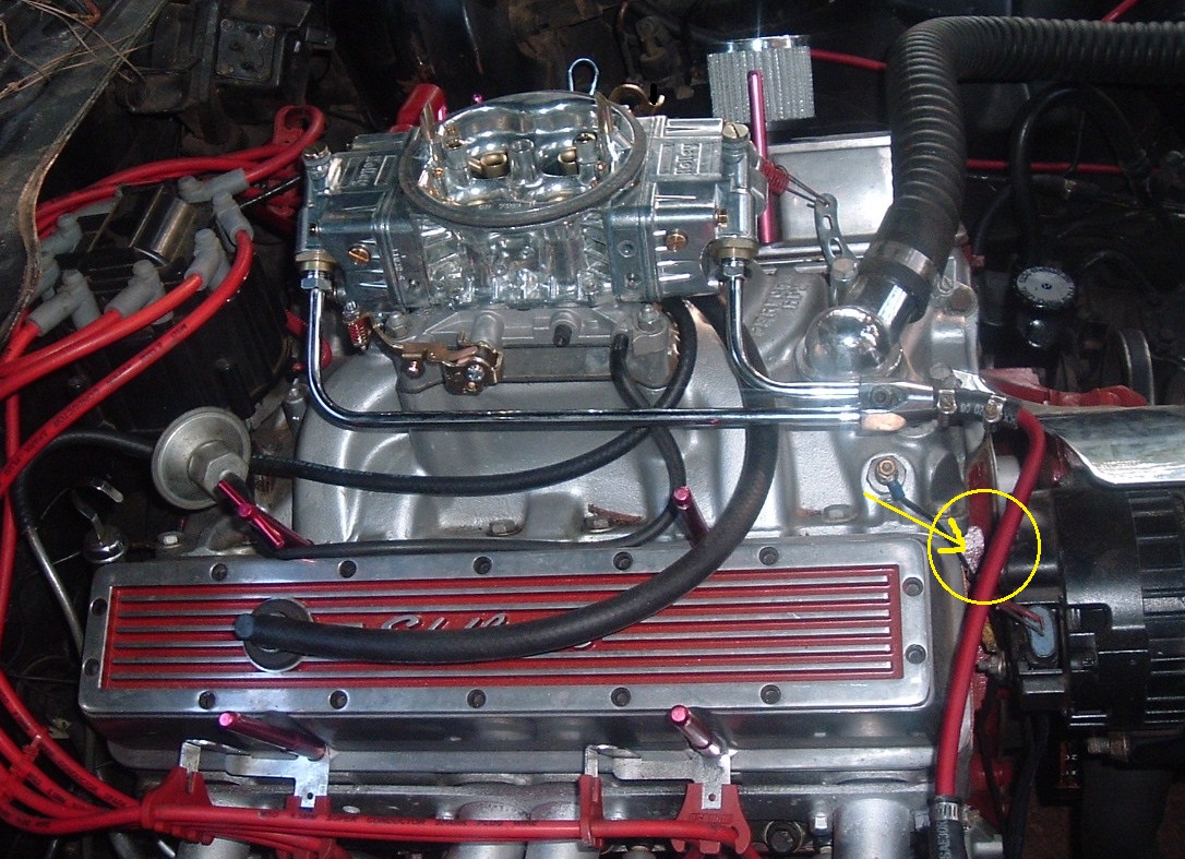

No, no plate, and not on head. It's part of the block, in front of the head
Every SBC has a machined pad on front of engine, pass. side in front of head.. It sticks out past the head, but it will be behind the ALT.
No, no inspection camera needed.. Just a flashlight really, and of course like I said before some type of cleaner, brush and rag.
Look down between ALT and head, up towards the intake.
Here's a pic of my car with engine installed.. Look at the yellow arrow and circle I made on it. The suffix code is where the arrow points.

The pics didnt upload.. Lets try that again
The casting number on block.. If installed in a third gen.. Go on driver's side fender, shine a flash light down behind the driver's valve cover, stretch up and over, with your head right on the power brake booster, look down under the wiper motor and behind the valve cover..
I don't have a clear pic of the casting number with head on block, but here's one with out the head, look at the yellow square and the arrow.. The arrow points to casting number

No dice. Theres no plate, or machined area like that on my engine that I can see, at least not anything that looks like what you showed. The head is flush with the block, I dont see anything looking from above protruding from the block from that angle. Didnt see anything from below either. Like I said, inspection camera would be the only way. Just way too much stuff--smog pump, wires, brackets, etc.--in the way--you cant see jack squat. But my alternator is on the driver's side, could be because its a Firebird--but I didnt see anything on that side either. Same with those numbers on the backside. Too many hoses, wires, etc. No way I could see that with the engine still in the car.

I'll have to really dig in there and look again. I doubt it was ever decked, the car has 156k, and the motor looks every bit of it. Clean overall, but plenty of old drips and leaks here and there. Pretty sure its OE, and has never been rebuilt. Im a bit of an ingnoramus, thats why Im trying to learn on this site! LOL Theres just so much crap cluttering it up in there. I'll keep looking. Thx....

Just went out and looked. Actually had better luck in the dark with a flashlight. You can see something is there, but reading any numbers off it is out of the question. That threaded hole in your pic is where the belt tensioner bracket bolts on, I think, and it totally hides any numbers. Plus, theres one of those flex hose wire covers about 3/4" wide that runs directly in front of it as you look from the pass fender. Like I said, inspection camera. LOL

Clean looking engine BTW..
Yeah it can be a real pain trying to see those numbers on a pretty much stock third gen EFI car.
I just went and looked at my '91 formula L98 and yeah your not gonna see it with out taking something off. The big alum. bracket that holds the AC and belt tensioner is bolted into the head acc. bolt hole and the leg of the alum. bracket sides right over top of where the suffix code machined pad is.
I didn't try but you might be able to pull the air intake filter off and look down from from the top side and see it, but not sure.
Atleast you know now where the numbers are
Also keep in mind the cleaning part I mentioned. Those numbers are lightly stamped in and fills up with dirt, grease, rust, paint, etc easily.. So most times you have to wire brush the pad, or spray a cleaner like brake parts cleaner, etc on pad and scrub with detail brush, toothbrush, etc and wipe with rag to get it where you can see the numbers clear..
Sometimes it's also hard to tell 3, 4, 5, 6, 8 apart and 1 and 7
