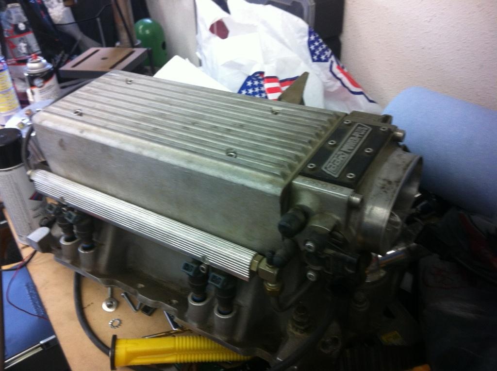

Hi I am debating buying a stealth ram from my friend . Comes with everything except the brain. Can my stock 85 z28 tpi ECM and wiring harness work with the stealth ram? I am swapping in a 350 and debating using my tpi or the stealth ram here is a pic

Yes, you are just replacing the hard, aluminum bits. The electronic bits don't know nor care what kind of manifold it is sensoring. You will probably need to tune for the extra airflow at higher rpm.
The 85 ECM will work, but the newer models have more aftermarket support. I don't remember the model numbers, but swapping from the 85' ECM has been done and documented. Let someone else with more experience in the ECM programming field comment before you go down that rabbit hole.

I am not much of a EFI person but if it was me I would reuse your old injectors too. If the injectors are higher flowing units I would imagine it would be easer to tune with the stock injectors if all you have are bolt on mods.

I'm with Impalla on this. If everything else is pretty much stock and you're just swapping intake for now, the stock ECM should run it OK. The earlier MAF-style EFI systems like your 85 uses are somewhat self-compensating because they measure the airflow going into the motor directly, as opposed to just inferring it from throttle position and vacuum. They won't handle big changes very well (cam change, bigger cubes), but and intake swap, sure.

X2. If you start with a running tpi motor, hsr swaps in.
However 85-88 has cold start injector. Hsr does not! You will need to delete that in the tune

I would not have posted up my comment had I not had some personal experience putting an aftermarket intake onto a stock-ish TPI motor. In this case it was a direct swap of a TPIS Miniram onto an 87 L98 Trans Am (headers, roller rockers, CAI, nothing else). The Miniram also lacks a cold start 9th injector like the Stealthram. It fired up and ran just fine in warm weather. In cold weather it took extra cranking, but still fired and ran.
Ideal? No. Will it run? Absolutely.
