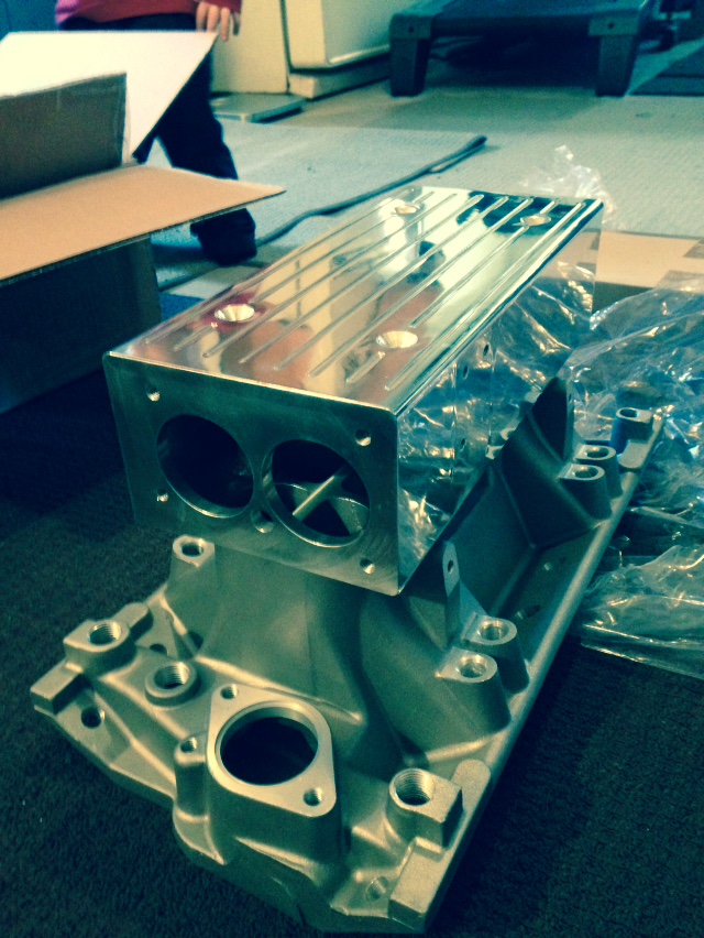

nope, sorry.
it's not even cheap aluminum. it's a very nice piece.

I see you won't post pics of the ports. qc is a big problem with that intake and why I'd never choose it. I paid $500
Total for My stealth ram. That includes every little bit I needed to install it.
As for the 383 vortecs question?
400 hp is easy with vortecs. 400whp is not.
If you want 400 to the wheels porting or forced induction is the only way. The runners are too small, and it just doesn't flow enough to make serious power.
Forget the 383. Buy better heads instead. You'll make more power.
or that's just the only picture of it that i had. and they say that the ching chang HSR has more meat for porting.
I have seen 3 different HSR like intakes. The Chinese knock off, a Holley version and a Weiand version. I would take the two american cast ones over the china junk. Port alignment was horribly off on the Ching Chang unit.
Old Nov 21, 2014 | 04:25 PM
Fast355's Avatar
Joined: Jan 2005

Getting off the OP's topic I suppose.
But for some lesson about cheap knock-offs is hard to learn. I followed that thread, I saw the pictures of the examples people purchased. As Fast wrote, the port alignment and quality is JUNK. Can it be fixed? Yes.
Does the average person who's only used to bolting parts together have the skill to fix it? No. There is a learning curve. So if you can't fix it, you have two choices. Pay someone to fix it, or live with it.
Better to spend the money on the HSR. Its legitimately the best bang for the buck intake that will support larger heads and cams. Its very similar to a LT1 intake in its flow.
it's seems as though you're confusing port alignment with port matching. something you should and will be doing whether or not you buy an authentic or imitation HSR.
the thread in question is obvious that the OP had every intention of porting the snot out of the intake in question. in fact, he contacted the vendor prior to buying it to ensure that the ports were sufficient, and superior to the original HSR.
i'm not defending **** chung junk. i've seen a lot of it. but this piece is good. i am content with it 100%.

I'm not confusing the two. The port alignment is junk. it's not even consistent port to port. Some ports are cast twisted.

For whatever reason, Holley originally assigned the Stealth Ram to the Holley brand, then swapped it over to the Weiand brand. Just a matter of the name printed on the label; nothing about the part is any different.
If you talk to old-timers whose brains aren't all ate up with old-timer's disease yet, you'll learn that the Stealth Ram is an old Holley product from around 1980 - 82 range, called the Street Ram. It wasn't a "go fast" product at all; more of a "looks" deal, for people engaged in those strange "square inches of chrome" contests you see in parking lots sometimes. It was a sort of mini-tunnel-ram, with 2 small bolt-on plenums that each held a 4-bbl carb. They intended it for use with something like 450 4-bbl carbs. It wasn't very popular; people figured out REAL QUICK that it was slower than a well-engineered single 4-bbl setup, and caused WAY MORE problems than it was worth (linkage synchronization and so forth, as well as overall poor low-RPM performance). It tanked in the marketplace. I thought Holley discontinued it sometime in the late 80s to 90 range but I'm not sure.
Here's a picture of one, unfortunately without the plenums. The guy that bought it specifically said that the 4-bbl plenums had come with it, but his forum post (not this forum) was about the base, so that was all he showed in his picture. All the same, it should look REAL familiar, except strangely enough, it doesn't have the EFI "features from the future" on it.
Imagine our surprise when THE EXACT SAME CASTING we all knew from 35 years ago showed up with a single horizontal-draft plenum on top and fuel rail bungs & attachment points!!! Of course since it's a single plenum, without all the problems of a wet flow system that the design would obviously be subject to, it works AHELLUVALOT better for FI than it did for carbs.
All that aside: a "rough idle" cam and TPI don't go together. TPI has NO high-RPM potential WHATSOEVER. Its design deliberately trades that away, in exchange for the "Mount Everest" of torque at 3600 RPM, as determined by the length of the runners. Nothing you can do to it will significantly alter that inherent characteristic. If you choose "rough idle" and run TPI, be prepared to go even slower than stock, as has been demonstrated time and again over the years. The LT4 HOT cam being the favorite example of this; slide that cam in your TPI motor, and go about a quarter-second slower. Over and over and over and over. People just refuse to learn from the experience of others.
