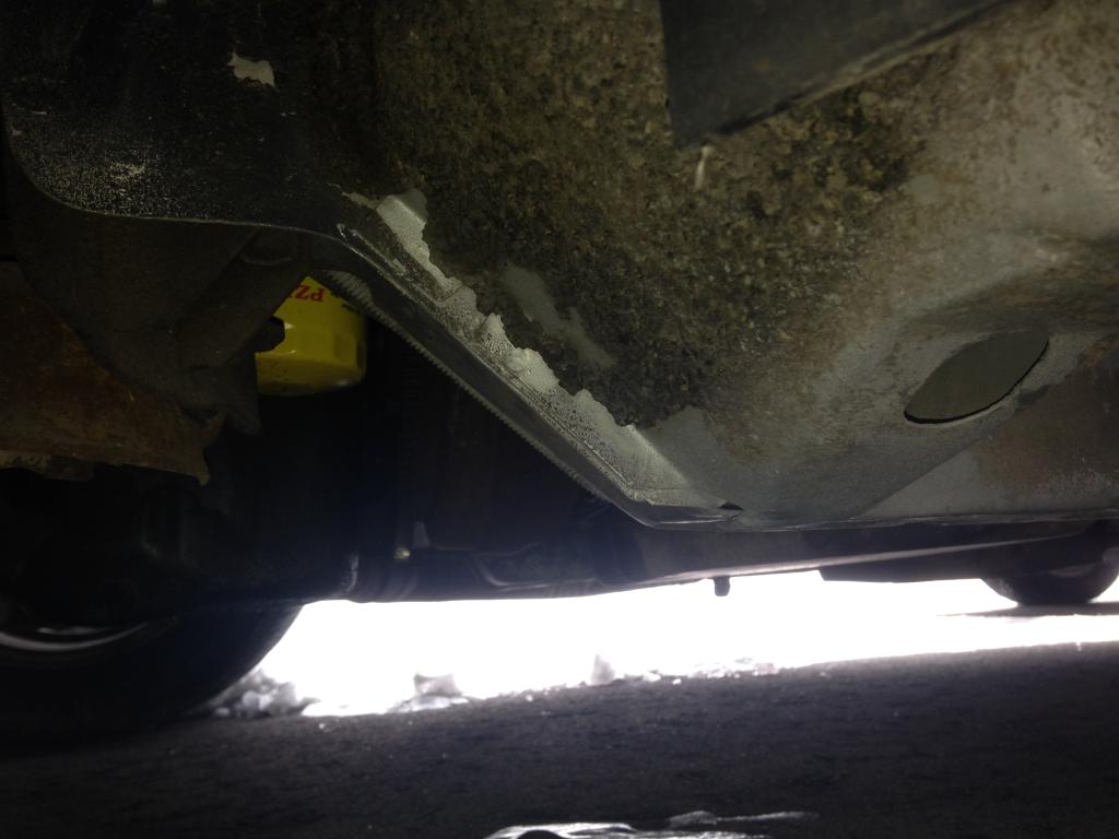

I hope this is normal, but it sort of caught me by surprise today. I was taking a peak under my new (to me) T/A, just checking things out, and realized that I can actually see the flywheel and torque converter. Every other car I've worked on these have been inside the bellhousing and not visible. Is this normal??
BTW: stock LG4 305 and 700R4 trans.
You can sorta see what I am talking about in this photo, to the right of the yellow oil filter:

Yes it's normal, for a car that's missing the dust cover that goes there.

GM auto trans cars would have a plastic dust shield bolted to the front bottom of the trans to cover the torque converter... They are almost never put back on and in a lot of cases took off on purpose to cool the trans/converter better.
Also the bolt holes break out and cover falls off.

Those covers are not hard to come by... plenty of em in junkyards.

There are always a few for sale on Fleabay. The thing with the cover is it keeps rocks, water, and small mammals out of that area.
