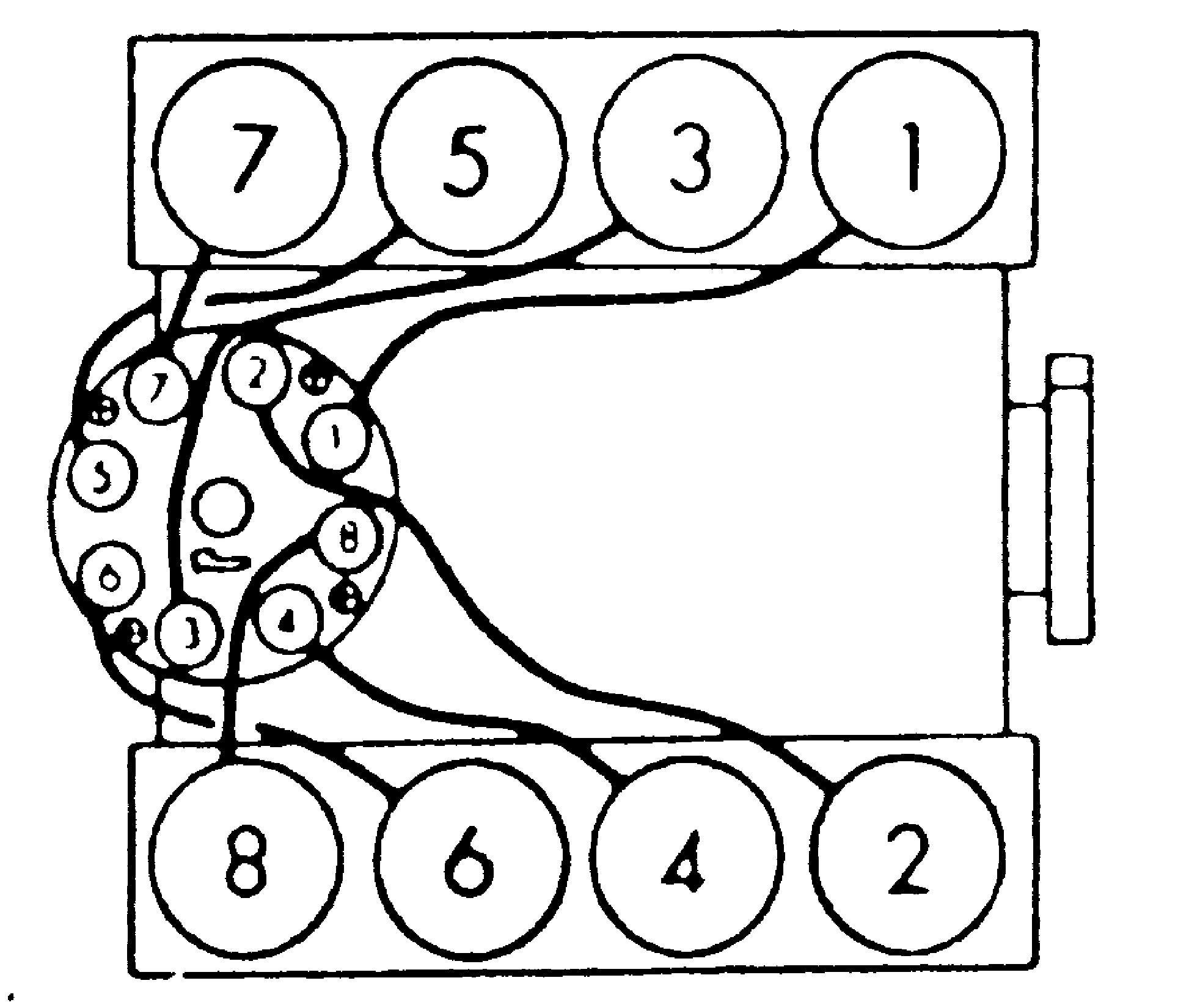

Re: Got spark and fuel & no start
Triple checking the firing order with the wires on the dizzy and plugs.
1-8-4-3-6-5-7-2
I put a new dizzy cap and rotor on (the bolts holding down the dizzy were starting to strip on top so I got a new one)
Took the dizzy cap off, verified the rotor is pointing to #1.
Verified the balancer is on TDC.
Took the valve cover off and verified that the #1 intake rocker is not depressed.
It did start for about 3 seconds but as soon as I hit the throttle it would die.
It will not idle above 400rpm though.
I have my laptop hooked up thru the ALDL, and it's not showing any codes or anything wrong that I can see.
No insult taken!
Thanks for your help!
Yes, I have the same firing order.
