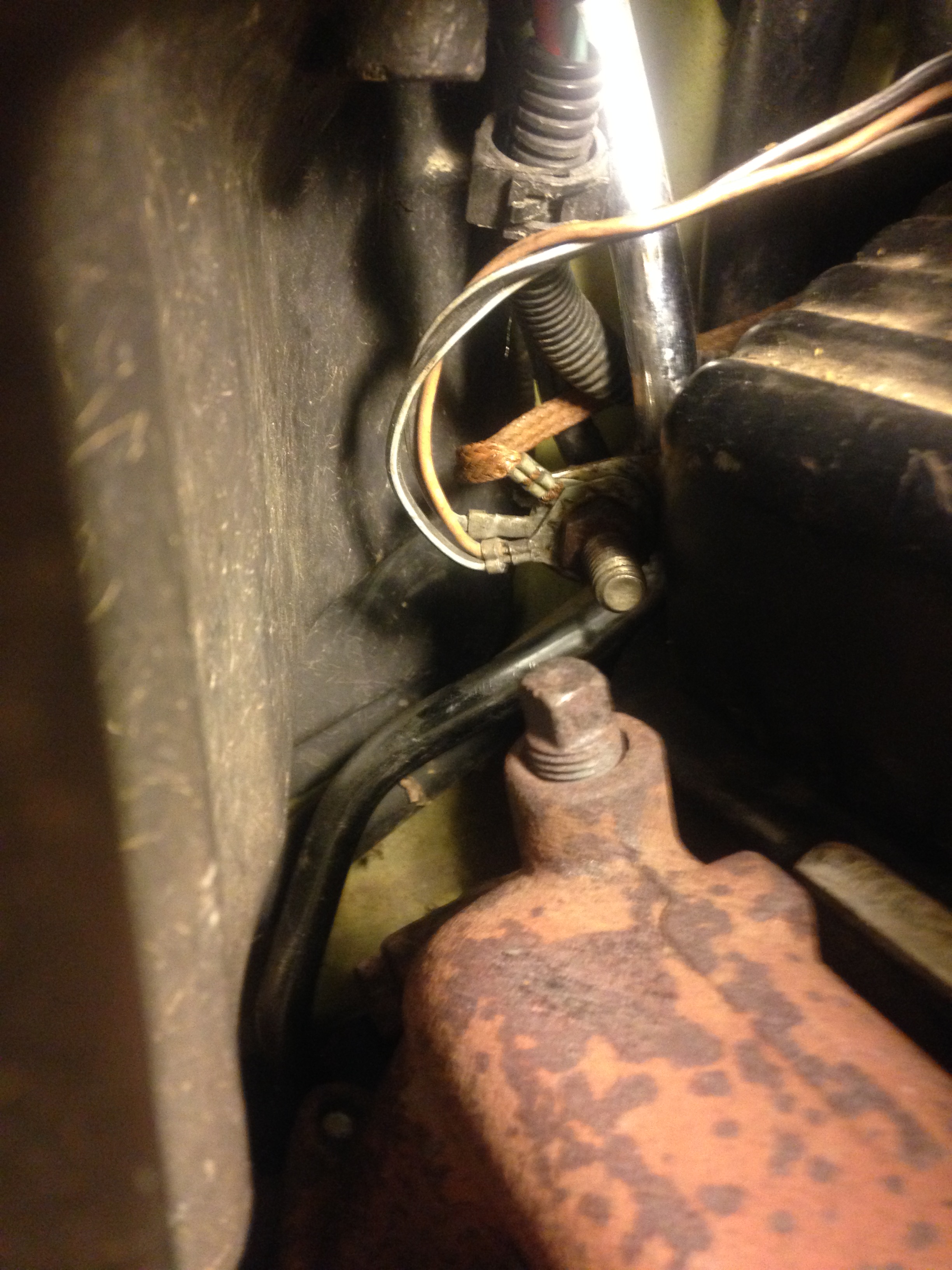

This can't be the intended ground??
Check out this picture. Looks like all of these are ground wires, including the braided ground wire that screws into the firewall above the right side valve cover. they have these all tied together and attached to one of the AIR tubes that I think go to the CAT.?? I would think this is a terrible ground. (The clamp used to attach it to the tube is loose too)
Is this where the factory originally grounded these wires? I am wondering if some of these go to the distributor and could be a possible cause of my rough, crappy idle..?

That's not from the factory. The factory ground setup has those wires and the braided strap bolted to the back of the cylinder head. The other side of the braided strap then goes to a bolt screwed into the top of the frame rail. A poor ground for the engine will definitely cause idling and driveability problems.

Frame rail? Is that on the other side of the firewall? I thought that braided strap was bolted to the firewall?

Some cars had the ground strap going to a screw on the firewall; some had it going to the horizontal "frame" thing at the bottom of the strut tower, below the exhaust. Both are equally effective and all that; they probably just chose the one or the other depending on which was quicker and eeeeezier on the assembly line.

OK, I figured it out. Originally these wires were bolted to the head with a stud then the AIR tube was secured to the end of the stud. The PO never bothered to re-attach the cluster to the head. = very bad ground! I will bolt these wires back to the head and cross my fingers.

Anyone happen to know what those wires go to? Two black with a white stripe and one tan colored wire. All go into the large wire loom that runs along the firewall.

do you have any connectors on the distributor? Looks like it might be the distributor and tach wire from the small sample picture you gave.

Grounds for the ECM/sensors.

Got them all bolted back to the head, nice and tight. Very little difference in my crappy idle...
Also replaced the fuel filter and O2 sensor. No diff...
