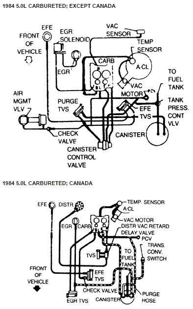

the upper image is the one that is inside my hood and the diagram im following. but as I see it here, it doesn't really show the air management valve going anywhere else really. Going to the gym now and right when I get back I'll get more pictures of the area and the tube i said was broken off. I appreciate all the replies and help guys, I don't really have anyone to help me here so I'm relying a little bit on this board for direction.

I believe, (at least on my car which is a TBI, so should be similarly set up to yours which is probably a carb) that the aluminum tube you have connects from the passenger side exhaust manifold to the drivers side.
If you try and trace the lines on the air valve, I'm pretty sure you'll find that one line comes from your smog pump, one goes into the passenger side exhaust manifold, and one is supposed to go to the drivers side manifold. I probably am not 100% correct on the routing here, but I think it's somewhat similar.
What I'm trying to say is that the smog system has an aluminum tube like that and I believe it connects both manifolds to each other. Either that OR it connects somewhere to the exhaust piping. That tube that is broken is most likely that smog tubing. On mine, that same tube was also cut I think around where yours was. I don't remember if I did that or if the previous owner did..... I completely changed my exhaust and could no longer use the smog setup.
The smog pump helps pump in fresh air into the exhaust which is some emissions thing to help the cat do it's job or something. Probably something to do with adding extra oxygen to turn CO into CO2, either that or helping to get rid of something else bad in the exhaust. With a hole there, you probably have a small/medium sized exhaust leak. Nothing to be super worried about, but something I'd address somewhat soon.
Getting rid of the smog system (since your line is broken) is pretty easy to do, has no negative effects on the car, and you car will still run very clean (if running properly) so you can easily pass emissions if you cat/egr are functioning. Now, if your state does under-hood inspections and are very thorough and strict, you may not be able to get rid of it, but I know a lot of people do and most states don't seem to care. Here in Arizona it isn't a problem. If it were me, I'd probably ditch the whole smog system so you can clean up the engine bay and make it easier to work on. It makes changing plugs much easier without all the junk in the way. Otherwise, you'll have to find some piping to reconnect that to it's original location. If it is hot exhaust that runs through that pipe, it will be difficult finding a hose that will last under the heat to repair that, so replacing the whole pipe would be a better option.
For your second question, the thing with all the curvy lines coming out of it is the proportioning valve for the brake system. It is directly under your master cylinder which you fill with brake fluid.
Again, not 100% sure here (but I'm pretty sure) that under that rubber nipple that you say is leaking, there is a bleeder valve. You should be able to remove the rubber nipple and see a bleeder. If that is the case, you should be able to tighten the bleeder valve ( with a small wrench or long socket) and stop the leaking (that is unless the threads or something are damaged which would be very unlikely unless the previous owner did something dumb.)
