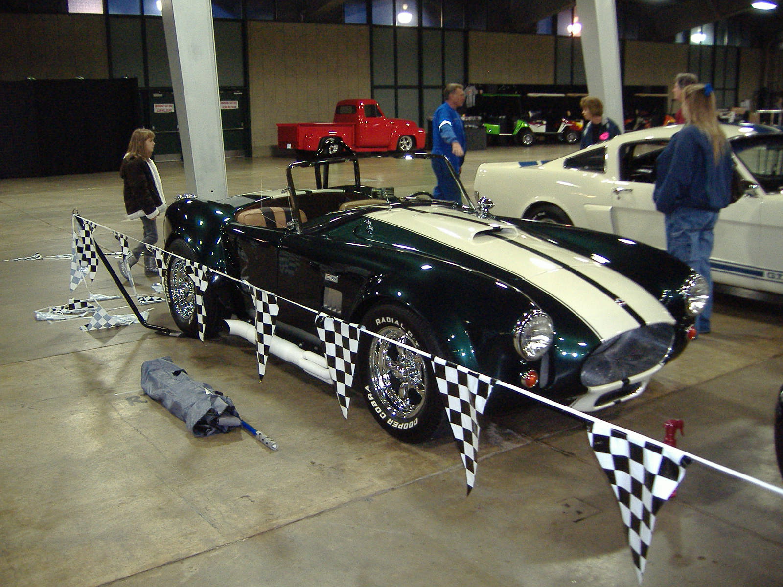

Guess I need to learn what all these relays and circuits do on theses types of cars. I built 66 Cobra replica, 300 HP 289, bare bones car, no radio, heater, defroster, etc., just an engine in a frame with a body over top of everything. Now that I can work on. I attached a picture of it.

The Cobra looks cool. Great job on it.
