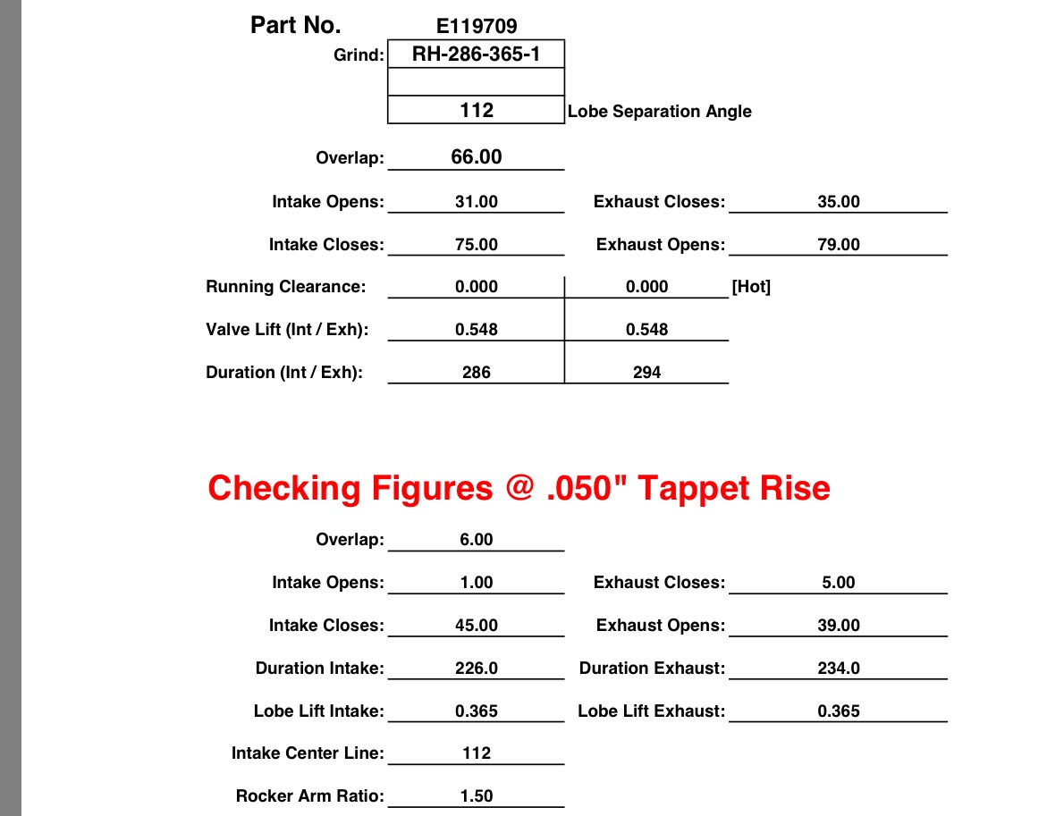

Here is my cam card

112 lsa is on the wide end for the Eddy RPM, assuming that's what you've got(you never did say). The wider lsa tends to push peak torque rpm higher and flatten the curve. We TPI guys often run 112 lsa to minimize reversion from overlap. You would be better with 108-110 lobe separation with that duration on a dual plane intake. The Eddy RPM with 750cfm Holley DP would be a good fit for that motor. Again, just my thoughts.

Is it the single plane unit? A friend of mine just bought a 79 Camaro with a 383 running that intake. I believe it's a copy of the Dart Hurricane. Finish isn't quite as good, but it works. Chad Speier has done some work with those and made impressive power. If it is the single plane, it wants closer lobe centers. 106-108 generally for a single plane. Again, just my 2 cents.
