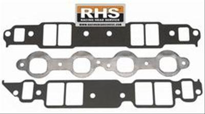

I've tried several and while I can say I haven't had a failure, that doesn't mean that I won't this time around.
I've found these. The reviews are mixed.
GM Performance 89017465 (also sold as AC Delco 89017465)
FelPro MS98000T
FelPro 1255
FelPro MS90131-2
RHS 1707 (as recommended for their Pro Torker heads.)

That's one I actually haven't tried. I like the looks of the metal core to go along with the silicone beading. One thing I don't like about it, and the similar plastic/metal carrier style gaskets, is that the intake ports aren't isolated from each other as there's no beading between them. No sure how that plays out into how the engine performs. You would think the vacuum would be messed up to some degree. I used to use them exclusively ( the MS90131-2) until I was convinced to try the Fel-Pro 1255.

Interesting twist here is that with my heads getting milled, I may end up with intake alignment issues. The Fel-Pro 1255 I've had been using is .120" thick and that might be what I need for best fitment. If I recall, the typical plastic carrier gasket is only .060" compressed.
Does anyone have a MS98000T to measure? (That's the Fel-Pro metal core with silicone beading.)
