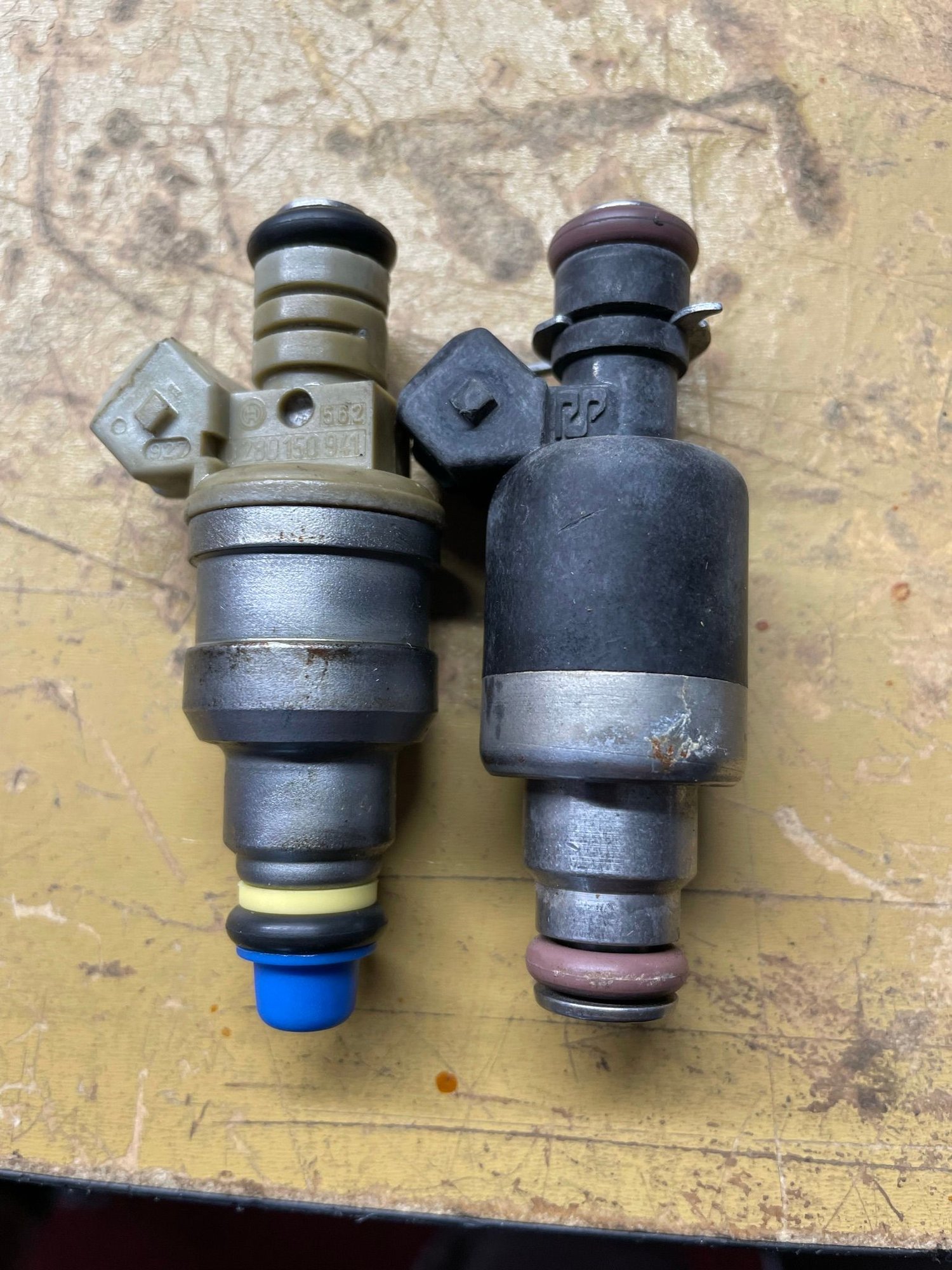

I’ve had the same start, run, die issue on my 91 Camaro with 3.1 V6 and went ahead and changed some parts (TPS sensor, regulator diaphragm, fuel pump) and bought some injectors from Southbay. Finally got time to work on it yesterday and got the old injectors pulled out but when comparing them old to the “new” they look completely different. Not concerned about the body shape but the top of the injector on the Southbay units has two grooves. With the injector seated fully in the fuel rail, the groove closest to the injector tip would be the one that the C clip would fit in, however, that groove doesn’t go 360° around the injector therefore, once the injector is seated, you can’t rotate the C clip around to lock it in.
Also, the injector tip area and its O ring are completely different then what I took out so I’m afraid these may not be correct. Obviously, Southbay is closed over the weekend and I’m gonna call Monday but curious what brand the original injector is…the pic below shows the two side by side. RH side is original, LH is the Southbay injector. Thanks!
did the injector replacement get the issue sorted then? the car started again?
Yeah, this fixed my issue and the injectors worked fine, despite the minor differences.
