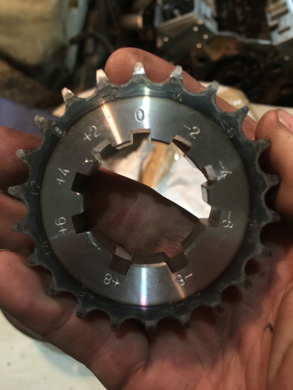

Here's the timing gear I'm using

Here's it's set at -2

instead of relying on the cam card and the timing gears, get a degree wheel and a dial indicator and dial out the cam.

Def do the degree wheel some timing sets are known to be off QC has gone to hell in the last few yrs
Shouldnt have a PTV issue. Running way more lift (know thats not the end all be all)at one point just under .700 with mucho head shaving and domed pistons .015 down no issue? Something else is going on.
If the timing set cks out id be half temped to stick that cam on a Cam Dr a good machine/head shop will have one it will tell if exactly what that cams doing if somethings off.
