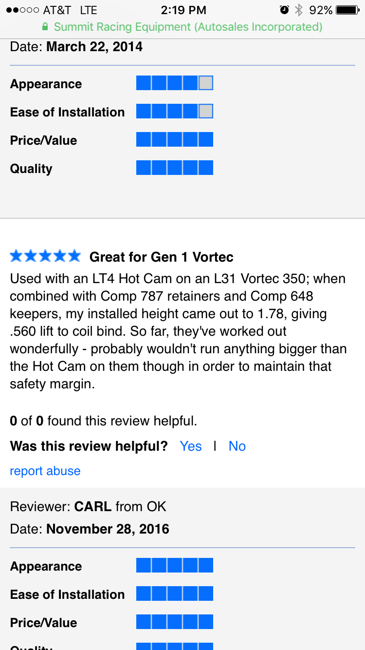

So ive been looking into blower cams and the stock vortec valves max out at 470" of lift because of the seat - Im looking to see whos running comp 787 retainers and LS6 valve springs - Also what kind of cam's are you running?
Was thinking about running a .503/.520 lift cam, but according to my math that puts me in spring bind territory.

Alex's doesnt have those kits anymore. I called them the other day - They want 175 for the current behive kit they have, plus seals, and retainers, and yes those were the springs i were looking at. Also if my math is correct, at 1.700"-.520 lift puts me at 1.18" and thats before retainer to seal clearance and spring bind is at 1.220

I used a set of LS3 springs that were given to me, Comp 787 retainers and Felpro seals for Vortec. Running an LT4 Hot Cam on 1.5 rockers.
