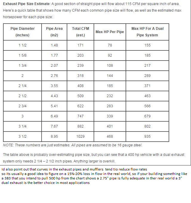

Axle/Gears: MWC 9” 3.00
Re: Engine Combo Thoughts and Suggestions - Cam Selection
There is some hp in a 3.5" catback vs a 3" at thr 500 hp level imo. All the latemodel cars i see in the 400-550 range def seem to show better results
A good flowing muffler in a single 3" can be used for what you are doing but consider a bigger system down the road or a cutout at the y.
2.5" y pipes should be ok for you

I think the collector on the y pipe is 2.5. Since I have the headers and catback already I was thinking of using those as long as they won't be too restrictive for the 383 for now until I can do a full dual down the road
Old May 25, 2017 | 02:57 PM
Orr89RocZ's Avatar
iTrader: (20)
Posts: 25,895
Likes: 429
From: Pittsburgh PA
Car: 89 Iroc-z
Engine: 555 BBC Turbo
Transmission: TH400
Oh i would want a 2.5" into single 3" outlet y pipe

Originally Posted by 2012sergen11
Also would the headman shorty headers and ypipe be too restrictive?
Engine will be in the 450 hp range (flywheel)
Here is a chart I had.
