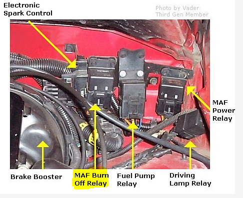

My prime suspect would be the relay socket connections, wiring, and relay contacts themselves. Both the MAF power and MAF burnoff relays are required to have good contact so the MAF analog signal can reach the ECM reliably, and so the MAF has consistent and clean power.
I think you are on to something here....
So, I pulled the plugs out of all these relays and found that the one that I highlighted ("MAF Burn Off Relay", found this image online so the names of the relays may be off.) was not only FILTHY, but also two of the wires were stripped back about a half an inch and touching each other. I cleaned the terminals and wrapped one of the wires in Super 88 and fired it up and it started and drove fine.
I am gonna try and start it in about an hour and see if it snaps to life again.
Thanks!

So. in my 89 the relay closest to the passenger side was for the fuel pump, and the two next to it were the MAF Relays. I ran to O'Reilly's and picked up two relays for $35.00 (Power and burn off) and replaced them both.

Those original relays did their job of switching low-level signals for almost 30 years before they lost perfect continuity. It would be impressive if everything on vehicles lasted 30 years.
It's not surprising that the relays were in a different order. That photo was from my '86, and has been spread all over the www without the disclaimer that positions may vary. The only way to verify is with the wire colors.
Wait, that was YOUR picture? LOL
