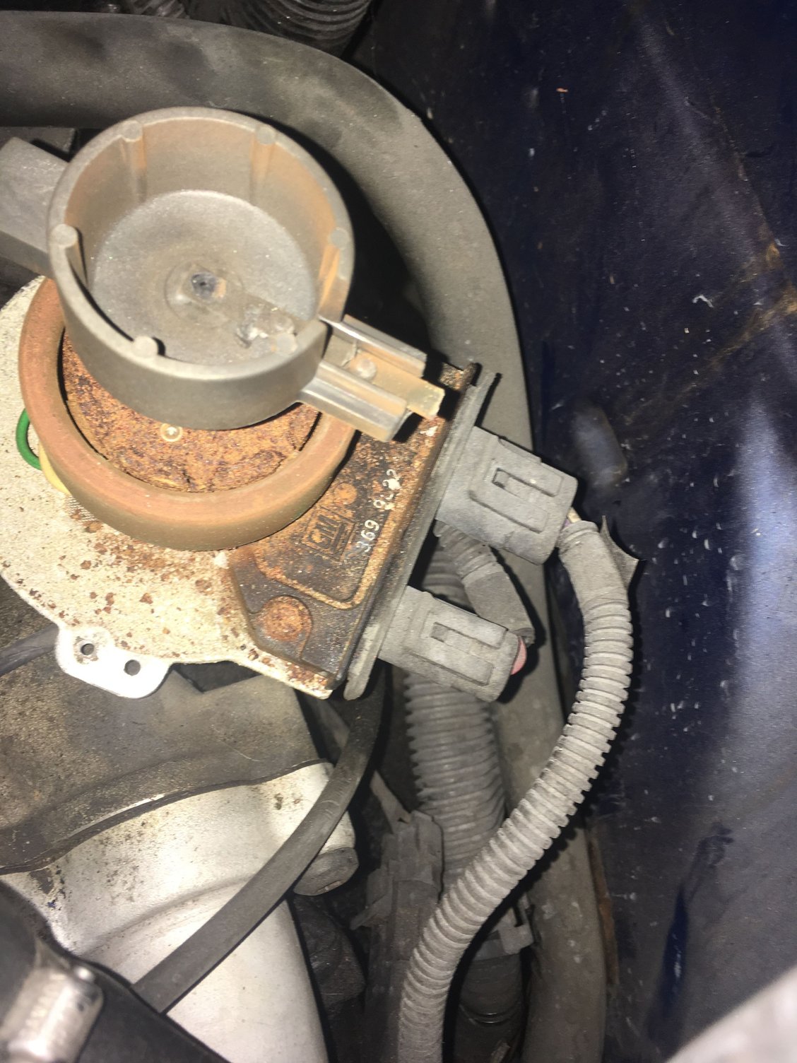

I bought a new battery because mine kept is old and kept dying. Now I can hear a faint humming noise all the time under the hood. Engine off, Key off, Key out of car. Could this be related??
I replaced the Ignition coil and it didn't fix the problem, and when i opened up the distributor cap this is what i saw
I'm no expert, but that don't look too good. What do y'all think?

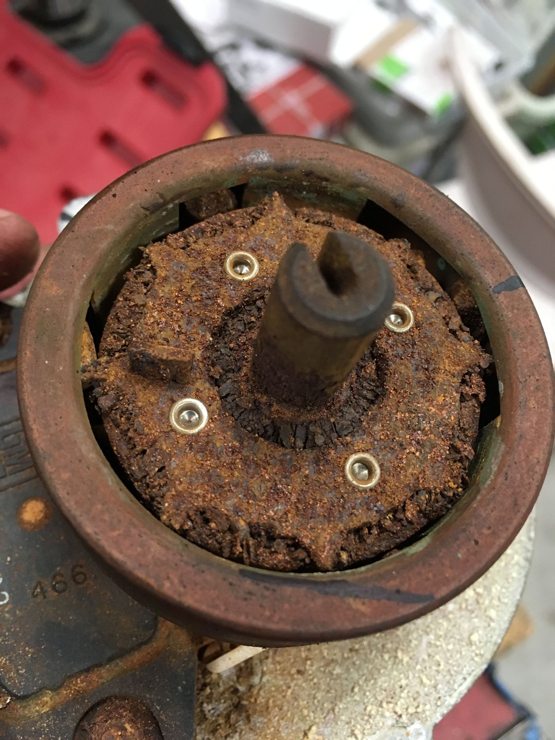

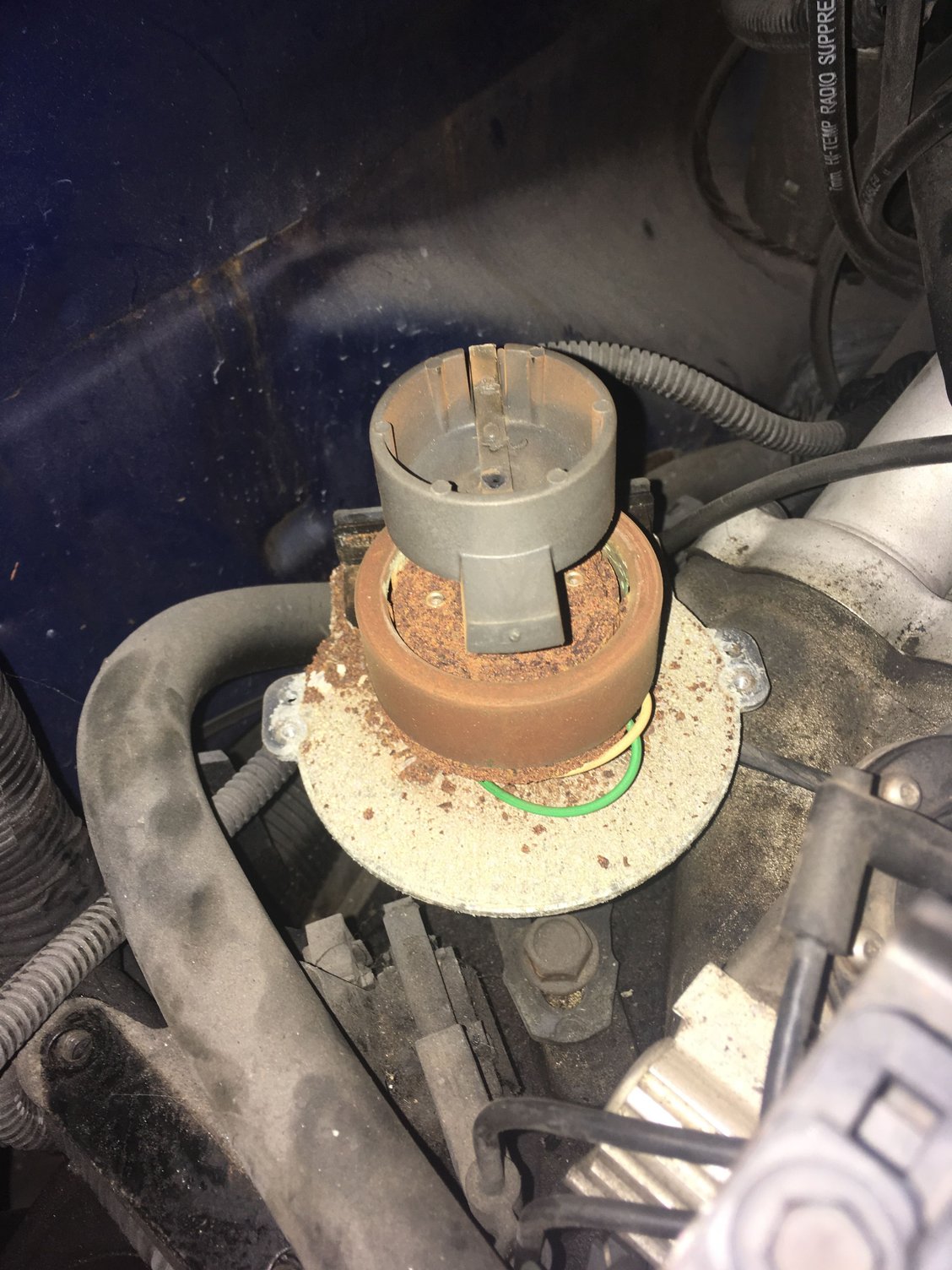

So I replaced the Ignition coil, distributor cap and rotor and now the car will idle indefinitely. However it still sounds like dogs**t and won't rev. Now I am trying to take out the distributor to replace the Coil Pickup and the dang thing won't come out. The cap is off hold down tab is off the shaft and everything. Is there something simple I am overlooking or do i just need to gorilla this guy out??
EDIT: I got it out and oh my I think i found my root cause

So my distributor was totally rusted to hell. Little parts were broken off and stopping the shaft from rotating. Got a new one on the way now.

New distributor is in and the car runs better than it ever has. Man did I overcomplicate this problem. Thanks for your help!
