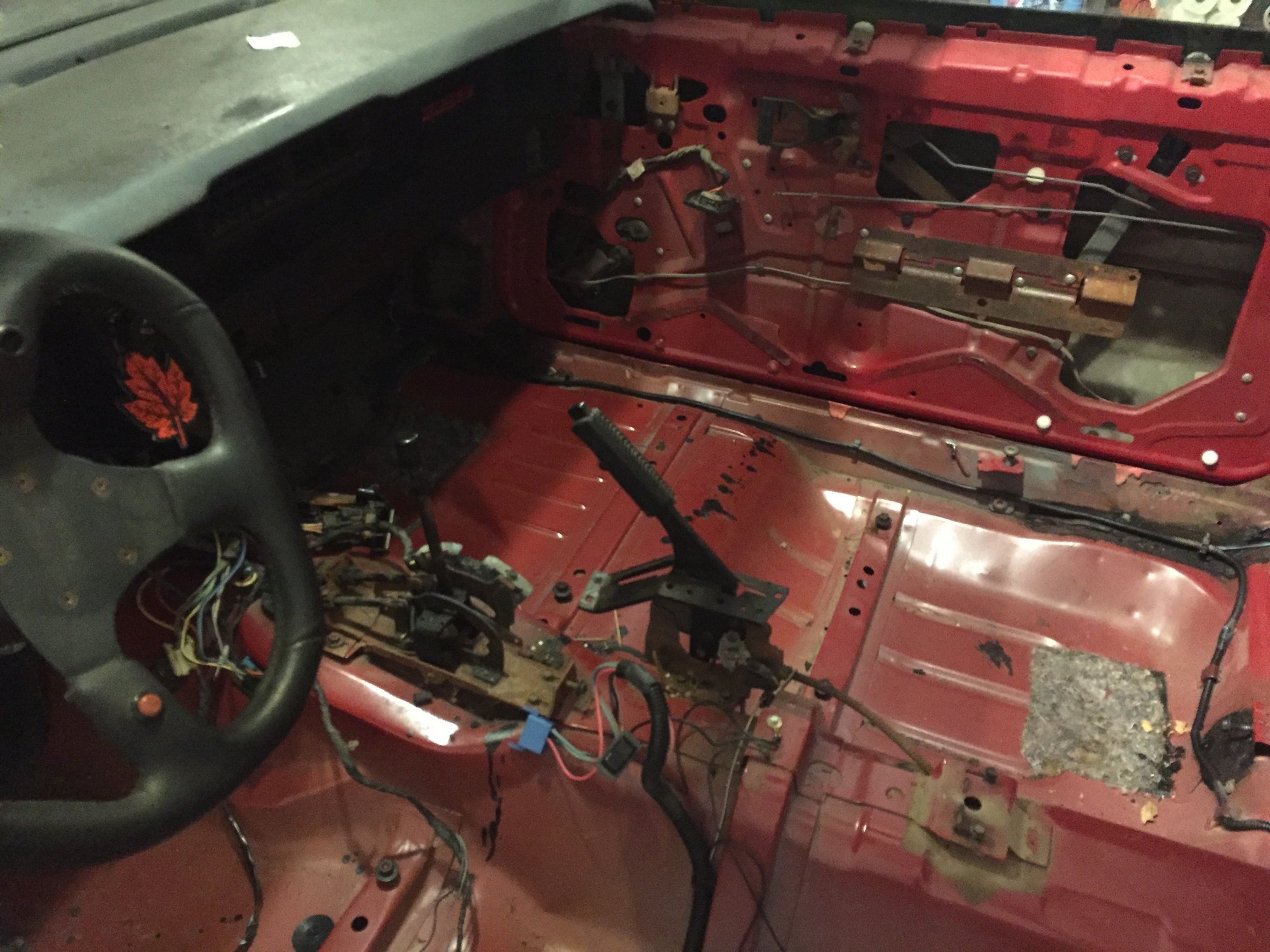

Haven't done much to her besides pull the heads off. I'm dropping the oil pan with it in the car to replace it.
The engine looks fresh inside, pistons read bored .040 over.
I want the Vortec heads and intake so am shopping around. I need some headers and a 3 " exhaust. It looks like the Magnaflow kit is a nice choice, but I can't figure out a decent header option with the 3" output without breaking the bank. Prefer stainless....any great option for me guys?!
I did buy a used T5 setup too and plan to swap that in. Guy said it was fine, no issue. I need to look into cracking that open and what to inspect before installing it. Is that as easy as everyone makes it out to be? I read the front of the case is the weak point but mine looks solid.
I have an interior but it's ratty, will deal with that later.
