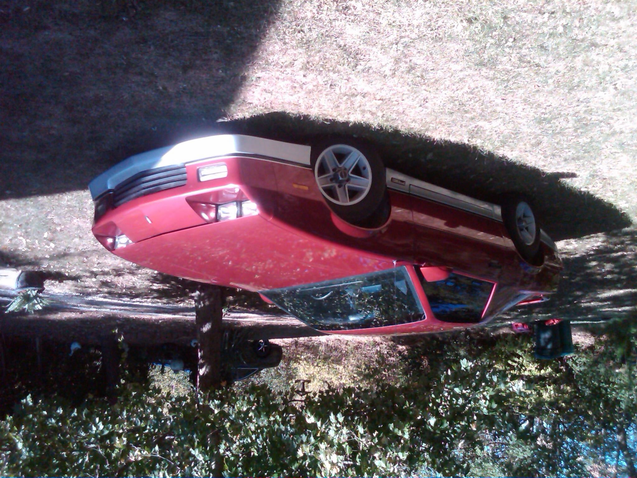

I want to see pictures of this car! sounds great
Re: 88 RS 2.8L Won't Start, Fixed Many Things and Still Won't! *Help Please*
Oh and about the pics, the one attached was taken a little while back from when it was still running but had the miss. Another is where it sits now, in the garage being used as a shelf...

very nice! don't see too many two tone RS's
