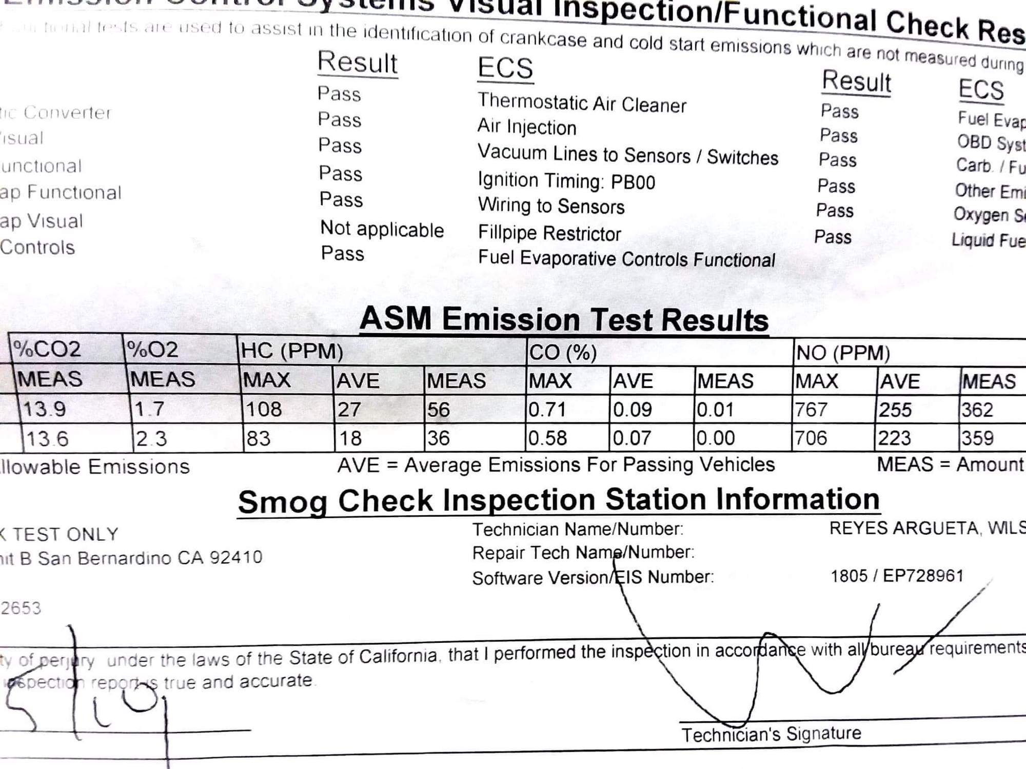

My smog measurements taken 4 months ago before all the new parts change.

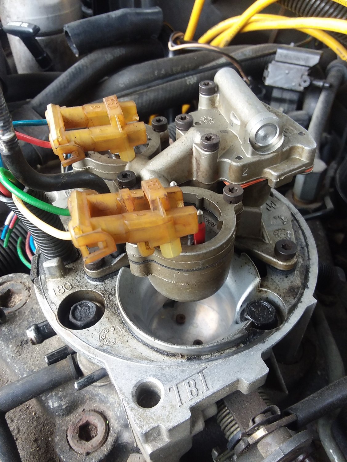

Heres my TBI. Who thinks the injectors look new? Are they original? even the TBI gasket looks new.
More at bottom of pics...
I put the TBI right back on. The TPS plug is different the one I'm switching in, too.
The 3 bolts holding down my TBI, all 3 were loose. 1 was kinda right but the other 2 bolts were really loose!
I am driving the car now and what a major difference after tightening the TBI bolts up! No more idle hunting but will do the ultimate shut engine off then start up to make sure. And the idle does not drop lower then idle rpm and its running cleaner. I'm still testing to see if it will cutout...

Tightening the bolts didn't fix it.
Can someone look at the pics above and tell me if they look original or have been replaced ?

Re: I'm LOST! Strange "cutting out" (ignition / fuel? ..) 91 TBI
Vacuum leakes under the throttle body confuse the ECU. And that was a massive leak
Looks like someone had it off at some point.
Okay, heres what I did I swapped the upper half of the throttle body, the top housing the injectors and regulator, keeping my bottom half.
On first startup the spray pattern was there but looked like some stragglers spitting droplets on the outside of the spray pattern but, couldn't be sure if it wasn't a problem because it idled very smooth.
I went for a test drive and I wow what an extra improvement on top of tightening the 3 loose big tbi bolts earlier today. I think I am now experiencing what a fully stock 305 feels like to drive.
It's more responsive and quicker i had a hard time staying off the gas pedal and giving this t5 a fun work out haha.
Oh and the small bolts that hold the top half of tbi, 1 or two of them were loose too!

I'm almost sure, let's hope, it was the injectors or pressure regulator. No symptoms re occurring, yet.
and I'm loving the real smooth idle.
