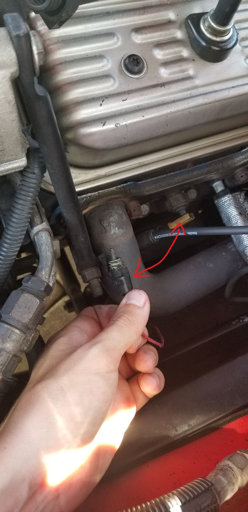

I cleaned out my engine bay yesterday and while doing that I noticed a couple weird things I need help putting back (I assume). I've marked it to make it painfully obvious what I'm talking about.
This first picture is on the driver's side. It's a connector I found dangling at the front of the engine, behind the belt. It looks to be a part of the same buncha wires that the yellow connector is coming from.

The first one goes to the oxygen sensor in the driver's side exhaust. The hose in the second pic goes to the oil cooler. Since both sides are disconnected, it's completely removed from the circuit and should make little if any difference. Normally it's connected inline with the heater core. Assume it's disconnected because something or other leaks, or the heater core has been deleted, etc.

This actually raises a couple more interesting questions. I just had my o2 sensor replaced a couple weeks ago because my car is throwing OBD code 13 but it hasn't shut off the code. So I assume they would have plugged it all in at the shop... Or at least said something.
I have no idea if the heater core is still in there or not. I haven't tested the heater much living here.
If I find a place for that plug will it finally get rid of the check engine light?

Remove the broken-off piece of sensor stuck in that connector. Inspect the sensor installed in your car: if it doesn't look brand-new and shiny, change it out YOURSELF. Then of course plug it in.

I took a look at the sensor and it does look new so I'll plug the wire back in.

With those headers, it's not impossible that the sensor will never get hot enough to work right. If so you'll probably need a heated one which will require a certain amount of extra wiring to get it to work. If you still get O2 sensor codes, especially if you reset them and they come back on after maybe 5 minutes or so (some reasonable length of time for the ECM to wait for it to heat up before deciding it's not working right) as opposed to almost immediately (ECM doesn't even see a sensor out there) then that's probably the road you'll have to go down next.

So I'm looking at it and a purple wire is coming from the sensor, but it was plugged into a green wire with a similar sensor on it. The green wire seemed to come from a loom by the firewall. I can't find a ton of info about it. Anyway I plugged in the connector that's in my above picture.

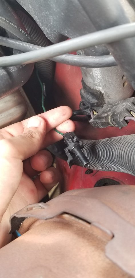

Here's a picture to avoid guesswork.

Can't think what a single green Weatherpak like that would be doing in that particular place. I'll leave that to someone with more detail familiarity with TPI than I have. It's definitely something ECM related though; not the temp gauge or any other "car" part like that.

EGR temp sensor. NEXT!

You guys are the best. Thanks for all your help! No more check engine light so far!
