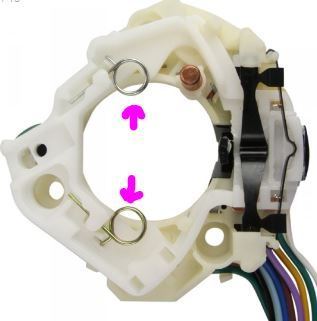

Re: NEED HELP,IGNITION CYLINDER LOCKED IN ON POSITION
Just took the car out for a drive again and now the left hand signal quit cancelling automatically. That’s weird because it worked perfectly after i installed the lock and put it all back together.
I drove it around for about 30 minutes and it worked everytime. What did I do wrong? Anyone here had this happen to them?

The cancel is purely mechanical. The nub on the cancel cam hits the wire arms on the turn signal switch. If it's not canceling, then the cancel cam probably isn't centered with the wheel centered, or one of the wire arms may have come out of it's clip, something along those lines.

Thanks for the tip. When I installed the new lock cylinder I had to take the screws out of the turn signal switch assembly to access the cylinder screw. I had thought I liked it up correctly,but I will take it apart and check it again. All I know is that it worked fine after I put it back together. I drove it a couple places and it cancelled like it always did,then next time I took the car out it quit.

Got distracted and forgot to embed the pic with the last reply...
The steering wheel will not slide down to where the clock spring is. The 21mm nut that holds the wheel on would crush the plastic clock spring so the wheel shoulders on the column higher up. And since aftermarket wheel adapters fit both column types we can also infer that there shouldn't be any rubbing of the wheel on the column plastic otherwise a different adapter of unique dimensions would be required for each.
Hmm, reading my previous reply, I see I garbled the message. Two comments got jumbled into one incoherent comment. What I was trying to get out is there wouldn't be a gap, but it might rub since sometimes it seems like the collar of the older wheels is deeper than airbag wheels. It doesn't have anything to do with the clockspring (for the airbag).
The other bit I was getting at, is that with the clockspring removed, the top of the column doesn't have a finish trim piece like earlier columns. The collar of the column loses a bit of it's finished appearance because the clockspring takes the place of the cap on earlier cars. It might look a bit funky under a close inspection, but most people will never notice.

Thanks for the info and the photo. I found my own personal steering wheel puller so I can take it apart again without renting one from autozone.
What would cause the spring to pop out? I hope I won’t have to replace the plastic piece
Beats me. I'd say most likely explanation is something was reassembled wrong. But it's possible something failed. Fortunately it's a simple system, should be easy enough to see the problem once it's apart.
Ok,I will take it apart again tomorrow. I was extremely careful though that everything was reassembled precisely as it was before it was taken apart,and the cancel cam and lock plate were installed in the exact position they were originally. I photographed every step before taking it apart as well.
As as I said,everything did work perfectly after I finished. The signals cancelled as they should. I wasn’t until later on when it wuit
