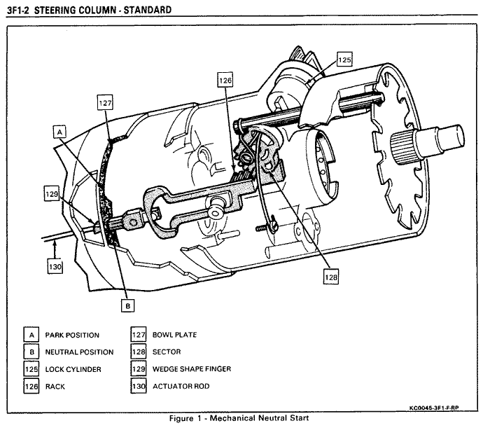

Here's a couple of areas to look.
Thanks a lot man...hopefully this helps me figure it out

Old Apr 21, 2004 | 09:05 PM
Trickster's Avatar
Posts: 6,127
Likes: 12
From: conway, s.c.
Car: 1989 Iroc-Z
Engine: 5.7L TPI
By plastic piece behind the steering wheel, do you mean the bowl plate (item 127 in the picture) or the round plastic piece underneath the steering wheel?

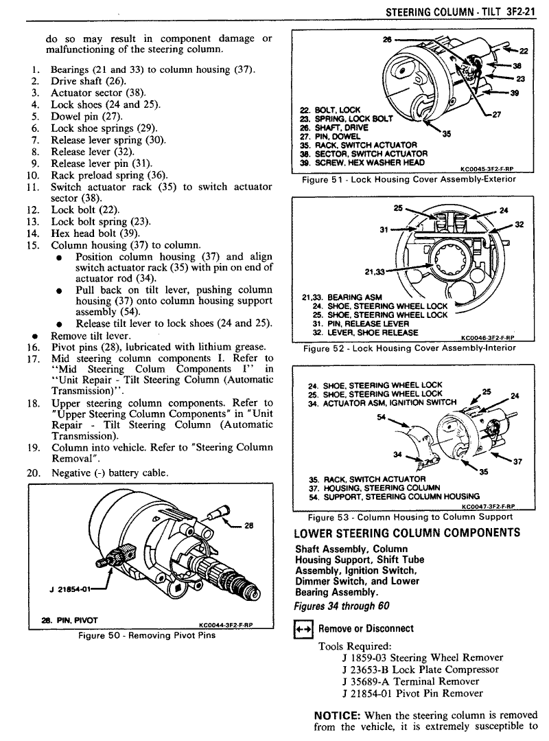

Okay boys & girls,
Are you ready for this, I know it may look hard but it is easier than it looks. So hang on to your patoootie. BTW, the tool for removing the lock plate is rather in-exspensive and well worth the money.

Great stuff man...
one thing....
The root of this problem is almost positively the lock cylinder right?
so all i have to do is get in there far enough remove the screw that holds the lock cylinder in place, and just replace the cylinder ?
seems easy enough, i'll go see about the tool tomorrow
thanks again
