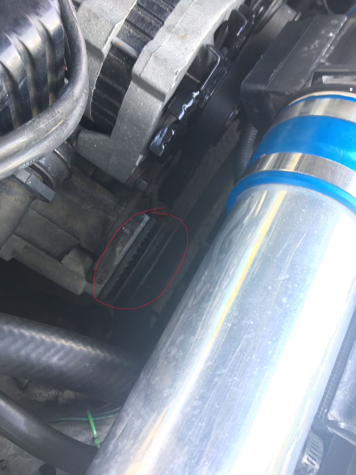

I was driving with moderate throttle, and at about 3k rpm a belt snapped. From what I can tell, It's the A/C belt and the air pump? belt. Not sure what an air pump is...some googling says its for emissions? My car is exempt since it's antique so if there's no issues with having the belt off, I'll just leave it off. As for the A/C belt, the A/C didn't work in the first place, so I don't really care. I was able to fire the car right up and drive it home normally, but it was only a ~2mile drive.
Can anyone identify the missing belts and let me know if it's safe to drive? The first photo shows the location where the belt that snapped was. The second one is an older photo that shows the belt that came off when the other snapped.

yep,A.I.R. pump belt off,A/C belt flipped over(,but is intact?) as long as the water pump turns you are good.

Yeah, I got the car a couple months ago and the mechanic who did the pre-inspection told me about it. (So for the record i wasn't the idgit who put the A/C belt on backwards.) I put the repair off and this is what I get. The Smog Pump belt was totally intact and fine; I didn't see any wear on the belt so I went ahead and put it back on. So now I'm just missing the A/C belt , which like I said my A/C doesn't work, so I don't notice a difference. Car seems fine so with the smog pump running again I should be good to go.
