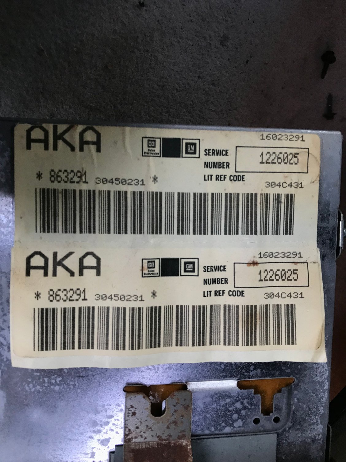

What is the PN on your ECM ??
I didn't see anything labeled "part number" on the ECM, but it has these two labels on it. Maybe one of them has the part #?

You can get a replacement ecm on eBay for relatively cheap.
Just swap in your prom.
https://www.ebay.com/sch/i.html?_fro...3&_nkw=1226025
Good to know. I take it the part number for my ECM is 1226025 then?

Re: Can't read codes from ALDL on 83 Trans Am
That’s your ecm part number or service number. Your prom should have aka on it.
