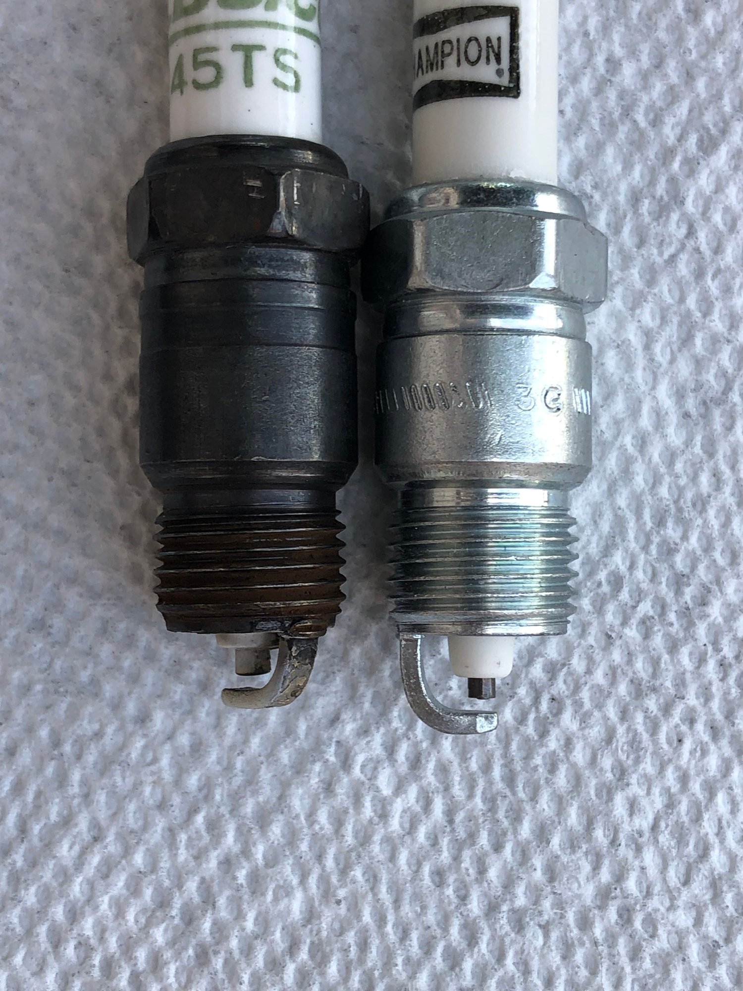

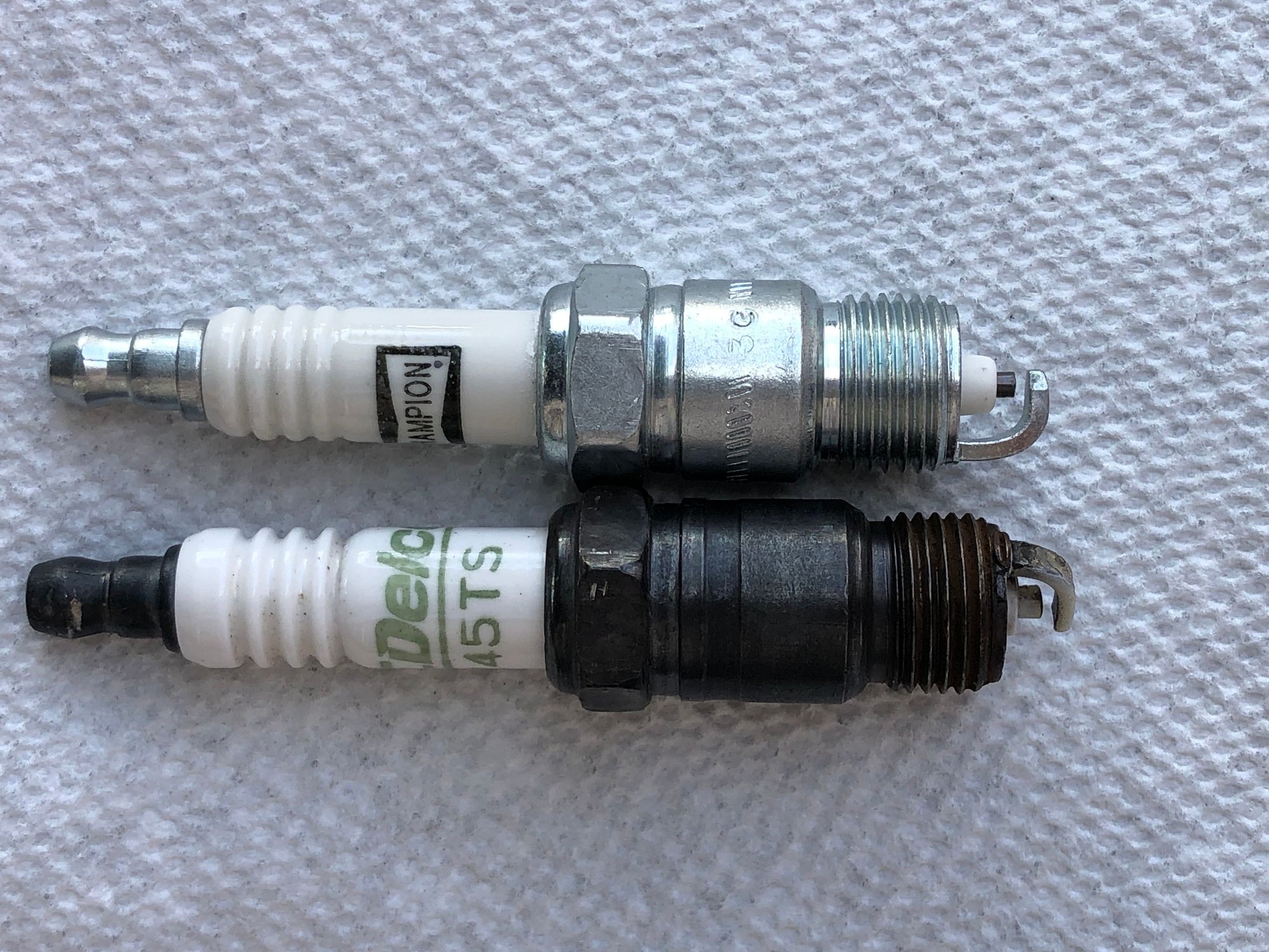

So I just pulled one of the spark plugs to inspect it. It’s an ac delco R45TS,it doesn’t look bad,but when comparing it to the champion 3018 platinums I noticed the electrode seems to be longer on the R45TS.
i triple checked the plugs before I bought them to make sure they were correct for this application. Why is there a length difference and does it matter? I’m thinking maybe it’s the wires and not the plugs causing this,still have to check the cap and rotor. It could also be two bad coils as the other poster said.

Supposedly the plugs were replaced about a year ago. If this were a plug or cap or rotor issue why would the car run smoothly for minutes at a time and then just off and on when it wants to miss? Wouldn’t it be a full time deal?

Those things are never bad things to change IF they need changing,but there’s also no point in throwing away money replacing parts that aren’t bad and have plenty of service left in them though,hoping to fix a problem through process of elimination.
As I said previously,I replaced the cap and rotor last November. I haven’t driven it enough to wear those parts out,but I will inspect them since they are modern Chinese auto parts. I have new plugs and wires to put on,But supposedly the plugs were replaced last year,guess if it’s not those things I’m back to it being two bad coils in a row.

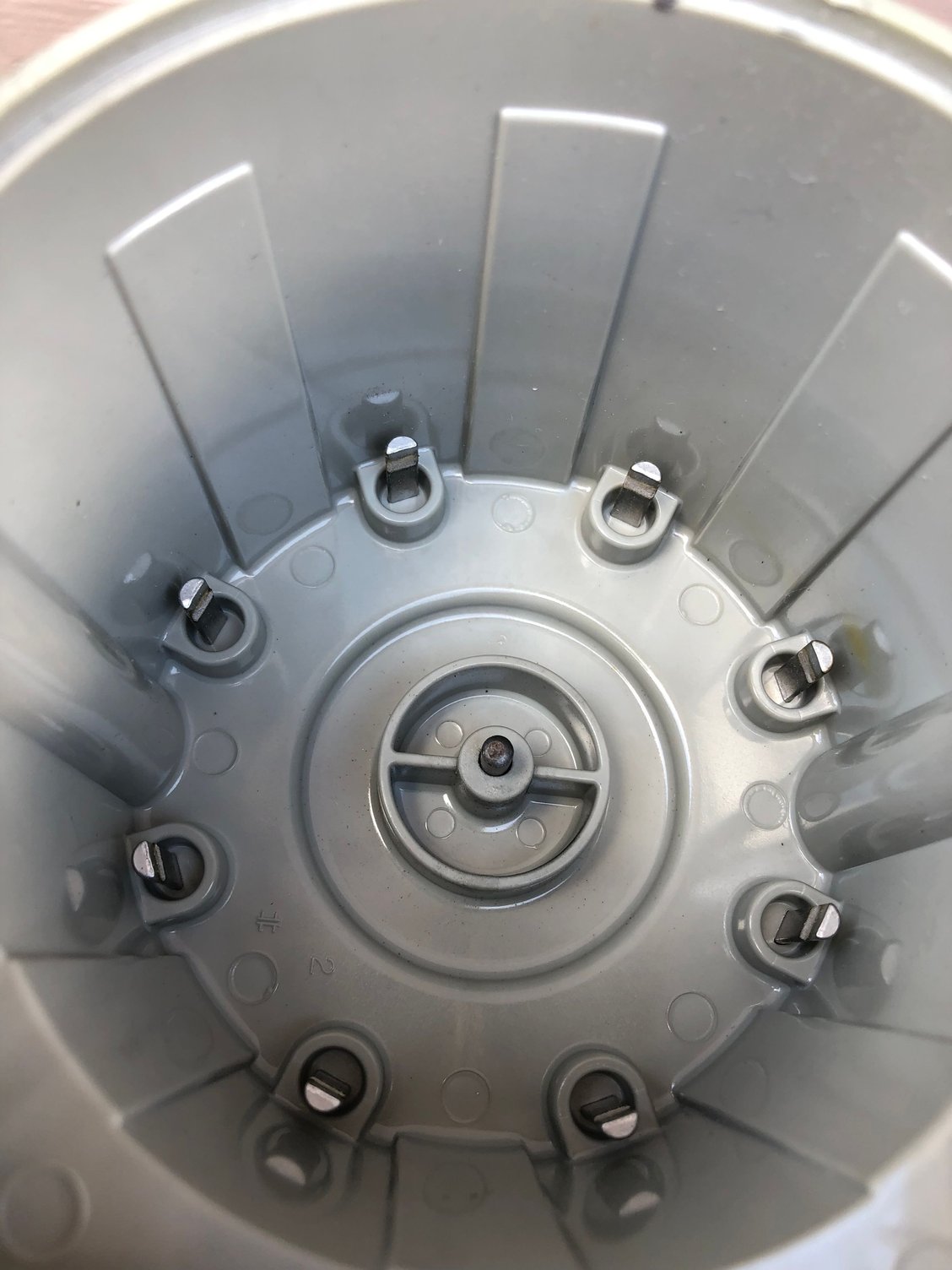

Please don't be offended Jim, but why are you so adamant about not changing the cap & rotor?
NEW does not always mean GOOD! A spark plug can LOOK good and never fire - or intermittently.
The rotors for the small body distributors commonly arc out to the center mounting post (carbon tracking as OrangeBird describes in post 11). Yet the rotor LOOKS good. When you finally solve this, I think you will learn this.

I've changed quite a few spark plugs over the years that looked fine, but were internally damaged in such as way as to completely or partially malfunction. Remember they have resistors inside them. Things can be cracked that you can't see.
Age of the components has nothing to do with logical problem solving. You must let go of those crutches. Approach the problem as if you had no bias - no idea how old anything is. Test, verify, then replace. Getting hung up on "I just replaced that 6,000 miles ago!" will not solve this problem for you.

Moving forward,can anybody here tell me if I need to be concerned about the difference in the electrode length on the champion plugs I bought vs the old ac delcos in the car? I posted a photo above

Well almost for certain those Champion plugs are going to be a much higher heat range. I don't see them not functioning but I wouldn't be happy about the difference. I used some Accel shorty non-resistor plugs on my LB9 and as far as the electrode section is concerned they looked just like the AC Delco plugs I took out.
As a rule I haven't used a Champion spark plug in..... well since the last time I had to change a plug in a lawn mower and that's probably been 20 years. Mostly I run NGK's in everything but for the GM's I usually get AC Delco. But for my 86 Trans Am I went to the Accel shorty plugs for clearance on my Dyno Don headers. They work excellent for me.

Thanks for the info and advice. I wanted to buy AC Delco plugs for the car,but they didn’t have a platinum version. I settled on the Champions because they were made in USA and platinum. the platinum plugs supposed to last much longer than the copper core plugs. Should I avoid any platinum plugs for this car then? I can go back and get the delco plugs tomorrow. Did the delco plug I posted look bad? All 8 look the same. I was told they were replaced before I bought the car.
Are autolite plugs good anymore?

I would just get the AC Delco plugs. The copper plugs should last about 30k. But appearance doesn't mean they are good. The stock plugs are resistor plugs so they have ceramic resistors inside that you can't see. These fail a lot more often than the non resistor plugs.
I have pulled plugs that looks absolutely perfect. But intermittently misfired. Unfortunately you can't go off looks.

Inside of cap and rotor that I installed a year ago. No burns or wear
