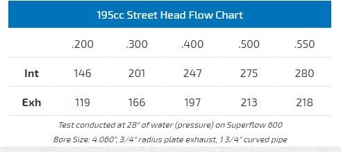

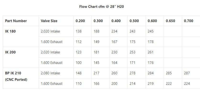

I'm back. I've been doing a little bit of research. I've been looking at Brodix IK180's. The AFR's are a little bit out of my budget (i'm 17). I've been reading 195's might be a little too much for a street 350 and 180's would create more low end power. Does that sound about right? I want more low end power since this will be on the street 100% of the time.

The 276 makes peak HP in or around 5600. At that RPM I'd say the difference between a 180 head and a 195 head wouldn't be earth shattering. But give the 195 more air with a bigger cam, then it's a different story. The 276 max output would fall on the lower side of 400.
The 276 idled well at 800 RPM, made 12-14" vacuum, Lope was minimal but still there.
The XR288HR idled at 875 with 9" vacuum. That was in a very tired shortblock. Lope is obvious. I tend to use a lot of idle ignition timing and have managed to get this larger cam to behave. It also drives well on the street.
Between the two, the 276 I'd shift at 6000-6300. The 288 raised my shifts to 6500+. Interestingly, performance was roughly the same although I think the state of engine with the larger cam wasn't giving a fair representation of the the potential there. Both engines had a 180cc (+/-) head.
I would imagine the HR282 would be somewhere in the middle.
If you want a clearer idea of the difference between the IK180 and the AFR195, look for flow results. Preferably from one testing facility. For low engine speed torque production, look at the flow values at lifts below.400". What the heads flows at.100" has a significant impact on the low end power that's been talked about. The AFR has a reputation for a "cake and eat it" head. Despite the larger runners, there doesn't appear to be a great deal of low lift flow sacrifice, I haven't seen the two flow sheets side by side but it would be interesting to see. I'd check out Stan Weiss' website and look for results there.

The 276 makes peak HP in or around 5600. At that RPM I'd say the difference between a 180 head and a 195 head wouldn't be earth shattering. But give he 195 more air with a bigger cam, then it's a different story. The 276 max output would fall on the lower side of 400.
If you want a clearer idea of the difference between the IK180 and the AFR195, look for flow results. Preferably from one testing facility. For low engine speed torque production, look at the flow values at lifts below.400". What the heads flows at.100" has a significant impact on the low end power that's been talked about. The AFR has a reputation for a "cake and eat it" head. Despite the larger runners, there doesn't appear to be a great deal of low lift flow sacrifice, I haven't seen the two flow sheets side by side but it would be interesting to see. I'll check out Stan Weiss' website and look for results there.
http://users.erols.com/srweiss/tablehdc.htm
I’m gonna build a 383 when I have the money. Right now the 350 is a good fit. I’ve never driven a car above 300 hp, so I think this will be a starting point.
Would the AFR195 and 282 work well in a 383 or is that pretty mild? I know the 383 is still a 350 with a longer stroke, but I don’t know how these parts would react different with more cubes...

If the plan is to build a 383 eventually, go for the 195's now. While you build a small headed 383 (as I'll being doing when the next shortblock is ready), there are other benefits other than outright power the 195 can offer to the 383 as well. Streetability being one of them.
The 383/195/282 combination I'm sure has been built many times.
FWIW, seeing as you're starting out (at 17), if you can afford the 195's, get them. Then it's only one set heads for both. By comparison, camshafts are cheap.
In the same vein, seeing as you're just getting into this , the 350 with AFRs and the 276 will give you what you said you were looking for in the first place and also give you some relief from the carb and ignition tuning aspect. The 276 is more forgiving in that regard. And it's been said many times, when you have the choice between two cams, pick the smaller one.
