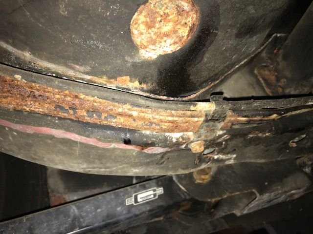

Well my intention was to replace all of the fuel lines front to rear new aluminum hard lines and PTFE braided lines because the stock lines are rusted to the point that I don't trust their gonna last long. I'm not apposed to keeping the a factory style filter, I would have to come up with a way to connect the stock filter to AN fittings.
You can buy new stainless steel hard line at Classic Industries. I replaced the hard line front to rear, both high pressure and return. Had the short run from the tank to the filter, and from the filter to the front of the car. Then the return of course.
