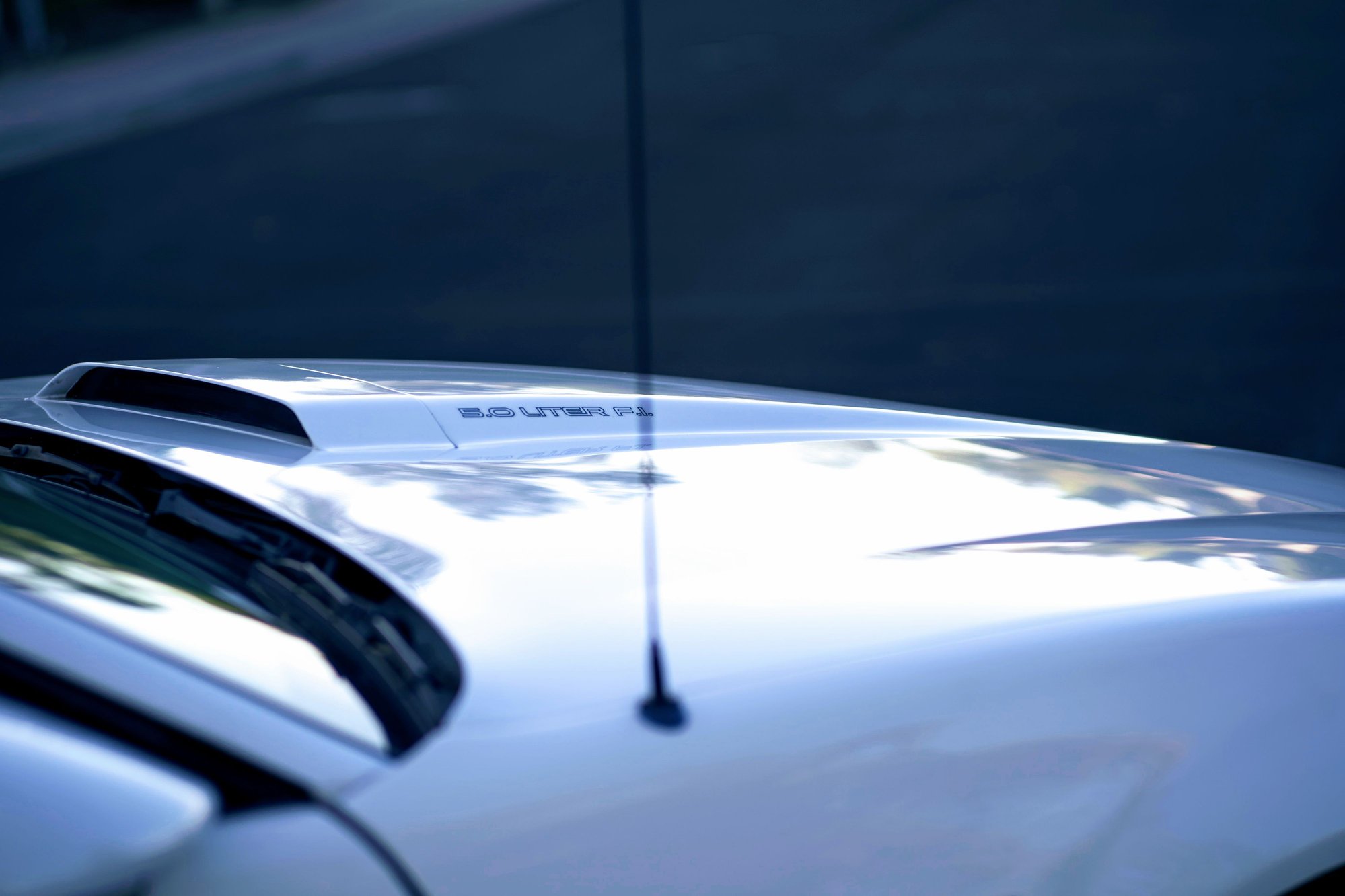

If there's something I hate it's fake air scoops, fake everything in fact... What's the point? I love American cars but the majority of them from the muscle car era and all the way up to the 90's have fake air scoops, what the heck, may as well inject saline into your biceps and walk around pretending you're strong. The thing is, I've always wanted this car specifically because I like the way the induction hood looks, I know that back in the early 80s (82-84?) the Trans-ams had an HO engine that actually had a functional hood scoop but my under 20k mile 1990 formula of course had the usual blank off plate fake nonsense... So what to do?
From a distance it looks okay, but up close it's pretty obvious that it's just a cheap and useless shadow of a former feature that this car never had (nice from far, but far from nice!). Enough, I had to make a plan! I started to look at photos of engine bays online and to my surprise it looked as if it would take little to no fabrication to get this cold air setup to fit on my weaksauce 305 TBI, here's a picture of my engine bay:

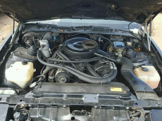

And here's a picture of a random internet search showing a functional induction hood setup:
To my eye it looks like if I could just get a hold of the air cleaner and the hood scoop bits I could just bolt it right in, so I went on ebay and spent a stupid amount of money buying an old but complete set:

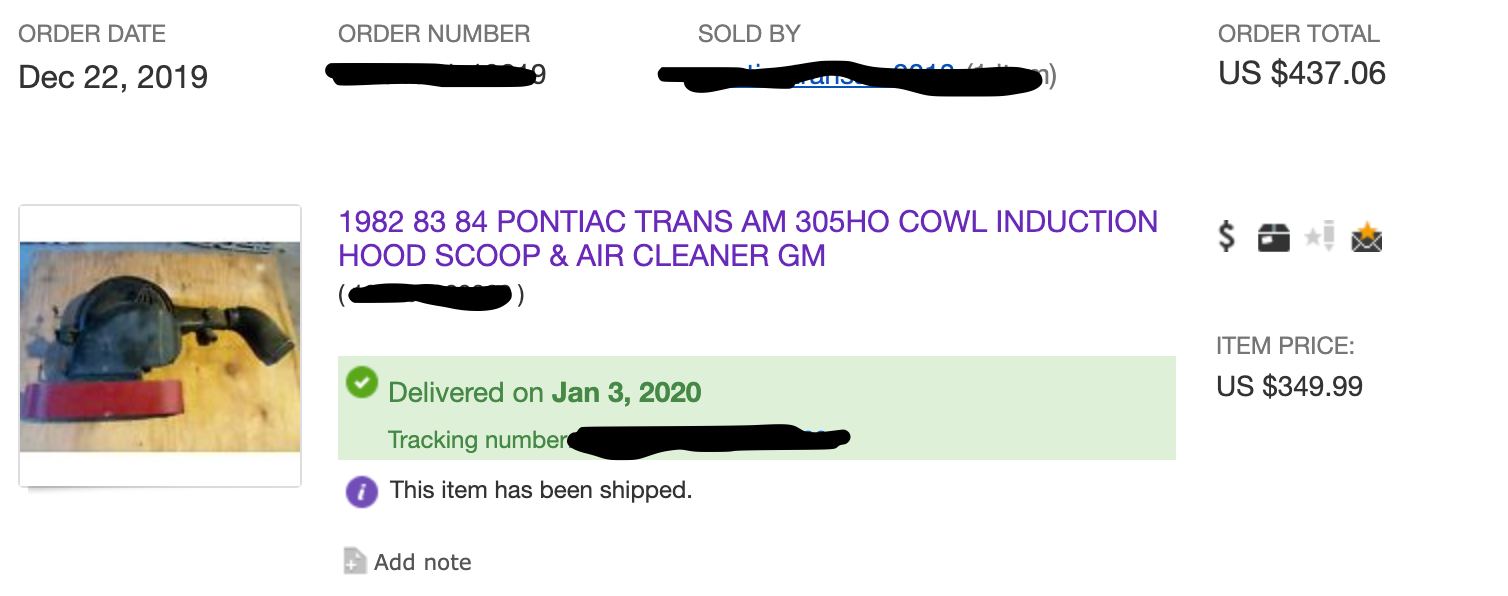

Sooo, yeah, $440 for a gross old box of rusty bits, but it was all there!

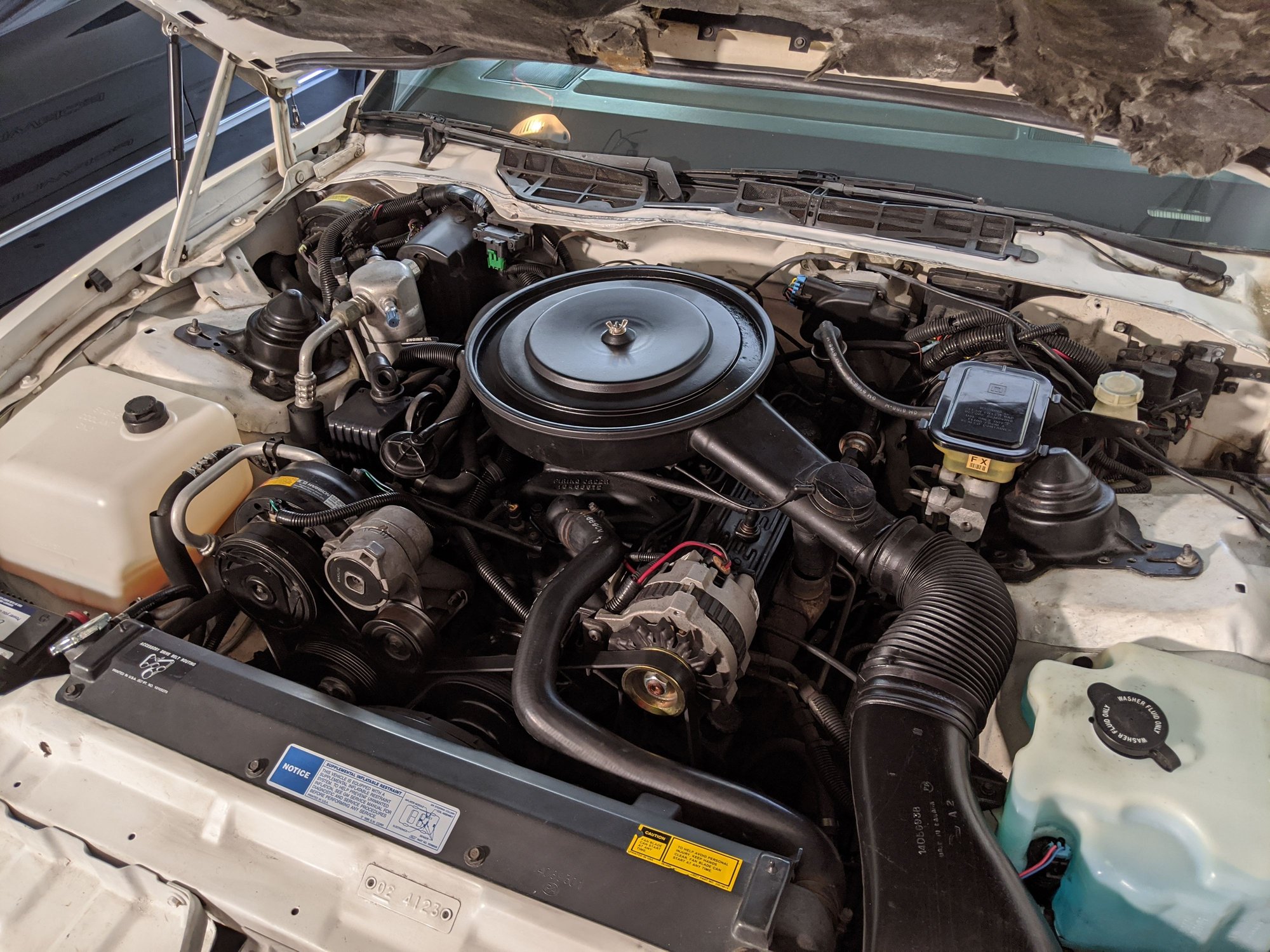

I started by mocking things up, turns out the the air cleaner housings are almost identical! (the original cowl induction one has a slightly different vacuum tube setup since the older engines were more primitive) so why replace the whole thing I thought, let's see if the lid fits... and sure enough, the lid fits with absolutely no modification other than having to use a nut as a large washer to fasten the wingnut down... Awesome, let's clean it up! (I will be at some point giving it a proper sand blast and re-paint, but I'm too excited to wait):

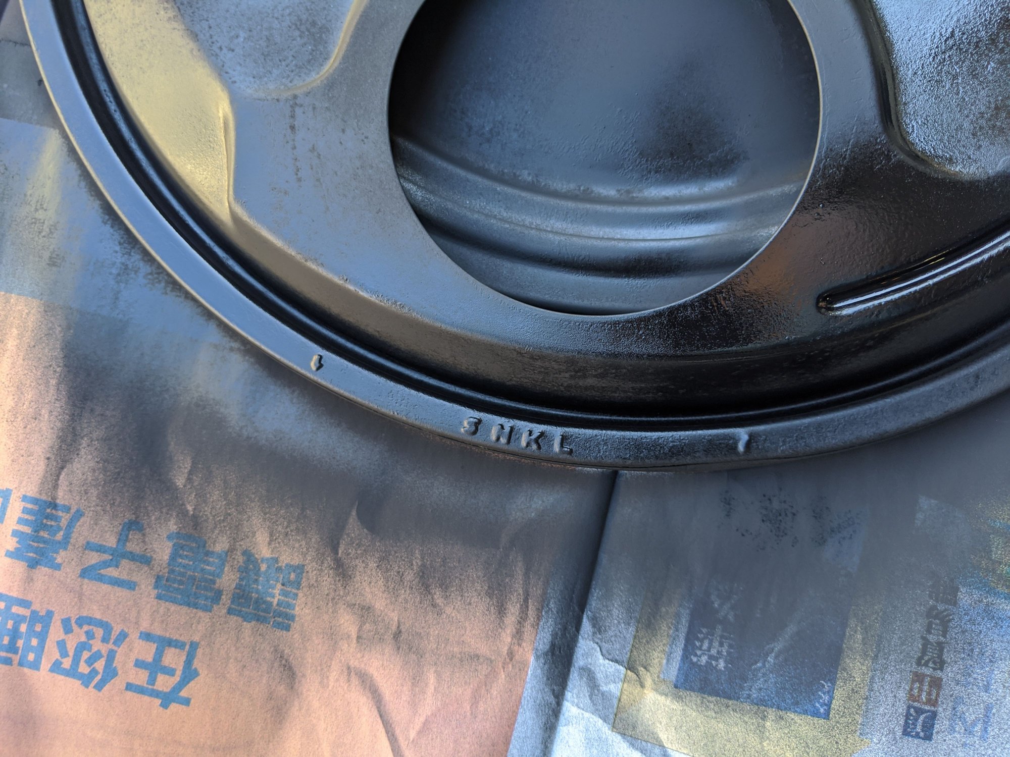

A bit of wire wheel later and some header paint (high heat) and it looks way better!:
More importantly I can actually make out the directions on how to mount this properly, it has marks to tell you where the snorkel of the air cleaner should be in relation to the lid (I couldn't see this before because of all the surface rust and flaky paint):

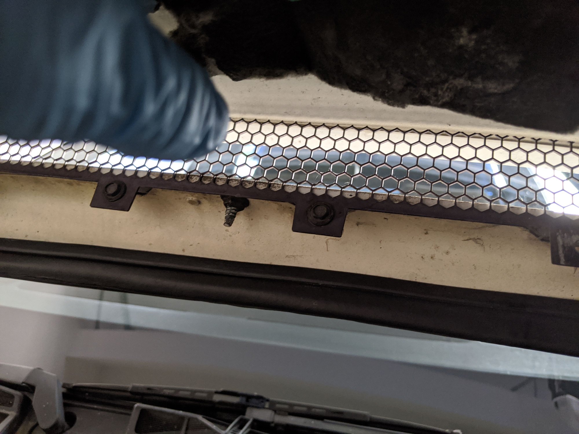

Next step, remove that lame blanking plate from the hood, easy enough.. four bolts, I took the ebay hood scoop thing apart and first installed the chicken wire looking screen (only attach it by the two inner bolts, the two outer bolts attach the actual hood scoop unit and also mount the drip tray)

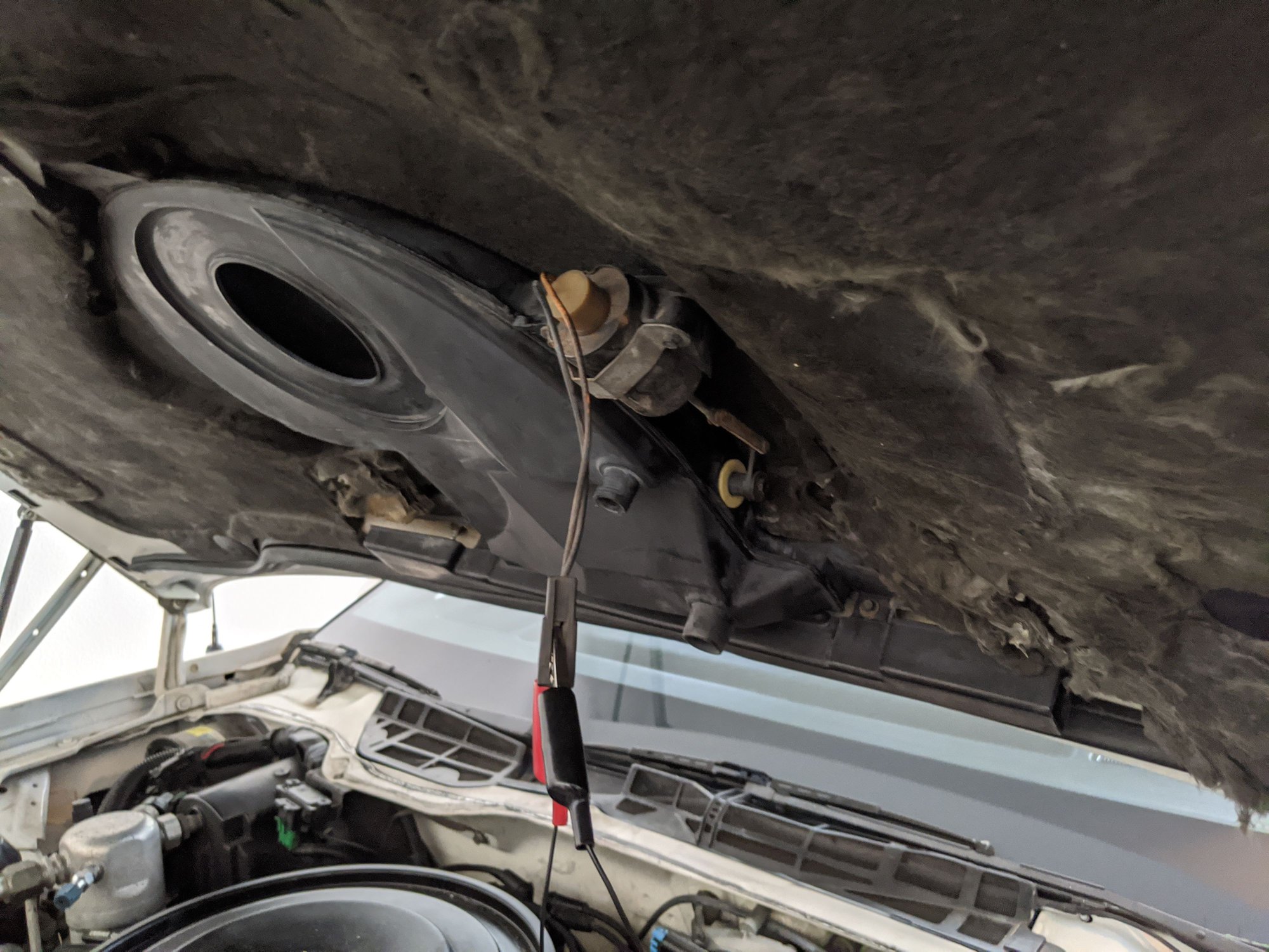

Next of course was the whole hood scoop assembly (once I had cleaned it up and looked for cracks (no cracks surprisingly) and even more of a surprise is that all the mounting points and holes are actually still on this hood even though it was never meant to see a functioning scoop, so happy days it bolted right in!
Here you can see I have some test wires hooked up to the actuator motor and yes if I supply it with 12v the actuator opens the door, allowing that sweet sweet cold air to flow in... this could be a cool party trick at a later stage, I could install a switch to "activate induction" or some such nonsense, but to be honest, why would I want it to be closed anyway? I live in California, it's not like it snows or gets too cold or anything so I just ended up tastefully jamming it open with a discreet cable-tie.
with everything in place and the lid now on aligned as it should be according to the markings, I stuck a go-pro under the hood and slowly closed it to make sure that the rubber grommet was indeed sealing up and contacting where it should and again to my surprise it was! How is it possible that this conversion would be so easy? I've never had anything work out this way... Now time to test it:

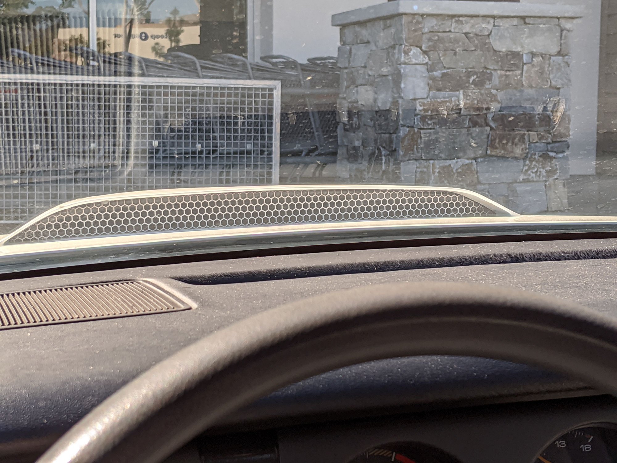

The screen should be black FWIW. The anodizing or whatever coloring fades in the elements, that's why the other surface of the screen is black. Kinda looks cool in bare aluminum, but OEM OCD bugged me every time I looked at mine before repainting it.
You can always get a vacuum operated switch and wire up the solenoid to kick on when vacuum drops (aka WOT). Biggest issue I'd worry about is the monster 70's tech solenoid deciding to burn down.

I suspected as much! I'm pretty happy with the aluminium look but I may paint it black as it was intended in the future, the idea of a complicated way to make my engine breathe better rather than letting it breathe better all the time is not very appealing, I'll look into it if I find a need, but for now she breathes better and runs better and all round is better so I'm happy and can enjoy my beer better than before!

Winston I solved that issue. I used a rubberized flexible toilet gasket, yes that's right. I also had to hand fabricate the air cleaner cover because I just could not find it anywhere, Here are some photos of my set up. The cap and gasket were adhered together with Gorilla glue brand heavy duty construction adhesive. Our cars are not "Worthless whips", cheers!
TBI lid cut for air flow.
TBI lid refinished.
Cap for the air cleaner before the circular hole was cut for the gasket.
Air cleaner cover finished with gasket installed.
Installed 100% functional!
