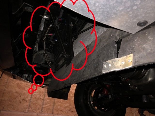

Now the engine bay is extremely clean and has less clutter. Will post pics soon... BUT something in my mind is telling me that I should looking into a proper oil cooler considering the high temperatures we have here in Malta especially during summer, the fact its a transam (i.e without any front grills) and the fact that GM engineers thought of putting in the water-to-oil cooler.
So I found a British brand called MOCAL who have SBC sandwich plates (SP16 http://www.mocal.co.uk/products-octakeoffs.html). They also have ones with thermostat but I don't see a point of that due to the size of the radiator I intend to put and again the temperatures we have here.
My question is related to the effectiveness of this air to oil cooling system. I can quite practically place the oil cooler radiator in the opening of the front air dam but the oil cooler size would be the 10 Row with a 235mm matrix (see http://www.mocal.co.uk/products-oilcoolers.html).
Its not huge but it is the only one which I can fit without radical modifications to the front. See picture of a mock up:
Mockup of Oil cooler placement
I measured the length of the lines that I would need and they would be circa 2 metres each way (4 metres in total). Hoses are normally 1/2" or 5/8".
Can I have your views on the potential effectiveness of such system considering the size of the rad, the placement and the length of the lines?

All you need to disassemble is the filler panel between the nose and the core support. that will give plenty of room to work from the top side OR you can lay on your back or put the car on a lift and do it from below.
I have had this car apart MANY times so it's easy for me to say "that it is not a hard task" but I can't assume everyone has the same experience.
Personally I would not put a an oil cooler where you have it mocked up... that close to the pavement with the majority of the cross section facing towards the ground is asking for trouble if stuck by debris..

Well i am surely familiar with the inner workings of this car. I completely built it from the ground up (my build thread is on here) so I know what you are saying re. Removing the upper filler panel. Still this panel is not just a filler. It is also holding the nose in place and as i have all the gaps properly aligned i wouldn’t like to disturb. ThereWould also be the canopy to remove to reach from the top. I have a car lift so might be able to do it from the below.
You are right about debris. I honestly didn’t consider that aspect..
What about effectiveness with a cooler of the size I indicated. Do you guys think it would be enough? I mean it surely is better than nothing but wouldn’t like to go thought the hassle and expenses for nothing.
