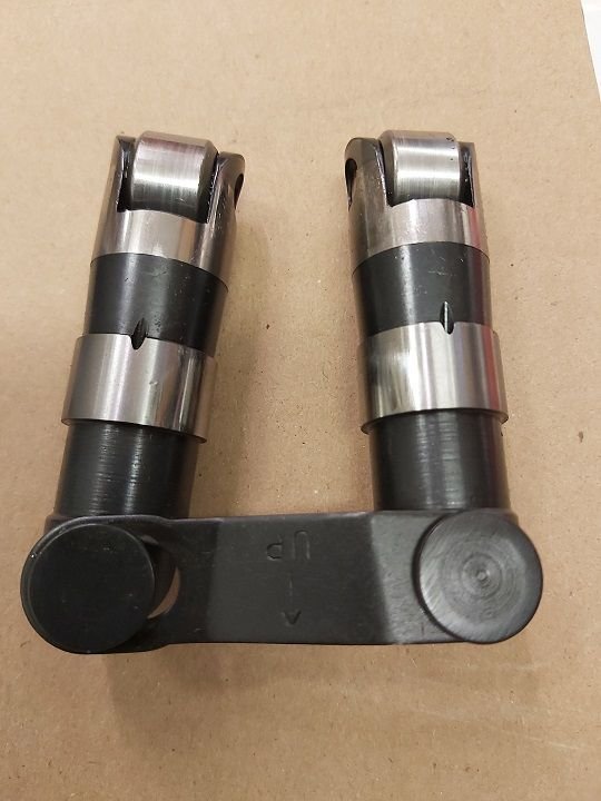

Is this what you mean by Link-Bar Lifters?

Yeah retrofit lifters

Yes.
They have been known as "retrofit" since the factories (since all of the OE mfrs use similar setups) introduced their thing. Before that they were simply called "roller".

These are for big block but small block ones are the same except the link bar doesn't have the bends in it.
Somehow, there has to be a method of holding them from turning; the roller axle MUST be kept parallel to the cam. REAL BAD things happen when the lifter body rotates away from that orientation. The factory uses those "figure 8" things, with the flats, in the 87-up small block. LS motors use "trays" that look and act very similarly. Back when blocks had no provision for any of that, this is what we did.
Come to think of it, LSx "trays", along with maybe rev kit parts or the like, could possibly be used to "retrofit" older blocks. Never seen or heard of it, let alone tried it; butt maybe it could work. Hmmmm… maybe a good coronavirus shelter-in-place project... Although, even in the LSx motors, once the lobe lift exceeds some certain point, at which one lifter being pushed up by the cam would knock the tray off of the other one, the link-bar type is all that can be used. But for a mild street build, on real small cams with lobe lifts below .400" or so, just maybe.
