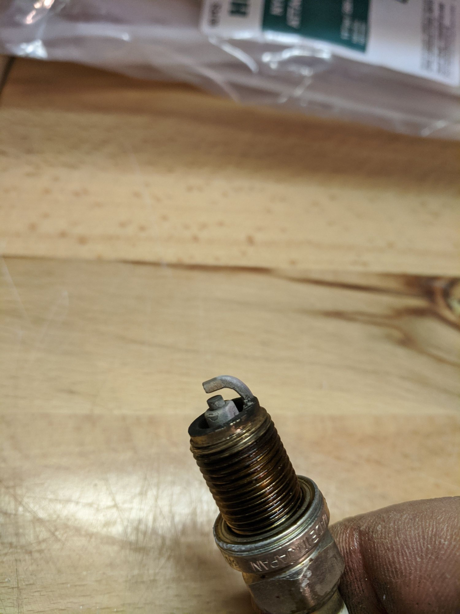

-i have pulled a spark plug. their not worn. look normal. slightly white on tip on plug but no much. look normal

(attached photo of spark plug for reference)
spark plug photo for reference

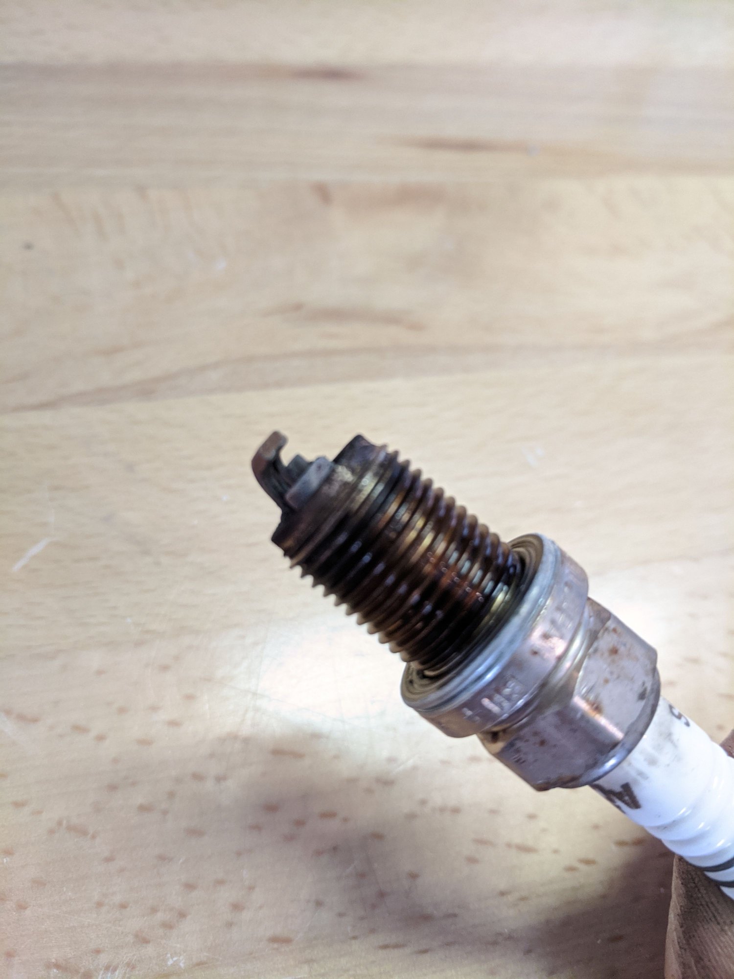

Decided to pull another spark plug today. Just because. Here is a close up of it.
It's definitely due for replacement.
Thoughts on how it looks.
Plug ground is very white/greyish. Electrode is more greyish in colour . Plug was not wet but appears to have dry soot spot on the base of threads.
Reply 0

IMO, if you are not doing the wires, cap and rotor you are probably still going to keep on misfiring. The small cap HEIs are particularly sensitive to cap and rotor quality and condition. I used good wires and a quality cap and rotor. Even then my old G-van used to start missing about every 20-30K miles. Change the cap and rotor and it would stop. Wires with excessive resistance will play a big part in eating the cap and rotor. You could really only ever notice the misfire at low rpm and high engine load...aka cruising in OD. It did not seem to care about what the plugs looked like as long as the gap was not bridged. I actually swapped to a large cap HEI with an external coil to rid myself of this problem.
