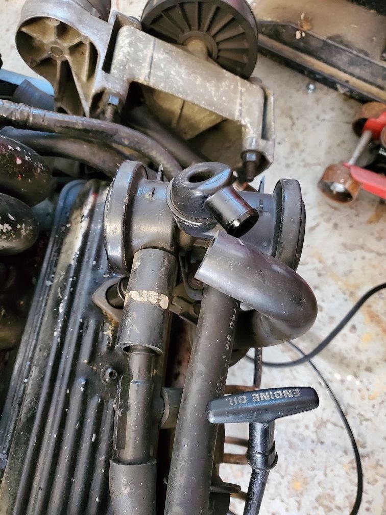

Before I start removing items off of this engine I got, I need to make sure that I am removing just smog pump related parts. So I have some pictures, please tell me if it is smog pump related. I already know what the smog pump is on the bracket, I'm planning on gutting it so I don't have to find and buy a pulley. And what size bolts do I need to get to plug the holes in the exhaust manifolds?

Yes

Yes
Thank you. Anyone know the size of bolts needed to plug the holes in the exhaust?
