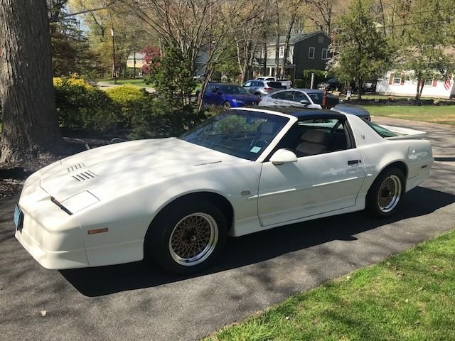

Hi, I am in dire need of some help as I am baffled and lost. I have a 1987 GTA I am the original owner car has only 11,000 original miles. Car has been my baby for 33 years. The issue I am having has been going on for a few years. Car runs great, starts right up drives like new, but after bringing the car up to temp driving it around then turning it off and letting it sit a bit is where things go bad. The car restarts perfect and drives then 5-15 min into driving the car it looses all power and you have to pull over or it will just stall out. I let the car sit only 2-5 minutes car starts right up and runs fine again Car is 100% stock 100% original no mods, never raced, here is what I have done to the car so far.
Dropped and flushed gas tank and replaced electric fuel pump that went bad (unrelated issue) I was having the power issue before and after fuel pump replacement.
New spark plugs, new cap and rotor
New gas filter and air filter
New OEM Bosch MAF sensor as I had one.
New engine Temperature sensor (upper front of engine)
I really thought it was my catalytic converter that might have been clogged so I replaced that with a Magnaflow cat.
But nothing worked, like I said car looks and drives like it did in 1987 but if I go to a car show I will no doubt break down on the way home.
Everything else is original other than fluids, I really need some help here as you can see car still has the dealer inspection sticker from 1987 in the front window. Thanks in advance!
