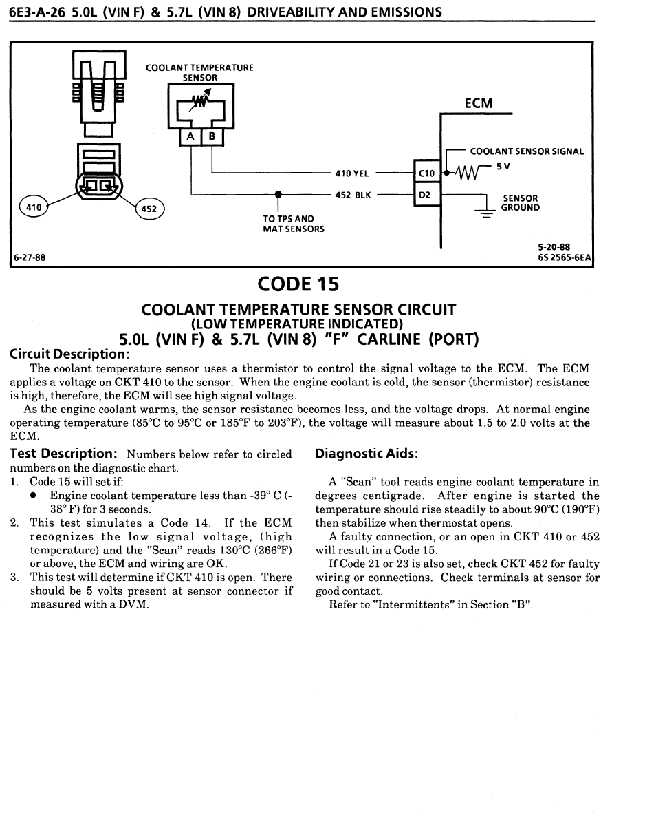

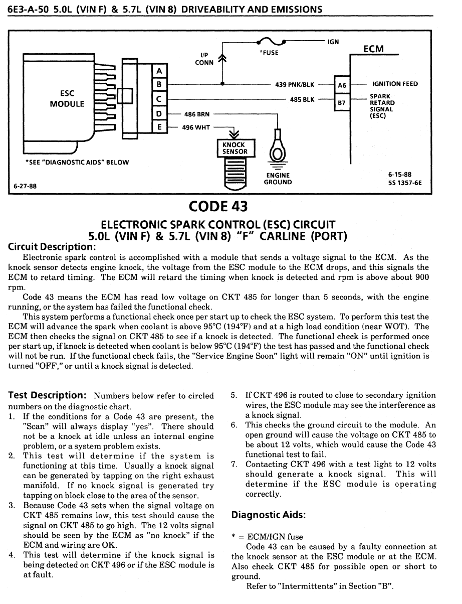

43 is the ESC
15 is Coolant Temp Sensor for the ECM it's under the driver's side exhaust manifold. Without this working right, the engine will not run well.

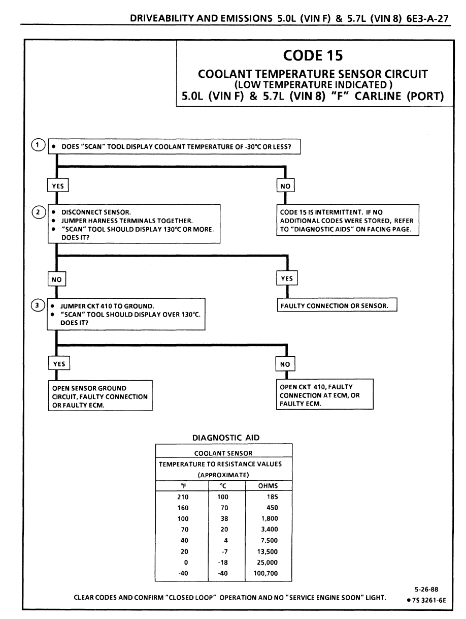

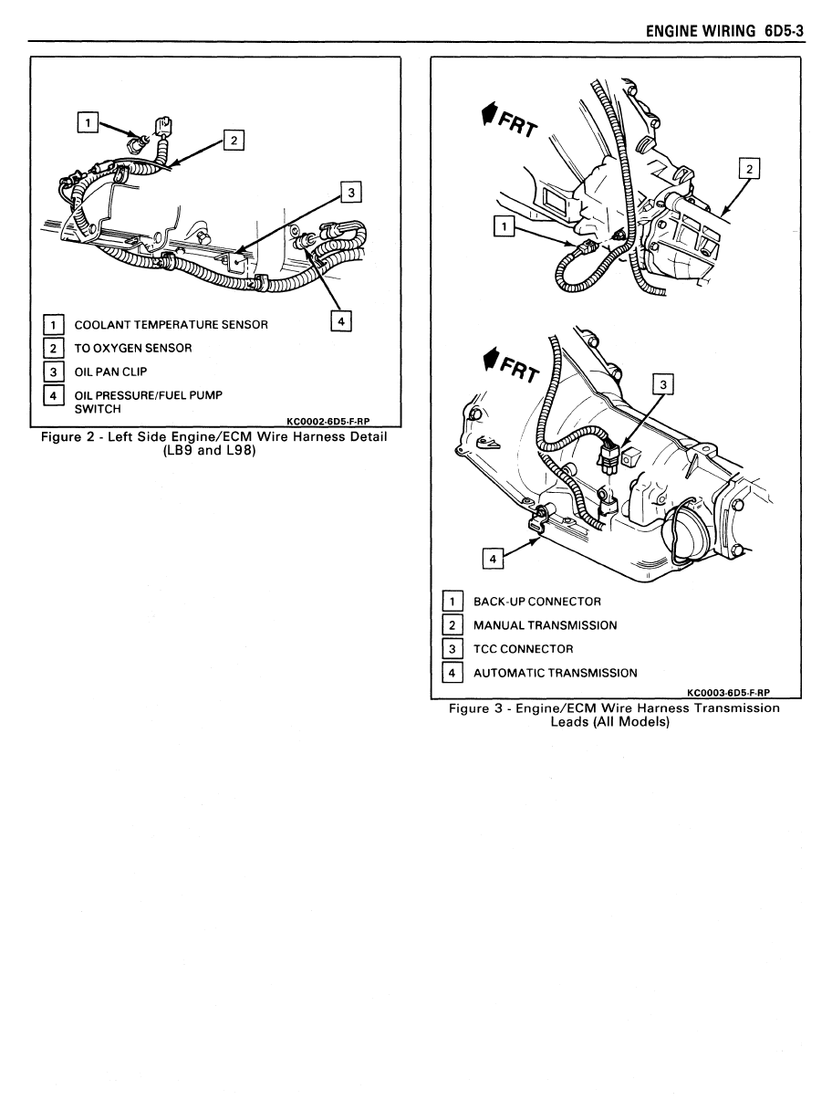

These will help:

The knock sensor might be incorrect. You can ohm at the at esc module unplug and measure from d to e.
if correct knock sensor should be 100k.
