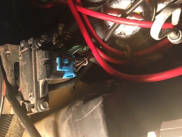

What is this???
Hi,
I was under the impression that my irocz had aN electric fuel pump. I just read in the manual that it has a mechanical pump which I can?t find anywhere in the engine bay. I only see this in pic. The manual also say that some cars has ?special type of pump? . Is that what the picture below is?
any help appreciated!
Bracket with the blue in it
also I had an engine swap but No fuel pump swap that I know off.

Re: What is this???
Baro sensor

Re: What is this???
thank you! What’s the function of this?

Re: What is this???
If you went to non computer controlled carb and hei with vacuum advance it not needed.
It use to measure pressure outside the engine to help the ecm calculate fueling

Re: What is this???
The baro sensor was an "enhancement" to the computer-controlled carb system.
Remember: "vacuum", the best indicator of engine load and driver demand available, is the DIFFERENCE IN pressure between the ambient pressure, and the pressure INSIDE the intake manifold. A MAP sensor (the one that looks basically the same but is over by the brake booster) gives the ECM the pressure INSIDE the manifold, but if it doesn't know the TRUE ambient pressure, it still doesn't know the vacuum; if the ambient pressure varies, the MAP will vary along with it, and confuse the signal. Not a big deal if you stay at sea level and the weather never changes like if you're in San Diego let's say, but if you live in Denver and drive much outside the city, it can be a YUUUUUUJJJJJE factor.
The baro sensor wasn't supposed to have a hose. It belongs exposed to the world at large.
But if you no longer have the computer controls on your car, it's not needed. Nor is the MAP sensor, O2 sensor, coolant temp sensor, knock sensor, etc. etc. etc.
The mechanical fuel pump is on the side of the block, down low, pass side. Has (or had) 2 rubber lines and one steel.
