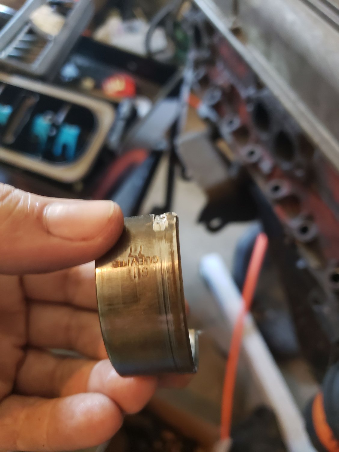

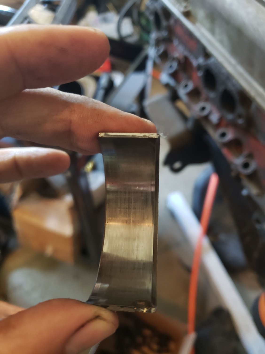

i pulled the first piston out of my 355 and the locating tabs on the rod bearings are pressed flat.
I just wanted to know if that is normal.
I am attaching some photos. Should I replace these bearings or leave them.
engine has about 1000 miles on it since the full rebuild.
Thanks,
Chris

No that is not normal.
Looks to me like they spun.
Yes, replace them.

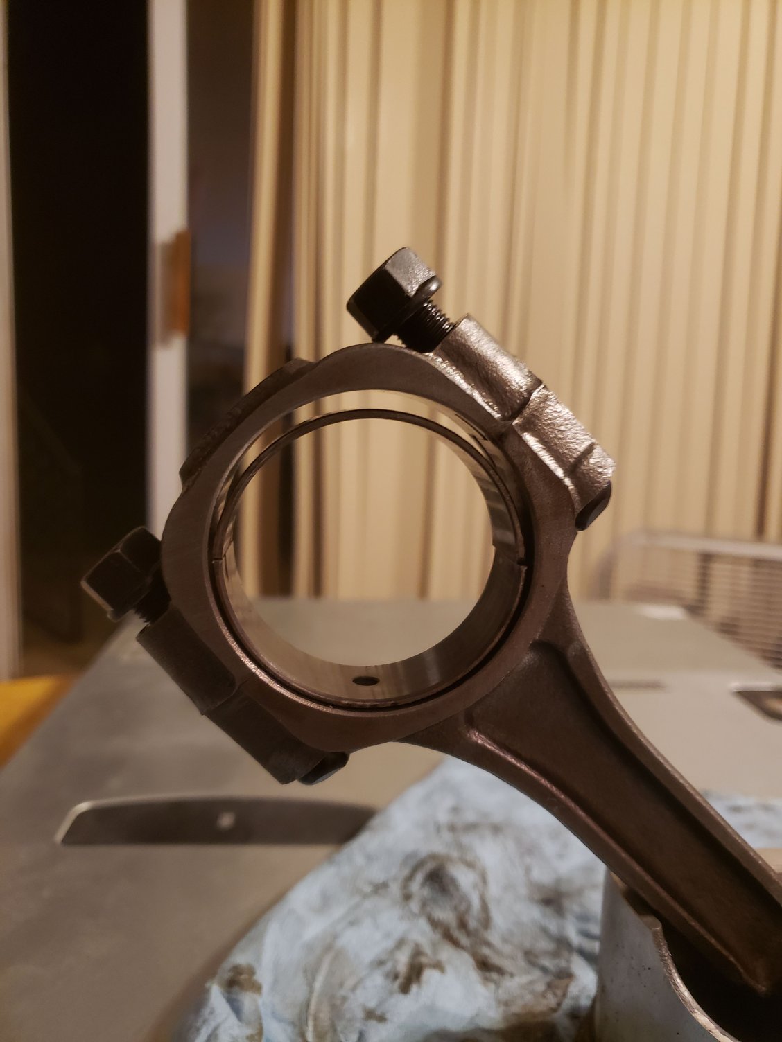

crank looks good and rod looks good.
I measured the crank journal and it is 2.08" so I should need a +.020 bearing set, correct?

Theoretically, yes. but please post pictures. Something is not right here.
Measure the mains bore, the rods bore, and the mains & rods journals.

i ordered some new bearings. I think the problem was that i didn't get the correct bearings last time. I plasti-guaged them so the thickness was correct. but the diameter is not. there is about a 1/8" gap between the ends of the bearings. I think this contributed to the failure.
thanks,
Chris
IDK how, but you should consider yourself lucky that this engine ran for even 1 mile.

That's basically ... impossible. You'd have to have a small-journal 327 crank or rods for some other kind of motor for that to happen. Or of course the wrong bearings.
They're supposed to be a "crush" fit into the cap. That's what retains them. Without that, you get ... what you got.
2,100" is the nominal dia for a 350 rod journal, so yes, +.020" would be correct. 2.225" is the inner dia of the rod. Measure it to be sure. Clevite bearing part # should have 663 in it.

these are cb745hd .010
I find references to them being made for chevy sb and ford ...
this motor ran good and never knocked, but it was some oil...
I am re-ringing it too. I have an old mechanic that lives across the street. I showed him, and he said I was really lucky to not have any damage
SMALL Journal SBC .010" under
You better check the main bearings. They could also be for the small journal crank.
Just so you know, small journal cranks were used from 1955-1968.

Without actually seeing the rod bores, and with the bearing inserts spinning in them for 1000 miles, I would think that there would be damage.
I can't believe the inserts were not spit out.
