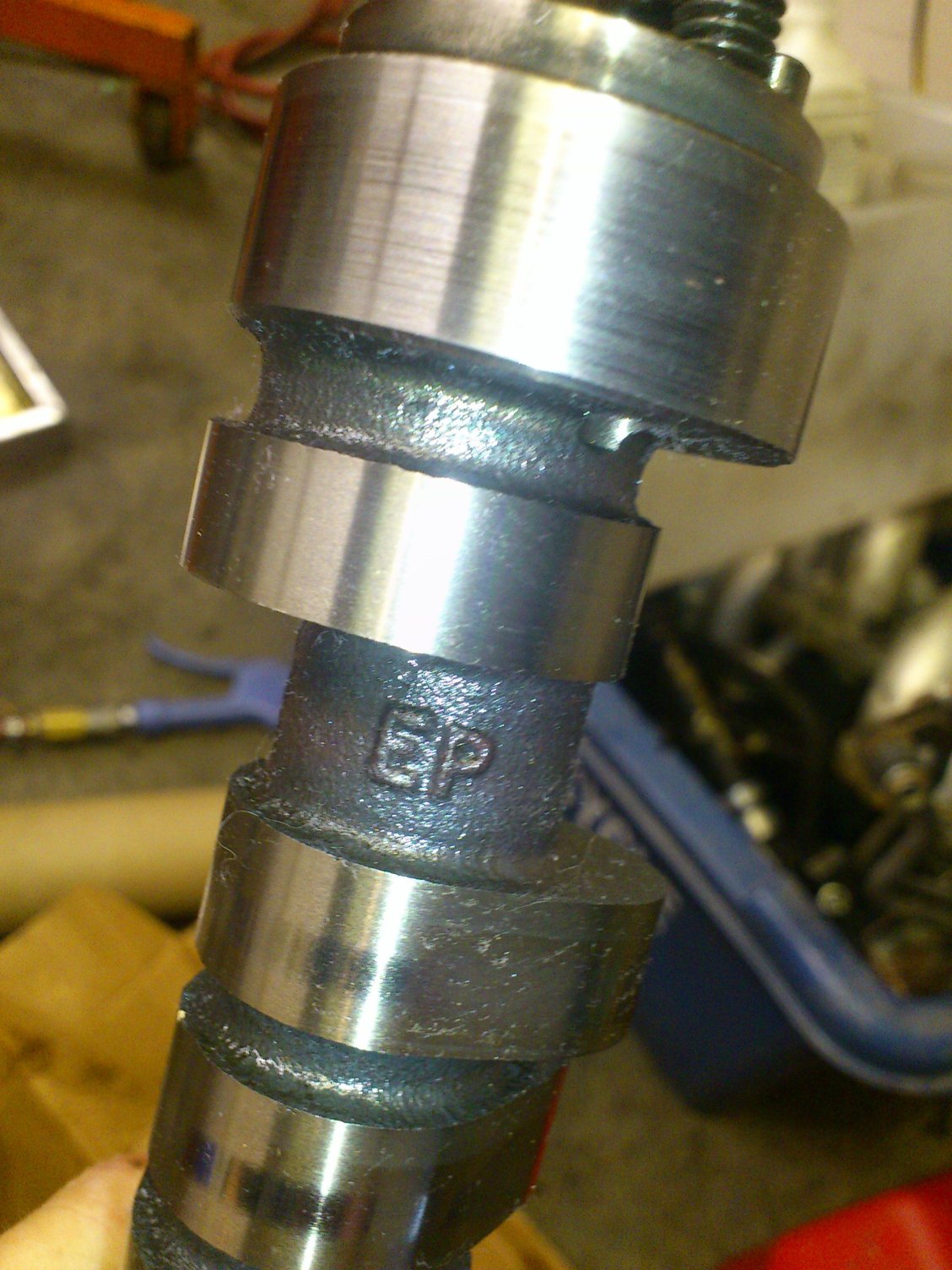

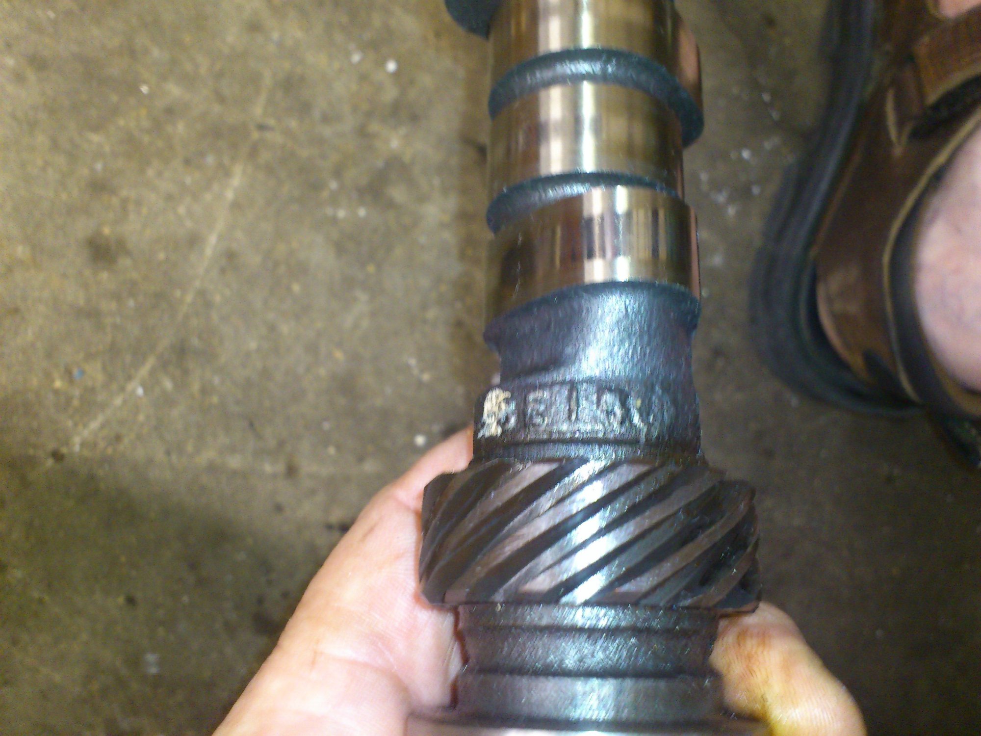

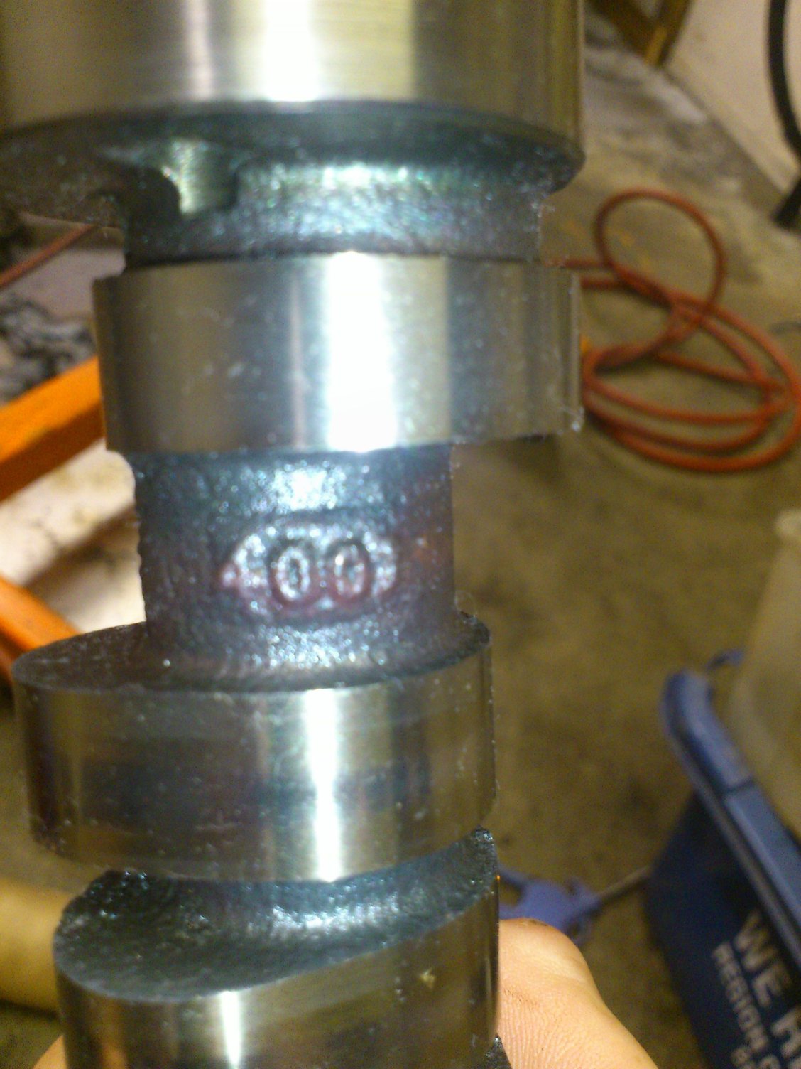

sofa,i seem to be a bit lost.for the life of me ,i cant make a new thread and hate hijacking other peoples threads.anyway, this is slightly related and your word is always intelligence based.a quick question,i just pulled a cam out of a 1988 tpi 350(5.7) its a cast core and has 4714YK and 1080R stamped on one end,im in the process of doing a cam swap but would like to i.d this cam if possible and dont have v-blocks and an indicator,etc at homer(im on holidays atm)
also says WF ?

1986, thank you for the kind words and vote of confidence, and I wish I could help you; but I don't know whose marks those are or what they mean. I know lots of marks but ... not those.
Measure across the flanks with a mic, and the height of the lobe; both int & exh; and I'll try to guess.

general disorder figured it out as a sealed power cs1080r roller cam its around 0.460 int/0.470 exh ,good for a mild 350,was in a tuned port 350.
