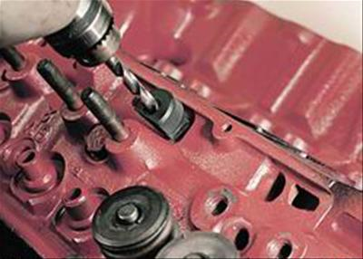

You do know that once you remove the valve locks (keepers) that the valve can now fall down into the cylinder?
You must provide a way to prevent this when doing this kind of work with the heads still bolted to the block.
You either have to shove rope in the cylinder through the spark plug hole, or use compressed air and an air adapter.

Lol yeah I’m not tearing the heads off for that screw up, my buddy has all the right tools for this and was going to help. With him and the FSM it shouldn’t be too bad
I've found the an old spark plug wire is GREAT for this purpose. Put some oil on a rag and wipe the plug wire first,.... makes it a bit easier to push it into the plug hole.
