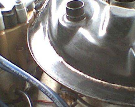

Hi rise RPM and Vic Jr intakes fit with the RIGHT GM air cleaner base:
The base of the air cleaner that was used in the 60's -70's on sbc and bbc muscle cars and vettes is what fits . The lids are the same.. electric choke may not fit. Throttle cable mount will need modding to lower it .
Aftermarket holleys will need the bowl vent tubes shortened. (angle cut them) qjet and eddy carbs fine.
Edelbrock carbs require the "banjo" fuel inlet fitting.
GM HEI requires a flat slice off the back of the air cleaner base to fit. Does not effect filter.
Source the Z28-L88-Lt-1-L-72 air cleaner base from chev restoration parts supplyers..
Find s f bird and camaro stock hoods with room to spare with hi and rise RPMVic Jr intakes.
This is the lowest base you can buy. It works.
GM sorted this all out in the 60's on big block vettes etc.
Trim a flat at the back of GM L88LT-1 base to clear HEI
