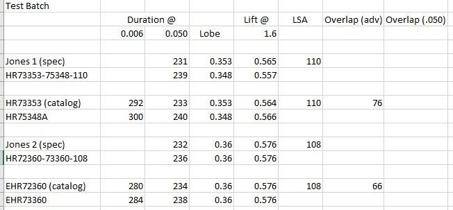

Probably the most difficult thing to convey to any cam grinder is exactly what the intended purpose of the vehicle is. My experience is that most will offer a general all around grind that have the typical broader flatter curve but less overall in output. Kind of trying to save you from shooting yourself in the foot so to speak.
Case in point was one of experiences with Jones Cams. Having filled out his recommendation request form , I received something that looked pretty average. Might as well have gone to COMPs catalog and picked one from there. It wasn't until after a couple of additional bits of correspondence that the spec become a little more refined and was more along the lines of what I was seeking based on what I'd seen be successful on similar platforms.
It's all in the details.
i see this all the time and i chuckle at times. When someone requests a custom cam and the .050 specs come back looking sorta like shelf cams or common numbers That they seen other guys run on the forums lol. So they question it and some cam guys will change spec to make it look more “custom” to safisfy the customer. Shouldnt you trust the input the cam guy gave you? Hes the expert else you wouldnt need to go to him. Just put together your own grinds. A lot of the times two cams can have similar lift and duration specs on paper but behave entirely different, especially jones cams with inverse radius lobes.
its good to closely discuss the cam design and behavior with your cam guy to make sure you are on the same page, but in the end its his experience and knowledge you are buying and should trust. My cam guy doesnt give me specs. I pay and cam comes with card, thats when i find out what im getting. My new bbc turbo cam is way different than expected.

Just to emphasize my point, check out this cam spec. It's in a 230 port cfm, dual plane, 10:1 350.
hydraulic roller single-pattern grind, with 224 degrees duration (at .050) on the intake and exhaust lobes, and 0.352 inch lobe lift, 108-degree lobe separation angle
I'll bet there are very few cam people that would deliver that spec. And yet that was almost 450 HP.
That's nearly 1.3 HP/CID.
Hard to beat and even harder to get spec'd.

Talking about project sledgehammer with its David Vizard spec'd cam? If so it had aftermarket Vortec heads that flowed around 250cfm.
While they were EQ aftermarket, as quoted from the text...
The intake ports flow in the neighborhood of 230 cfm

Here's a cam selection program I've used. Something of note in the two screenshots posted. The only change in the engine spec is the size of the intake valve. It's interesting to see how that little bit can change the end result. The larger valve tends to allow the LSA to broaden a little and less duration is needed resulting in less overlap for the same power output. Airflow is king. (These particular grinds were based on port flow of 250)
You can carry this philosophy over to the LS series where the cylinder head efficiency is better than the typical Gen 1. Rarely have I seen tight LSA's for Gen III or IV. Even on the bigger CID stuff where being undervalved has greater relevance.
Old Dec 25, 2020 | 04:00 PM

Interesting spec Bill.
Are those advertised numbers directly from Jones?
When I received my two recommendations (the 2nd of which came after I reiterated my objectives) I was given only the .050" numbers and lifts at the valve. Going through his lobe profiles, the adv vs .050" numbers don't quite match up.
Engine details were 383, 9.8: 1 compression ratio and 255 cfm @ .050" heads (2.02" intake valve).
Spec 1:
HR73353-75348-110
231/239 @.050
.353"/.348" Lobe Lift
.565"/.557" Valve Lift
110 LSA
The above was his best shot at guessing what the intended use would be through his cam request form.
Spec 2:
HR72360-73360-108
232/236 @.050"
.360"/.360" Lobe Lift
.576"/.576" Valve Lift
108 LSA
That cam came about after the target was more defined. In this case it was with WOT at or near peak HP RPM (as in open road events).
File Type: xlsx

Cam lobes can grow or shrink depending on the base circle/core size its ground on. His profile may be used on sbc sbf bbc etc which all may be slightly different from spec once finalized. I know my bbc cam was 1 deg off catalog spec once i got it. Maybe thats why its different

My thinking is that he has a wide selection of grinds/profiles and that being a true custom cam manufacturer we end up with these slightly tweaked results.
With a little math I'm guessing I could zero in an advertised value based on the few degrees taken from a given lobe at .050"
Interesting to note that when he changed the spec from the 1st to the 2nd he also went from his no-name Hydraulic Roller profiles (.750" wheel) to his EHS series ( .750″ – .825″ wheel). They appear to be more aggressive.
EHR72360 280° 234° 155° .360″ .540″ .576″
HR70335 280° 224° 141° .335″ .502″ .536″
My reasoning for wanting the adv numbers is for purposes of calculating overlap. Seat to seat is the value I use for comparison.

Besides an overlap number i’d love to see the cam lift curve area. Some of his inverse radius cams are suppose to have a larger area for the given lift/duration than some typical symmetrical lobes and even some asymmetrical lobes

I've read the same. That may account for that overlap number being different from other cams I've had spec'd.
While I can't account for his unique profiles it wouldn't take too much to plot the curves based on the adv., 050" and .200" numbers. Plus full lobe lift. They might be done on DynoSim or similar. There's a cam math tab that I believe could be used for that.
Yes as delivered, and I degreed it in at 107 icl, well it came in at like 107.5 or so but I attribute that to my elcheapo degree wheel, he cut it to match the base circle of the cam I had already installed and bought pushrods for since I had already setup the shafts and didn't want to waste the money buying another set of pushrods and he put a cast gear on it so I didn't have to mess with a bronze distributor gear. I guess it could be changed in the event I had any wear?? .pretty nice guy, I think I drove him nuts asking questions after the fact and he was very gracious and helpful. There was a bit of a delay but that was back this summer when covid had everything shut down. And he did say he was having core supplier problems up front.His lobes on his site can be tweaked, I noticed the lobe numbers didn't match exactly what he ground mine at. If you Google the part number of my cam on the card without the lsa suffix you'll see he has done it on a 108 lsa for others, and with more or less lift. So I'm guessing it's just an internal reference type thing? I'm not a cam guru and this is the first custom cam I've ever had. I didn't mention before, but the idle vacuum I had was at 875. And I had just stabbed the dual sync in, had not even synced the timing yet. I'm guessing it will end up idling around 800-825 once tuned? Oh, and my car is a c4 with 6 speed zf. I'm hoping for a solid 350-375 rwhp. A few have said I will end up seeing around 400-415 rwhp once tuned???? It's snappy as hell. Still have a lot of work to do on the car, wiring, exhaust system, battery relocation blah blah blah
