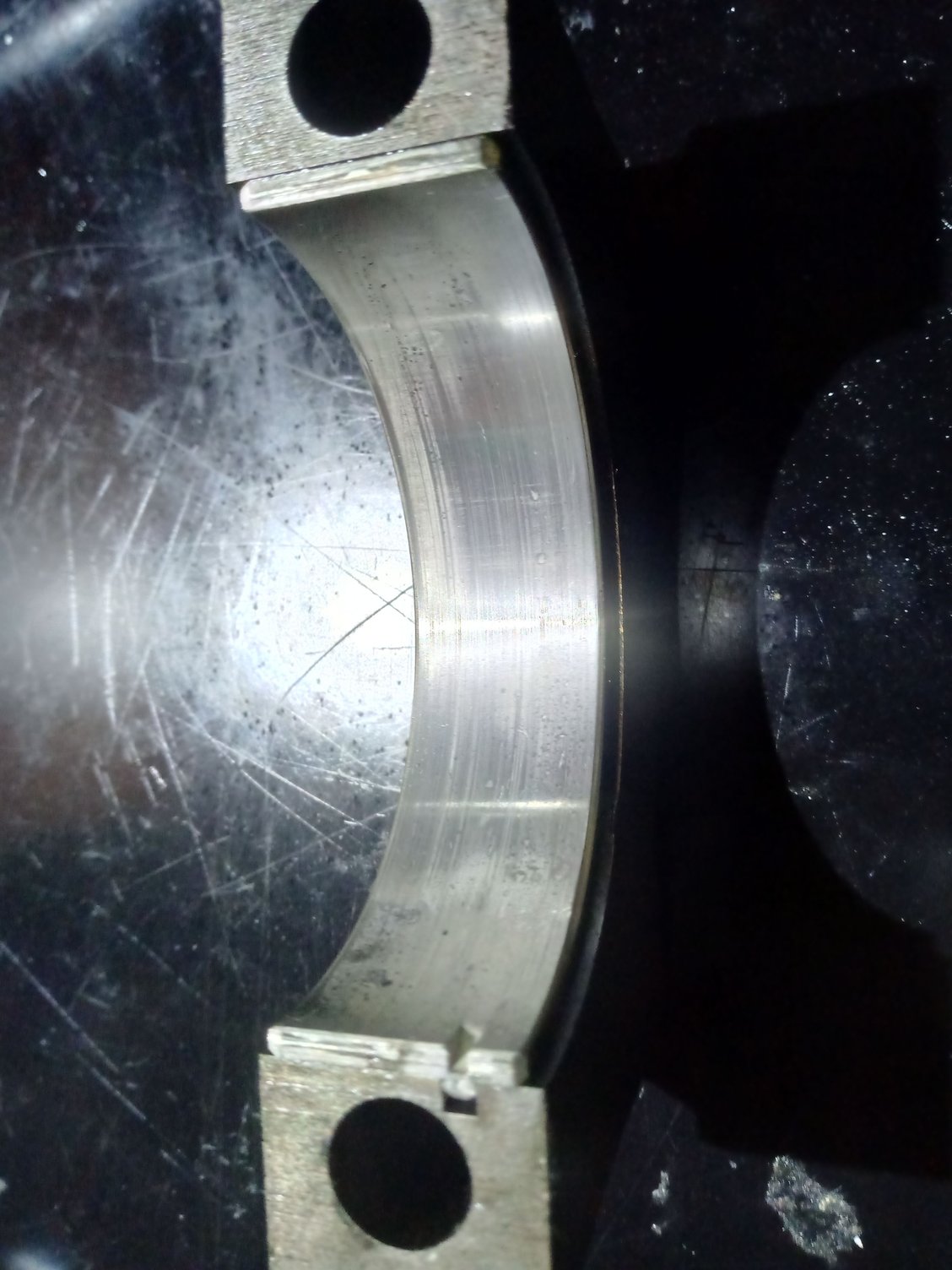

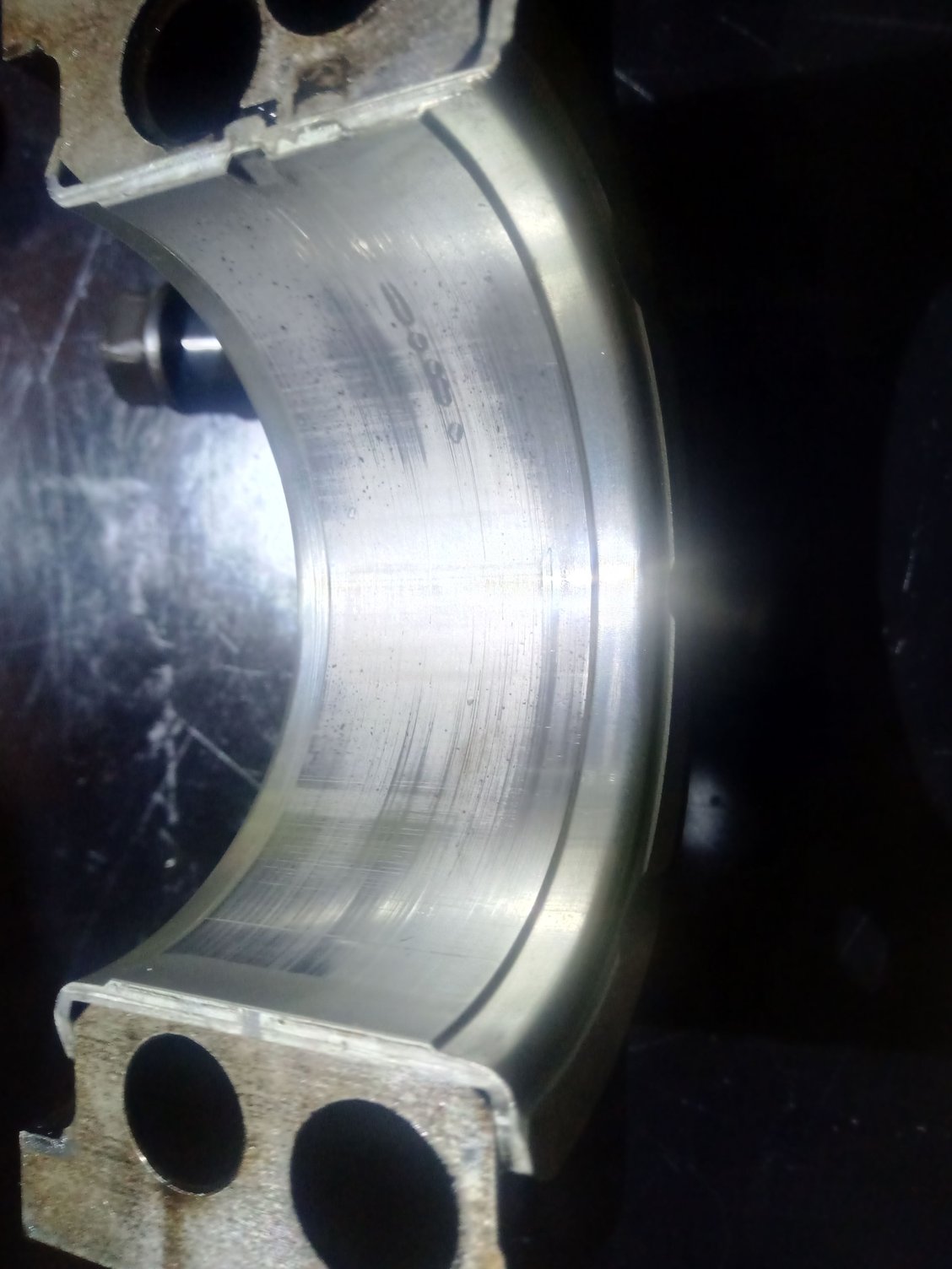

Since a few months, i recognized some knocking/tickling noise on my 305, 88 Camaro. First thougt was that noise comming from the hydr. roller lifters. After adjusting them, i feel that this noise is comming out of the lower part of the block/oilpan. Yesterday i pulled the front axle down to get the oilpan down freely. First i checked the oilpump, but that looks fine. No wearings and no noise when spinning the pump. Then i pulled down the bearing half's of the crankshaft. And here are the results:
Nr. 2
Nr. 3/1
Nr. 1
Nr. 3/2
Nr. 4
Nr. 5
And now? New bearings or new engine?
Thanks for your advice

I'd be looking at the rods and flex plate.

I agree, those look nice. A cracked flex plate will mimic crank noise.

Same here. I'm not seeing knocking noises there. A couple of them have a little debris damage, but nothing particularly severe.

As the others have mentioned, those bearings look ok. However, that 3rd picture down looks sub optimal. Is that an optical illusion or are there grooves in that bearing? Can your fingernail catch on any of them?
Unfortunately yes, you can feel them😕

Not good but wouldn't cause knocking.

Main bearings don't cause noise until they fail and seize the engine. Rod bearings however can cause noise. As long as there's no damage to the crank, put those mains back in and check all the rod bearings. For a street engine, they're fine.

I've seen worse crank bearings, also I agree with others the 3rd looks not great.
