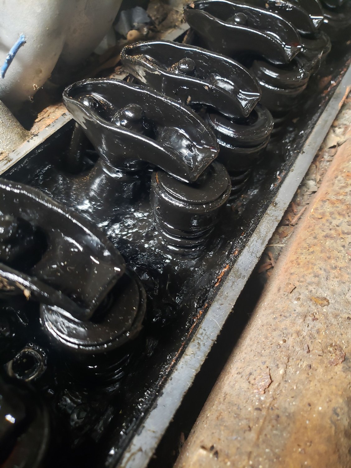

Appreciate the tip. Everything spun freely. I pulled the driver side valve cover just to make sure everything looked OK. Glad I did before firing because there is too much sludge for anyone's liking. I have never seen anything like it.
motor is now pulled and being tore down.

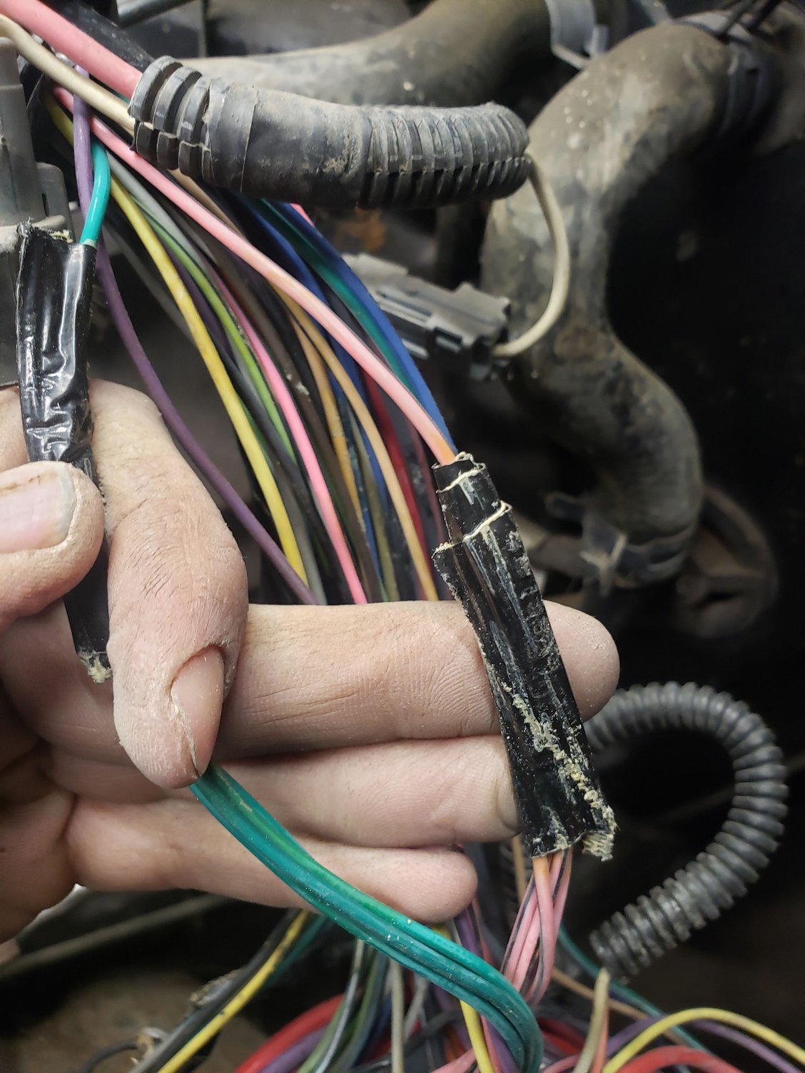

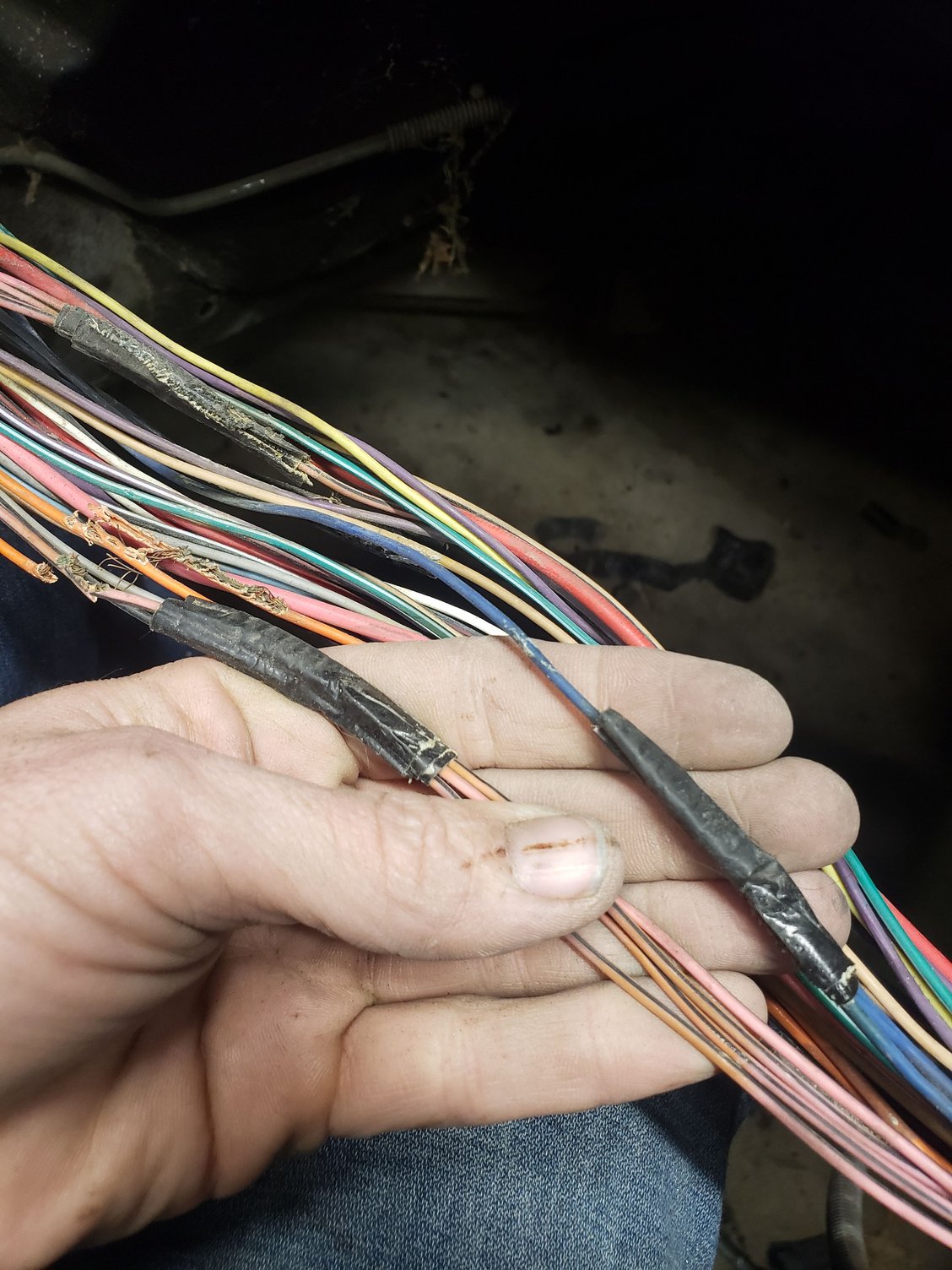

These are the injector wires for each side. I would think they need to be separated for each injector. How does this know when to fire?
Reason I am even looking is because a couple of the injector wires have been chewed thru.

The AIR pipes on the manifold aren't part of the EGR system. That's smog pump air injection. Only used for the older catalysts that need their injection. Modern 3 way cats don't.
The injection system on these cars is bank fired and the computer fires all injectors at the same time. The ECU does not know or care which cylinder is firing and it does not time injection events for intake valve opening - it does not have enough information to do this with only the 8 point trigger in the distributor. It adjusts fuel and timing globally and fuel that ends up behind a closed valve just sits there and waits for the valve to open. Not exactly ideal for atomization but such is life with bank injection (as opposed to full sequential injection). None of the factory computers from this era are capable of full sequential.
