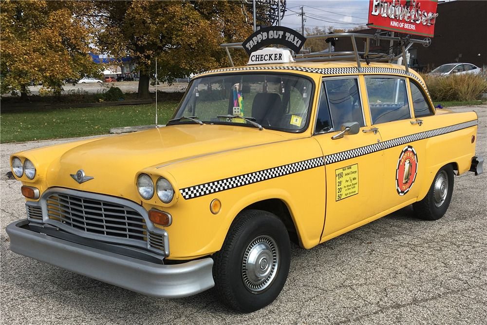

For many years, the solution to The Starter Bolt Hole Problem, one of the otherwise insurmountable "quality control" (GM's 70s mantra: never let your quality get so high that it's out of control) issues in block manufacturing, specifically where the entire starter bolt hole pattern is drilled too far from the crank which makes the starter turn slow and make that horrible grinding noise you can hear from a quarter mile away and EAT ring gear teeth, was a certain starter part #, 4347. That starter appeared in "new" replacement catalogs in the early 70s sometime, when GM realized they had a problem but were too lazy to fix it for about 10 more years: the catalogs listed it for various amusing non-existent applications like 71 Checker Marathon with 396 and Powerglide, but of course you could use it on any motor that had the extra bolt hole in the early-model location. I have a 74 car with a 454 sitting in my driveway that had that problem SO BAD when I got it, that a 3510 (staggered pattern aluminum nosepiece Turbo 350 etc.) or 3560 (staggered pattern cast-iron nosepiece for Turbo 400 trucks and such) couldn't reliably start it, no matter what. I think that's why I got the car (Caprice convertible) so cheeeeep: it wouldn't start at the dealer lot without a boost, even with a new battery. It had a 3510 in it at the time. When I got it home I put a 3560 and a REALLY POWERFUL battery in it, and the starter nosepiece broke the first time I turned the key. The starter literally BROKE OFF and it fell DOWN TO THE GROUND. I put a 4347 on it, with the correct bolts (one long and one short), and that starter remains on it to this day, coming up on 40 years later. As time has gone by, most of the blocks that had that Problem the worst, have been scrapped, and therefore disappeared forever from the face of the Earth, fortunately. People get sick of motors that won't start and eventually even if it was drilled for 4-bolt main caps and had the "010 020" mark on it they realize it's a POS and they get rid of it.

To be honest I didn't read the multiple paragraphs from your last post, so not sure how a checker cab got brought into this.

The Checker cab got brought up because it's related to a 2-bolt-inline starter that fits the 14" ring gear diameter. Different from the 2-bolt-inline starter that fits the 12.8" ring gear diameter.

You said if it had a straight bolt pattern it would fit. You were WRONG because there's at least one starter (the 4347, listed as a replacement for oddballs like the Checker example) that WON'T fit because it's for a 14" wheel, not 12.8". The proof is that there is ONE ON MY CAR sitting in my driveway right this minute.
